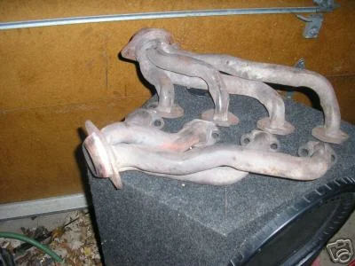

Quote:
Originally Posted by 89s rule
Wow been awhile since I have seen a stock 5.0 engine! looking good thanks for the updates!
That "stock" 5.0 isn't so much,
It has a fairly healthy cam, 69 351 heads (1.94 intake 1.54 exhaust) that have been ported/polished, 3 angle valve job, stainless swirled undercut valves and 1.7 roller tip rockers.
As soon as I get a good deal on an intake and bigger injectors it is going to be stouter

Quote:
I guess the intake and manifolds threw me. Sounds like a decent budget build. I was running 30lb inj. on my old mustang I told you about b/f. Just remember the more you mod and v8 the lower dependability you will have. Looking good!
Ho wmuch are you wanting to spend on the intake set-up? I have a buddy with a stang he might be parting out. I dont remmeber what set-up he had, it was nice, not my gt-40 tubular, but nice!

As little as possible It is a budget build. But shoudl be reasonably reliable as well.
I was planning on only runing 24 lb injectors. As it is I am basically maxed out on the 19 lbers that I have.
Let me know if he is parting out. I still need a computer and O2 sensor wiring harness.
And the stock manifold has been ported and polished as well.
