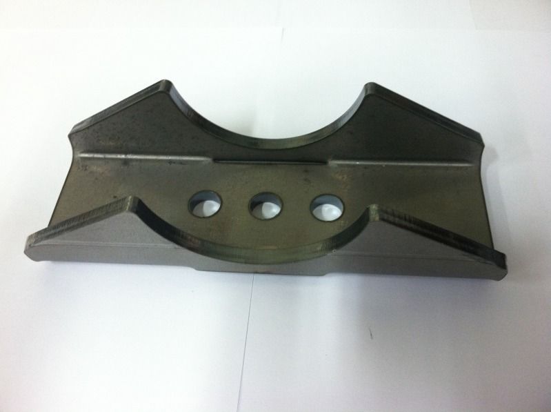

i saw these perches on pirate.
Synergy Suspension Leaf Spring Accessories - Pirate4x4.Com
i have an extra pair of ruff stuff perches im going to mod similarly and see what i gain(or lose, i guess). i think this is a good place to start with some added benefits.

i worked on an extra pair of perches and its a decent gain/loss in height for minimal effort.
with the perches in it only came down an inch or so, but it helps dramatically:
The panhard and drag link are perfectly flat at "ride height" with almost 5.5" until full bump. ill be happy with 5" of uptravel, but im keeping my eye out for a good set of used 2.0 bumps.

Did your center pin sit in the perch nice? I found that you need 3/8'' from perch to axle tube so the center pin isnt rocking on the axle tube. If the center pin is sitting lower than the perch it can dimple the tube slightly when tightened. You did a nice job modifying those perches.
By the way you have a fine looking Cruiser! It looks like you trimmed the fenders slightly. Maybe trim the fenders closer to the wheel well in the back, and french the hangers for the leafs for less lift.
These are on Pirate. They give you 7'' of contact surface for axle wrap and total 3/8'' lift.
