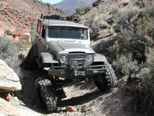

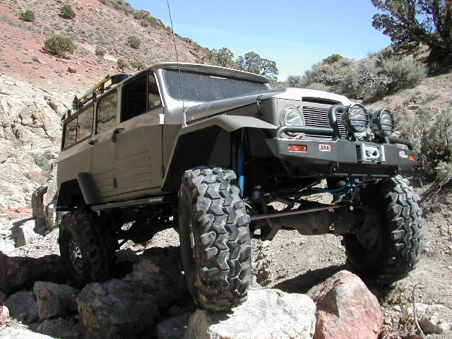

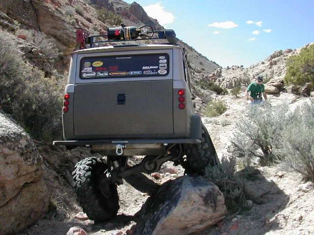

I have a friend with a 45 wagon that runs mog axles and bags. here are a few pic's.

Quote:
That looks like one well done rig! Clean and cabable.
