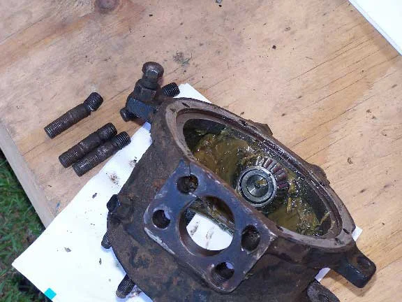

Mark's (Helocat) pic of Woody's carnage:
this thread needed a pic
