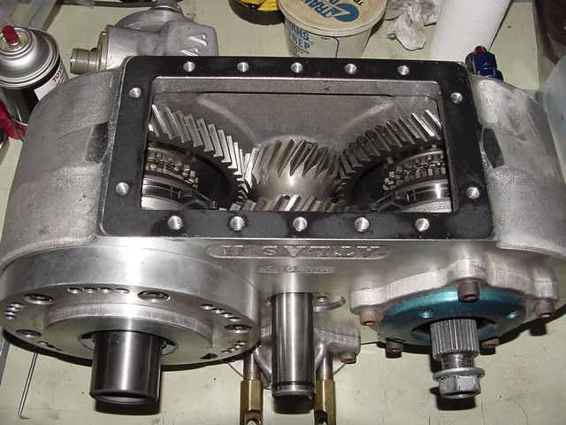

next i started to mount my york compressor. i bought a bracket from kilby enterprises www.onboardair.com that allows you to moun the york in the stock aluminum bracket for the round style gm compressor. fits perfect!

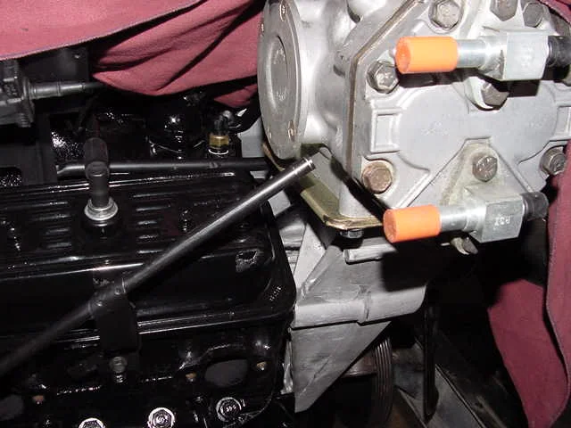

the only minor problem with the york so far is that it ends up "intercepting" the stock engione oil dip stick.

i pulled off the dip stick tube, grabbed the tubing bender and it works again. if you bend the tube at too much of an angle, the dip stick will bind up.

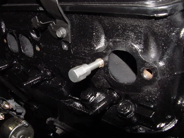

i also installed the studs for the exhaust manifolds as can be seen in the pic above, but first i ran a "thread chaser" (similar to a tap) thru every exhaust post bolt hole just to make sure i was'nt going to have any problems with a bad or plugged thread. also, it's important to remove any excess paint from the exhaust manifold mounting surface otherwise you end up with leaks, so i did that right before installing the bolts.
here's a pic of a thread chaser:

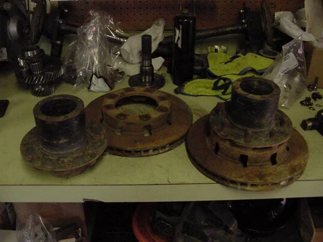

the only other thing i got done before cleaning up my tools and calling it a night was to knock all the studs out of the front spindles/rotors.

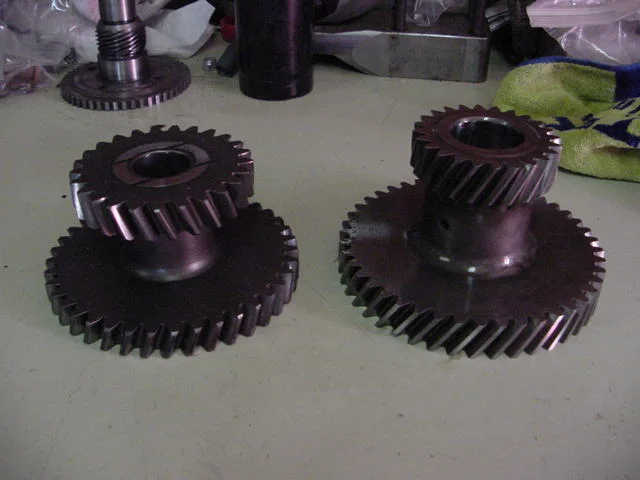

when i was cleaning up the workbench i found a cruiser t-case idler ger so here's a pic of it and it's atlas counterpart( on the right):

I like that bracket for the OBA setup...tho I've used the stock Harrison pancake for years with no problems
are you running serps, and how does their kit deal with that?? How is the height of the compressor relative to the hood?

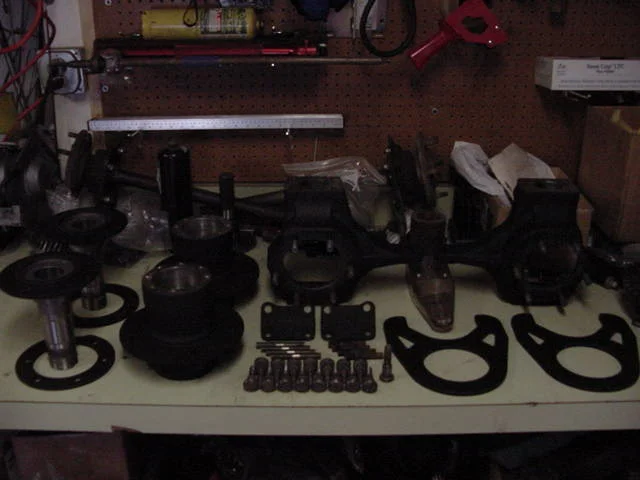

today, sunday, i wanted to prepp everything for the front end so when i get the housing back from my buddy rodney, i'll be ready to go on with the assmebly of the "outers". rodney is setting up the 4:56 gears and power lock limited slip for me over the weekend. since i've only done a handful of differential gear setups and he has done literally hundrets, i figured i'd call in a favor and have him do it for me.
i finally got to use the bead blaster and it works awesome. problem is, the air compressor has a reallly hard time keeping up. i'll just live with it since i don't do that much beadblasting. a new compressor would take away some of the "pocket money' i have set aside for this project so it's gonna have to wait.
i got all the parts cleaned up, bearings and races knocked put, grease wiped out, threads chased, blasted and painted. i also wire wheeled the wheel studs and cleaned up the threads on them. last thing i want is to run into a bad thread or other preventable trouble during assembly.
that took pretty much all day, including cleaning up the mess i made.
here's an after pic:

i'm going to order a serpentine pulley from kilby for the york. i'll be able to run a single belt and the compressor lines up perfect. i had to lay it down or it would have hit the hood, but now it should be cool.
