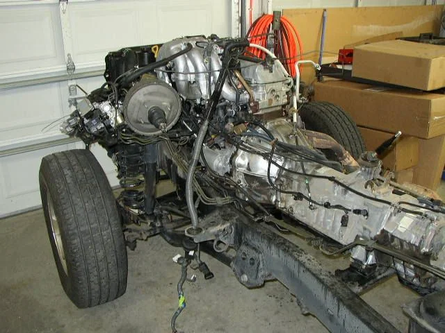

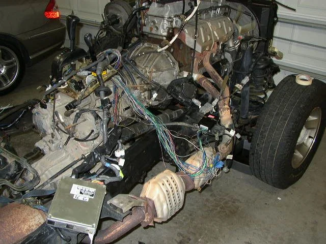

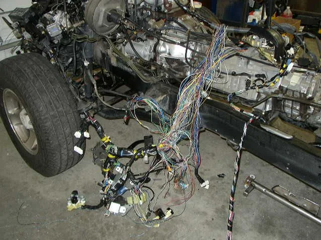

I have finally started my new project mating a really nice 96 80 series chassis, complete, to my old, pretty good shape 65 FJ45 LWB pickup. Like my FJ62, I will be taking my time and trying to do it right and will post play by play pictures as I get somewhere. I started with a cream puff of a 96, locked FZJ80 and dissasembled it down to the chassis, which is all stock and completely intact. It still has all the fluids , including antifreeze, brakes and fuel. It fact it will start as it is. I plan on using every mecanical piece of the 80, under my pickup modified somewhat of course. I am at a loss on what to call this thing in Toyota terms though. I was thinking about FZJ845?
1st shot the day after I got going on the dissasembly. The next couple of shot are today, 1 week later.

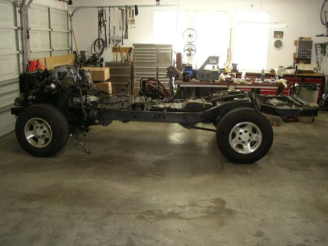

I think you should weigh it like it is to see your starting point.

I am doing just that.

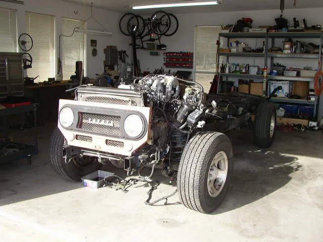

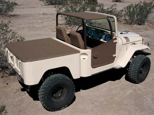

I am going for more of a trick traill rig. No over hangs front or rear, but I still want it to look like a 45 pickup not a buggy. Like I said earlier, I want to keep the chassis completely stock, emissions legal, but the suspension will have allot of Slees goodies + a 3 link front system to help with front articulation. Buy my initial measurements, it looks like the cab will fit with new body mounts, the bed will have to be cut down to 5 ft., which will be still long, but not over hanging the rear. I will channel the body, bed included to fit the 80 frame so as to look like it was supposed to instead of the El Camino on a Blazer chassis look. I will be running a big tire, exact size is undetermined, but I worked a deal on a Marks Crawl box for the 80 t-case today, so I am really happy about that. Not sure on gears yet, but loading the axles with some new cool stuff Christo is working on. I am bad about taking pics of every mod so I will keep them to a min. Just the good stuff. Heres a pic, posted many times before, of the look I am going for.

Here you go Woody. This will have to hold you over until I get back next week from working a boatshow.
