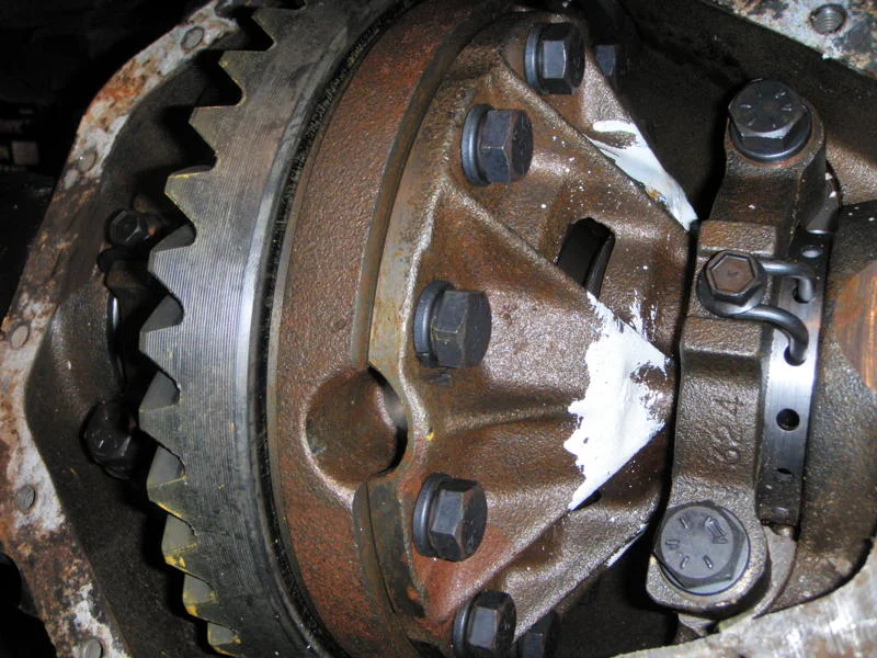

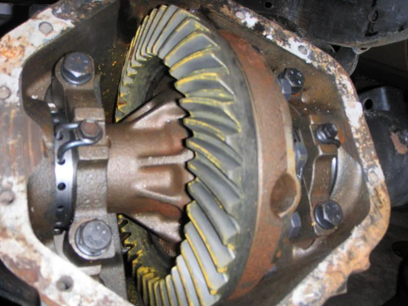

Please see picture #2 - is this a open/4 cross pin carrier - or a Gov Lok (2 cross pin) carrier???
Have been on the hunt for a 14 bolt and found one advertised as a new crate axle with disc brakes, 4.56 and a Detroit. Seller isn't 100% sure if it's a Detroit or a Gov Lok. I've found most folks don't know - and oftentimes call a Gov Lok a Detroit.
In the pictures sent I can't tell if this is a 3 or 4 pin carrier - any other tell tale factors that might enable someone to id this as a stock carrier, hence if locked - would be a Detroit - or is it a Gov Lok carrier???
If it's a Detroit - it's a fair deal. If not, I could rebuild one myself for the same price.
Would it be ok to run the Gov Lok until it failed??? 39" Red Labels - geared around 120:1, SOA, etc.

Locking at the picture blown up - counting 3 carrier bolts up I can see what appears to be the rounded top of the next opening for the carrier pin - which leds me to think that with 12 bolts this would be a 4 pin open (which can hold the Detroit). Anybody?

Aw shucks - bought it anyways. 99% certain it is an open carrier = good.

dorry I missed this amigo..
It's a open carrier
Gov lock has a LOT more parts visible.

No worries - thanks for confirmation - was 99% certain - just didn't want a Gov Lock carrier.
Halfway there - now to pick it up, shorten it, shave it and figure out the hub mods (machine show labor cost versus a set of conversion hubs).

That looks kinda like a gov lock to me....hard to tell by the pics tho. On the non-tooth side of the ring gear there will be a couple of round holes that have a clutch lining looking thing in them...thats a gov lock, and its hard to see the mechanisms until you open the diff. That and counting the number of cros pin holes is the only way to know for sure.

That's an open carrier. We offer spools, detroits, arb, etc. and gearing down to 5.38. plenty of options for the 14 bolt.

Thanks - has a new Detroit in it with new gears... Only reason I was double checking is due to fact that many folks advertise gov lock carriers as Detroits - and don't know the difference.
