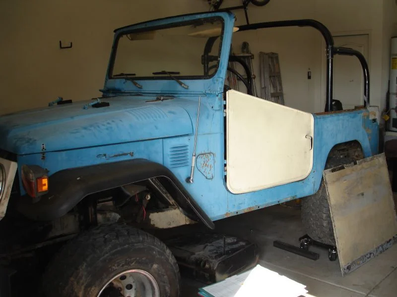

Chicago builds a 40
Alright lady's and gentlemen....
Im Chicago (Keith), and Im a CRUSIER'holic! I live in Reno, NV.
My addiction started with an 88 FJ62. I built it myself and over the past 4 years have come to feel that its just TOO BIG and TOO HEAVY of a rig for the trail that I like to do most.

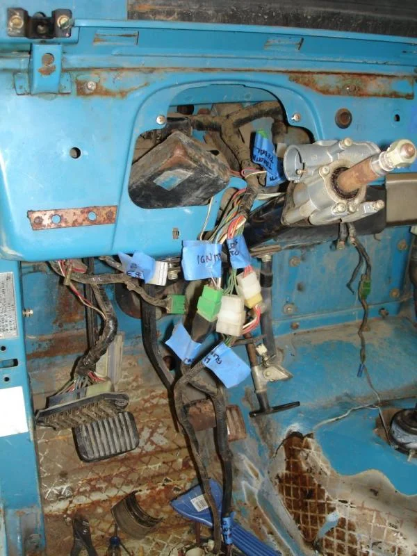

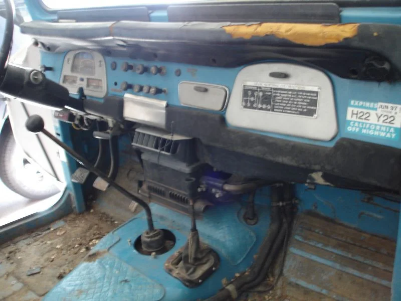

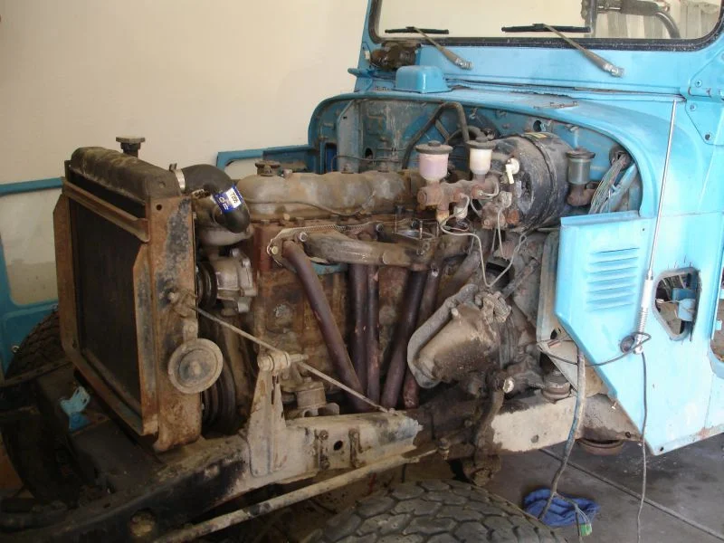

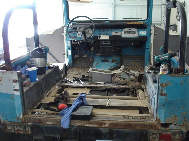

So here is the "NEW" build.
A Bruised and mechanically HACKED 76 FJ40
The plans are:
01, 5.3L vortec (49K)
02 4L60 E trans
NP203 to 19 spline dual case
Frame off and rattle can paint
SOA/' WB stretch
62 springs/ axels
Iron pig cage
35's or poss. 37
PS install (of course)
Poss. RDB conv.
and a general overall FRESHENING UP of the rig.
This will most likely take a while as there is still LOTS of money to spend and preliminary work to do.
I got the rig pretty cheap, and its a MESS!
there must be a YARD of dirt and debris within the tub and frame rails.
Im already cursing the PO from some of the crap that has been done to this rig. Every little bit has been a surprise.
Please feel free to chime in with questions, concerns, suggestions or obscenities as all are welcome.

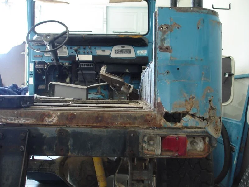

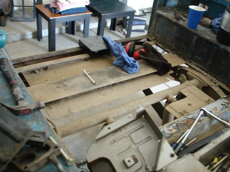

Started the dis assembling the rig. Got the rear cargo floor out (diamond plate riveted in) pulled the seats, pulled the front clip in efforts to free the motor...just general dis assembly at this point.
Here are some pics.
Thanks,
Chicago

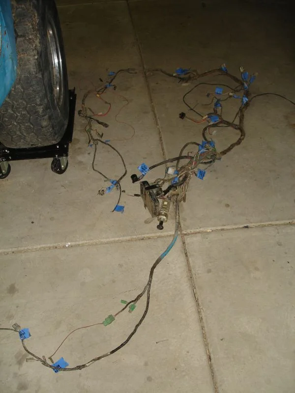

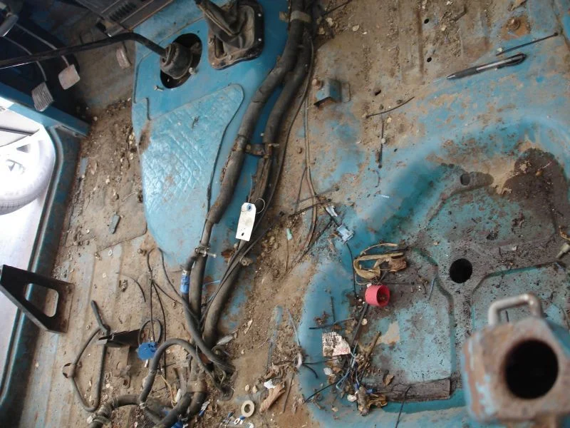

More pics...
What a MESS!

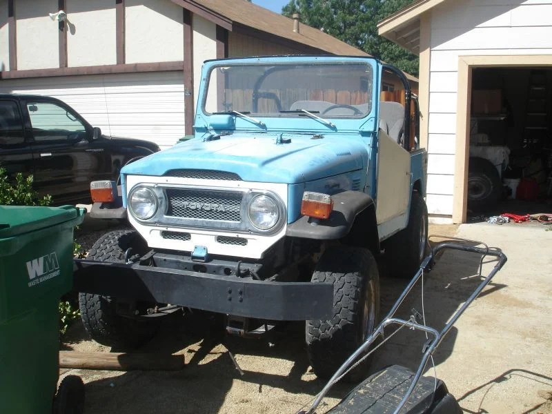

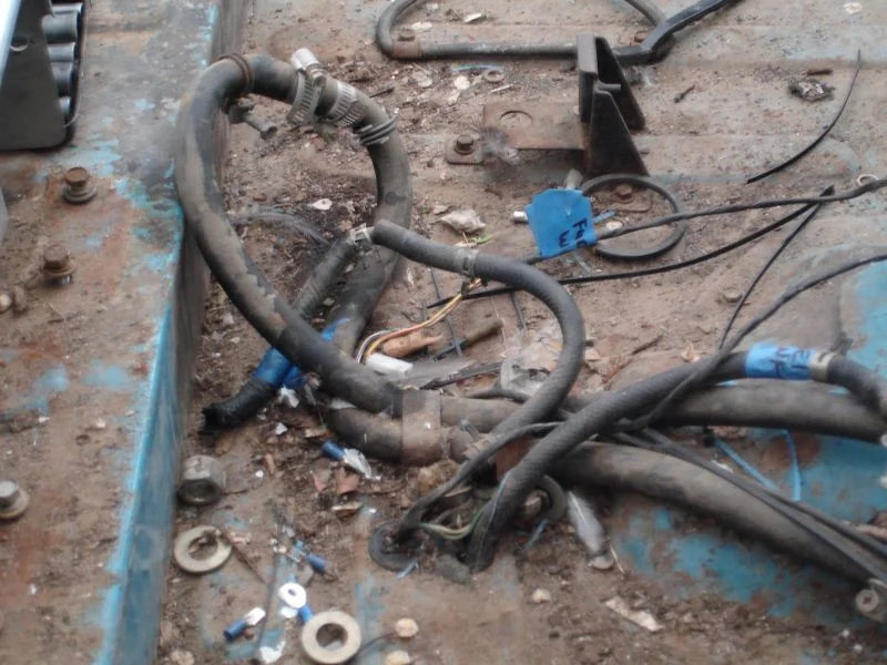

Some more.
BTW, this is my first 40, so...I basically know nothing about em. So any wisdom to impart that may make things go easier...
FEEL FREE!

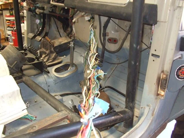

BTW, does anyone know what can be eliminated from the factory wiring harness? Im kinda tracing down the wiring so I can get a good idea of what goes to what, and Id sure like to get rid of some shit if I could to make it cleaner.

PM D'Animal. He recently spent some time deep in wiring harness and can probably save you some headache.

I can assist you with the wiring.
I eliminated about 80' of it from my harness when I got rid of all the emission control items and a few other things. I bought the harness connectors from Summit Racing for all of my waterproof electrical connectors. It is called the Weather Pack Starter Kit # SUM-900403
The Haynes manual is the most helpful of any of them. This is going to sound sill but look at the manual and see what harness you have before you start cutting. My 1976 federal had a 1977 harness in it. You will spend a lot of time looking for the RL wires (1976) when they are really LR (1977).

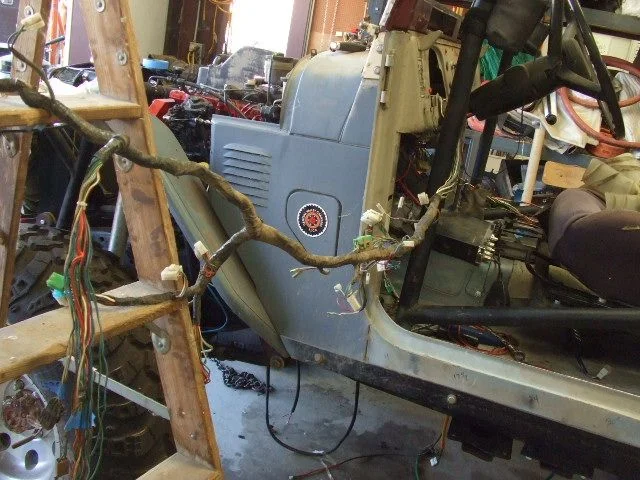

Right now ive been pulling the factory harness, which I believe would make for some boring photos. Every little bit is like christmas though...I never know what Im gonna get.
There are a few rogue plugs that are homeless...not sure what they are or where they go. Ive been labeling everything that I D/C. Ill pull the whole thing out, and most likely try and trace each wire out to see where it goes and what it does and can hopefully eliminate much of it. Im not too sure what Ill need of the old harness. Im assuming the inst. gauge wires, lights, blinkers and such. Im considering the Summit fuse block that d'animal recommended to sort of re build the factory harness, however, Ill need to research that further.
If anyone has any info on this, please post up. This is the crap that worries me the most.

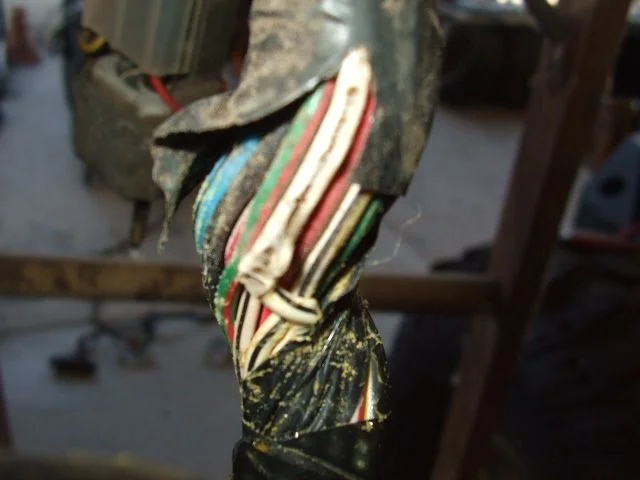

Use ladders. No really, you can lay everything out and easily remove and strip the old tape off. Be she to check the white wire with the black strip for "Hot Spots". It is the ground.
Use 3M Super 88 or Super 35 electrical tape when putting it back together.
Or do what Mace recommended and replace the harness.
Thanks,
Chicago
The Summit # I posted was for the waterproof connector kit. It has 1 plug, 2 plug, 3 plug and 4 plug connectors and all of the hardware.
Land Cruiser Garage Sale Items <- Link
Get Your Marlin ToyBoxes Now!
Beagle Chariot
1962 FJ40
1964 FJ 40
1968 FJ 40 <- For Sale
FJ 40.5 Build 4BT Cummins Conversion
1976 FJ 40
SPEN Trailer
D'Animal is online now   Reply With Quote
Old 08-22-09, 09:56 AM   #27 (permalink)
Forum Lifer
chicago's Avatar
Join Date: Jan 2006
Location: Reno, Nevada
TLCA# 16202
Posts: 4,485
Thanks gents!
A ladder....that is actually a great idea d'animal. I got the harness completely pulled last night. Labeled everything that was connected.
Mace, Ill check out that ezwiring.com. Rusty TLC said that if he had the time hed redo the factory harness too. 30+ years of exposure and vibration.
After getting it all out, it doesnt LOOK to be all that intimidating. Seems that it'd just be more time consuming than anything.
I still have yet to decide on the Vortec harness and wether or not I want to do it myself, or get one re worked, or gram one from howell. Since Im not a skilled electritian...Im leery about doing it myself, but I do have a friend close by who is an electrical engineer that may be able to help me with the task....
BTW, I measured the stock 40 gear that is in the rig, last noc...it is actually LONGER (53 in) than the 48 in of the vortec set up? Im only missing the 203 to 1 sp adapter to add to that measurement. Ill have to double check that, but...
Here are some pics of whats been done.
I appreciate the help anywhere I can get it. Ive never done this extensive of a job before, so Im a bit nervous to say the least, but Im having a blast already.
wiring harness
front clip off
wiring harness out
