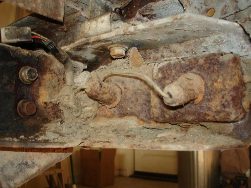

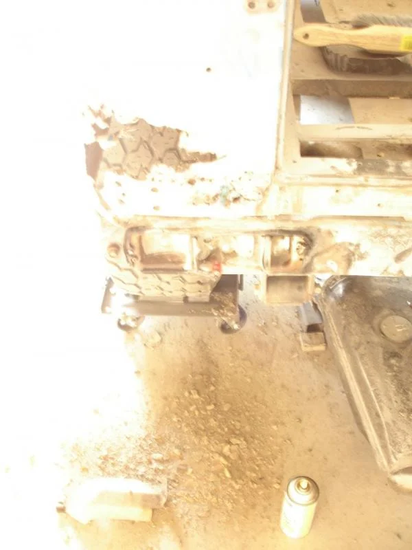

Then I directed my attention to the rear of the rig and the bolts at the END of the tub...UGH!
2LBS of dirt SOCKED in to each of the rear blinker sockets...
HOLY CRAP! When I build, I take GREAT CARE in making sure things are as CLEAN AS POSSIBLE, to the point that Im OCD. I do this, so later on down the road they DONT end up like this.... I realize that the 2nd pic is washed out, but you can see all the CRAP that had accumulated back there on the floor.

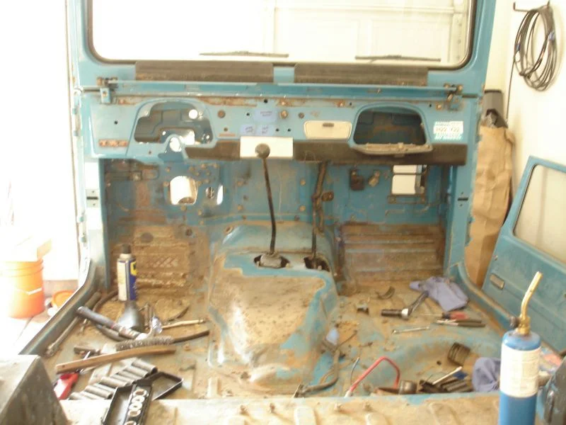

Here is a shot of the dash with everything cleared out...
Kind cool. I like these before shots to see the progress later on down the road.

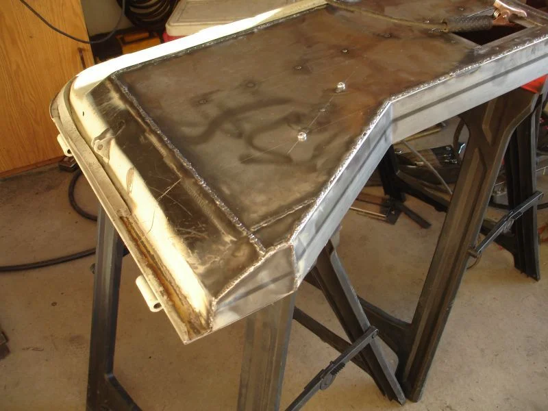

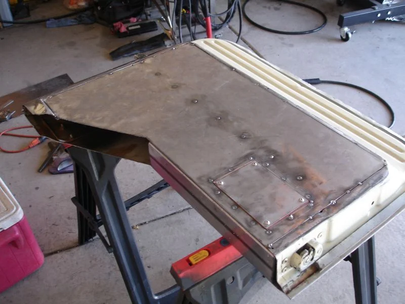

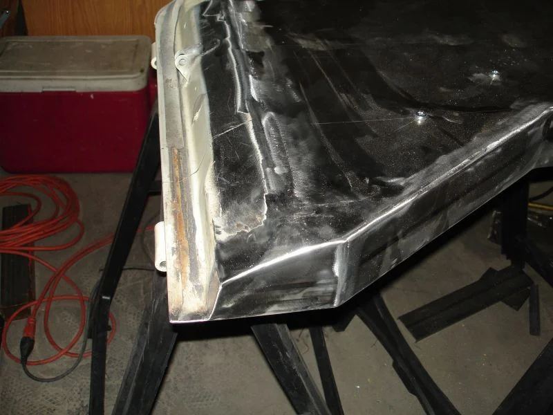

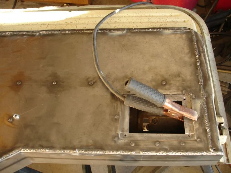

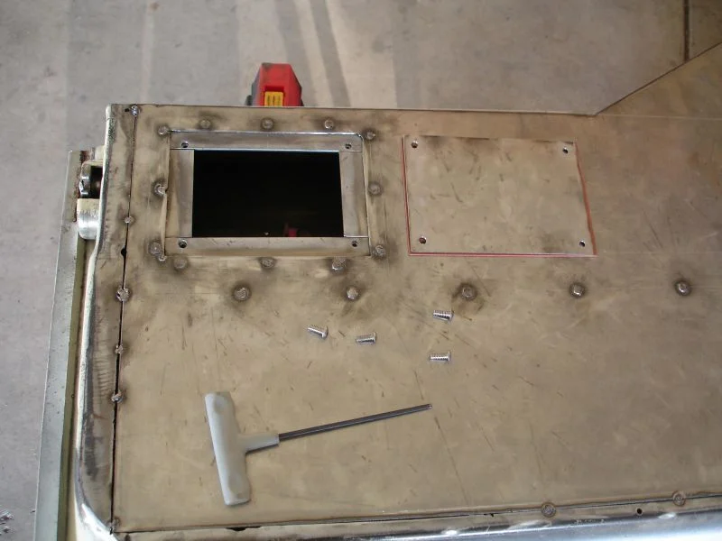

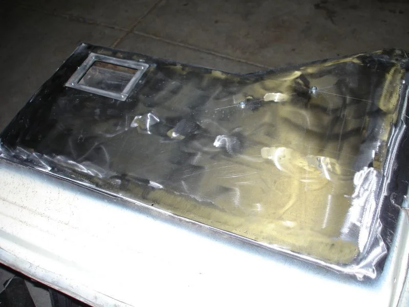

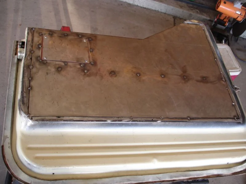

Then, a friend here locally asked me to chop a set of doors for him in the beginning of summer...I spent a lot of time STARING at them thinking about the best approach to do it how he wanted them. So Ive been spending most of my spare garage time doing those. So, since they are 40 doors, Ill post up the progress pics on those.
Thick doors
chopped
internal panel removed and re skinned with 18g
Gusseted for stability in the middle (youll see the plug welds)
NO interior latch handle (he didnt want it)
Pull handle
Had to make an access panel for the latch
I capped with 1x3 square stock (not sure of the gauge)
BTW, Im not a big fan of body work. Im not very good at it, it takes me a LOOOOONG time to make it "right". Just havent found a really good technique for welding that thin ga stuff. Im using my 220v Hobart 176 which is a bit too hot even on the lowest setting to be really productive.

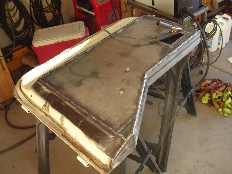

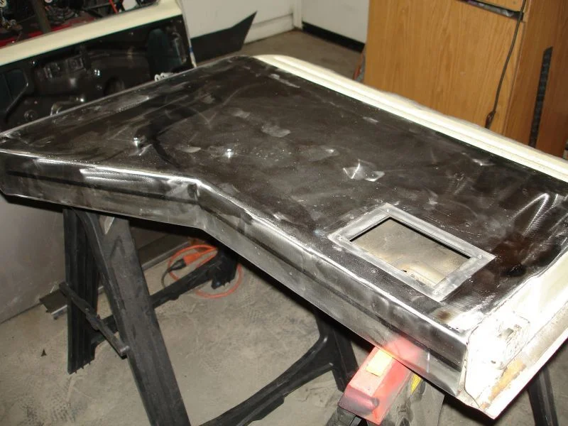

Here's a few more with MOST all the welds done on the BIG side. Still have to weld in the ends that will require some fancy capping. He wants the AFT end of the door to be somewhat beveled/ rounded so its not dangerous. IIRC, RustyTLC had the same request when I did his as well.

That re skin of solid sheet metal looks better than I thought it would. I thought it might look too plain, but it turned out pretty good. I might do the same with mine. It was EASY to do as well. He is gonna have it professionally prepped and painted to cover my hack work.
Since Ill be very busy the next few weeks...45 run, Granny Hansen from Chicago is coming in to town...Ill keep this thread alive with odds and ends that have been happening.

Those doors look awesome. I will definitely be referring back to this thread when I go to do mine sometime in the far future.

.023 welding wire?
If not, get some and you will be much happier with welding sheetmetal

HMMMM...no, Ive been running the .030 Lincoln flux core wire.
Might have to buy a lil spool of that .023 for the other door.
Thanks for the tip Mace!

Oh yeah...here are a few pics of how the door finished out after grinding.
Some low spots that'll need a bit of putty, but over all I was happy.
