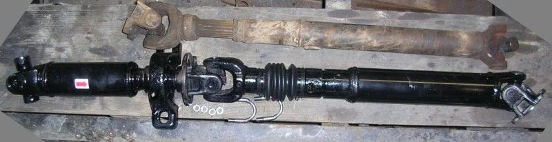

I have Jess shafts
Front is here, and damn....talk about beef. 2-piece front, 1350 at the D300, minitruck for both front joints. VERY nice, and more beef than I expected...
Rear is still being measured, but will be a minitruck CV at the case and minitruck or Cruiser at the rear pinion.
The front shaft from Jess is a monster compared to the Woods shaft I had made 5-6 years back....

got a pic of that thing for us Nolen??
just popped one of my new one.....front 2-piece HighAngle next to my 6 year old Woods shaft....
The Woods shaft served me well for many years, and will be revised for a spare for future use....it uses minitruck pattern flanges with 1310 joints....11" stroke....but never came booted or protected, and the diameter difference is obvious.
The Jess stuff is just plain beef.....

Quote:
