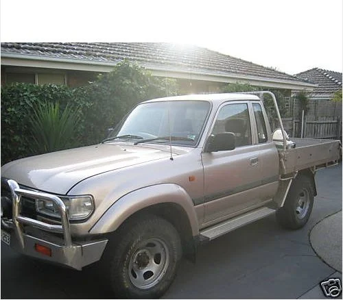

Here's what I did to my Big question for you is do you wanna keep the back open or enclose it? You could keep the rear top, after you cut it off, & reuse it as a camper top. I like the way Gumby bobbed his & the 1st photochop similar to his

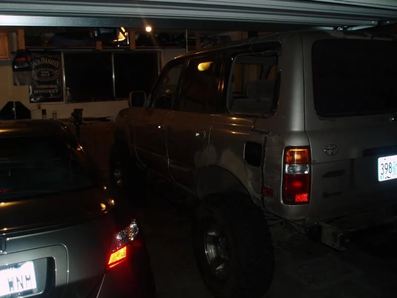

theside00 is offline   Reply With Quote

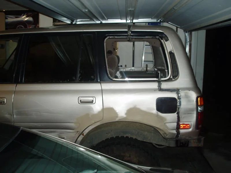

been working on it for a few days here and there. Got it all cut up and the passenger side is welded back together. Still lots of work left but thought I would give an update.
Im using a work computer since mine is still broke and cant upload pictures. I can email them to somebody if they could post them.

I did 7 inches i think the max you can really go without major work is 8 inches. I left enough room in the back so a 37" tire will lay down.

All the welding is done. Putting the interior back together the goal is to try and make it stock looking. I have lots of body work and painting to do.
Anybody know the color code of the beige landcruiser color?

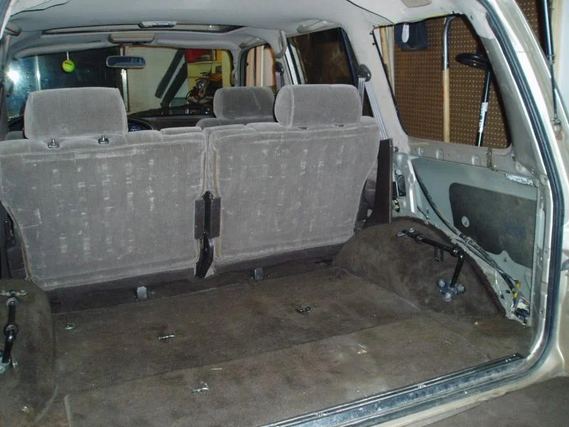

Here are some pictures. Im going to cut the plastic sides to fit in the slots.

Windows are in getting cut down, wish they werent aluminum frames otherwise I would have done it.

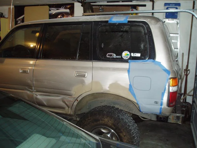

Just got all the body work done going to spray the same color paint over and hope it matches it up. Ill take some full shots outside when I get it all done.
Got the windows shortened and put in looks close to stock which is what I was going for.

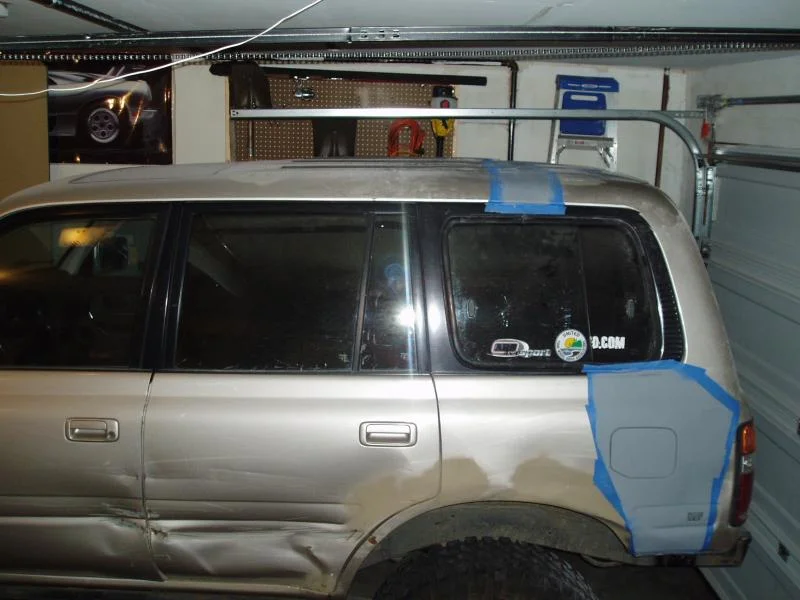

Here are a few pics of the windows in. They came out pretty nice and there is about 4 inches left to open the window. Enough to get air in the back.

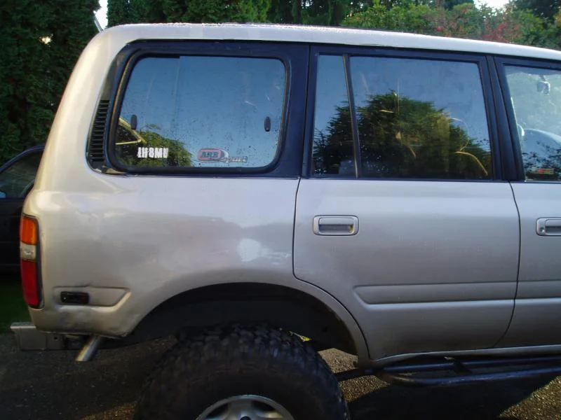

got the primer on there it is getting close. I will spray some paint on there sometime this week hopefully, then it will be to the mountains to see how it does.

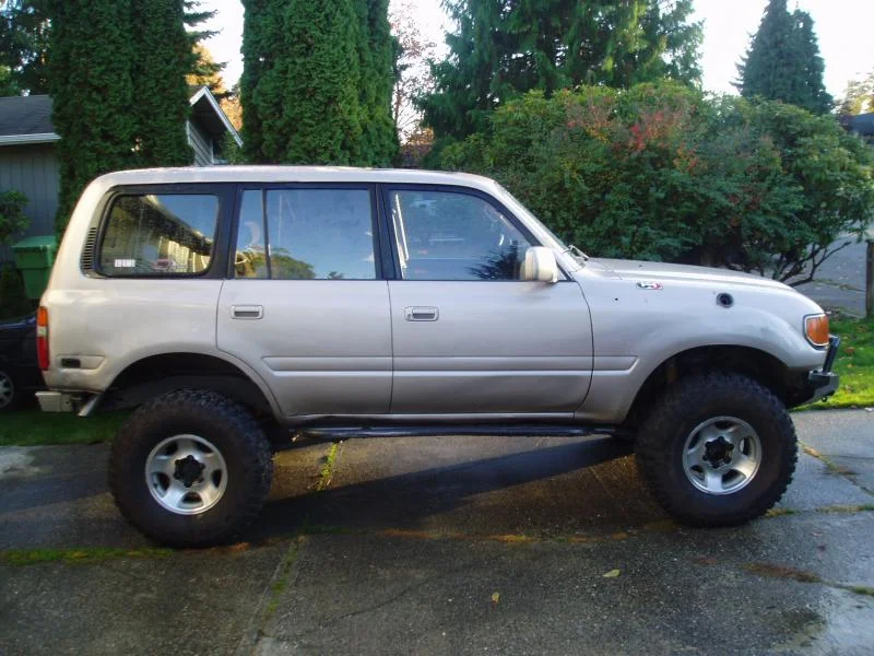

All finished for the most part just need to take care of the frame in the back. Paint is all done, interior is all back together. Real happy with how stock looking it is. Its a short guy now.

That looks amazing!
