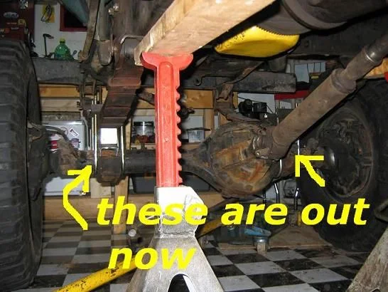

He sent me this. Looks good to me.....

woody is offline   Reply With Quote

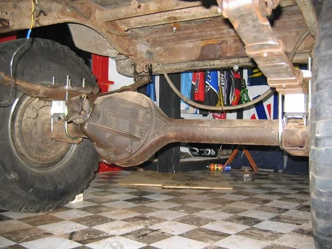

thanks guys i love this site ....needless to say if this sight wasnt here ,,id prolly be dead

this is the front ...the blocks were out assoon as i read the messages thanks

A properly designed trac bar need only be a single in the middle.
Shoot me a picture of the front knuckles from the side. It looks like the pinion is pointing up but I fear that the Prior Owner just rotated the housing and did not keep the knuckles at the correct caster.

they were i corrected that already and i got it leveled ...only it wasnt the prior owner,,,,dont laugh, it was me as i rotated it and tightened every thing up i realized what i did and i just leveled it back out today and took the blockes out..

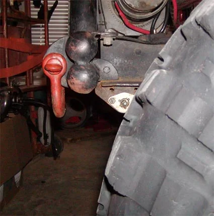

now that i have the blocks out the driveshaft is still binding should i look into a cv joint because i also need to extend my driveshafts anyway...or do i?

Remove the drivers side front tire and take a side shot for us....make sure we can see the pinion angle and the knuckles

I suspect your frount shaft is binding at the t-case. you can call Jess @highangle driveline. he makes a u-joint for exactly that.

OK, I have a spring over and a shackle reversal. My front springs are flat. That nets about 5" of total lift. No fenders and I run 42s with a flat spring spring-over.
Since you wont take a picture of your setup, I a simply assuming that you have too much angle and too long of a driveshaft and it bottoms out in the Ujoint cup.
I have a 1310 joint at the bottom of my front axle and a Toyota Ujoint at the top. I have long, long splines and all that keeps it from binding at full droop. No CV.
Quote:
i understand now that the binding will be worse, but there has to be a way around it ...there always is ,,
SHow me what you have and hopefully I and others can help
Quote:
from what ive heard is that its almost pointless to put a shackle reversal on, with out putting on aftermarket springs, well if they put on aftermaket springs then there in the same perdickament that im in.......how do they get around it??? reason for me wanting the shackle reversal is because i will get new springs for it in the future... mine r week.
I think you misunderstand what folks have said. I know a TON of Cruisers with toasted, flat stock springs, shackle reversal and no binding.
The fact that you said you have standard shackle setup and your drivesahft is binding leads us to say, if you do a Shackle Reversal now, you will get worse binding because something up there is bad and the SR will just make it worse.
TAKE SOME PICTURES like Woody described above and we will get you fixed up.
Mine from the side...
