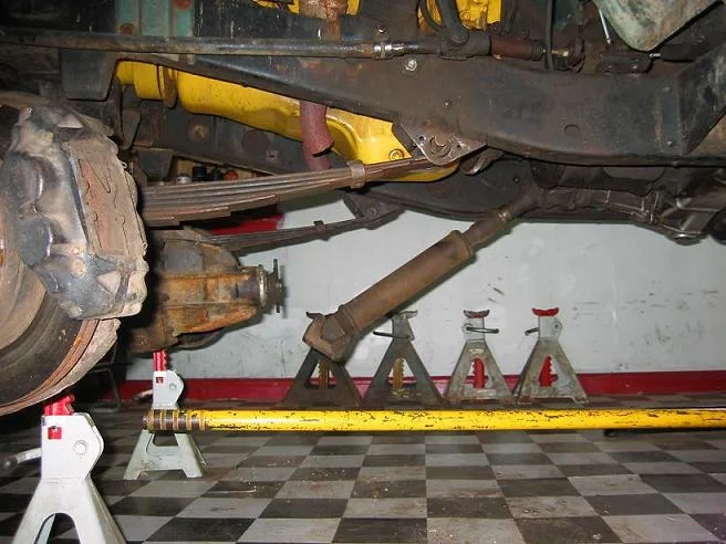

this is a pic of the front end /......i tried to get a good pic of the angles

it looks like full droop might have enough movement at the top, can you grind on the ears and such to get it to work?
exhaust nice and short, LOL.

does anyone know the best thing to do with the driveshaft to make it hook up without binding????HELP!!!!!!!!!!!!

Where is it binding? which ujoint?
Right now i do not see any bind issues visually.
I have no bind issues, no SR, soa, no CV, a auto so driveshaft could be longer.
is the above pic with weight? looks like it.

My best suggestion is to lower that rig some. If you are building a rockcrawler / trail rig, it's too tall and will be top heavy.
If you are building a mud runner or something that doesn't need much flex, then limit the droop so it does not bind and you will be fine.
If you are insistent that you need to be that tall with that short of a front driveline - call Jess at High Angle Driveline and shell out the bones for a high angle driveshaft. That one is not beyond hope of him making something work.
You can also lower the engine (leaving the tranny in place) and improve the front driveline angle, but I have no clue on if that will worsen the rear at the same time to where it just moves the problem.
Bottom line, in my opinion, you have raised it a bunch and maybe too much for the length of the front driveline.
Ed

Cut and turn...

in the pic above the cruiser only has a soa and nothin ealse only 6 or so inches and the driveshaft is binding at the top.....and maybe a lil at the bottom (not sure) the springs are compressed so its sitting as it would if it were on the ground

Do me a favor. Get an angle finder and measure the angle of the tcase flange. It kinda looks like the motor/trans/tcase is mounted with the motor high and the tcase low..

" motor/trans/tcase is mounted with the motor high and the tcase low "
well it is suppose to be 3-5 degrees or so, i do think it is close to that spec. Which
you can play with.
Now i do think the drivetrain is mounted high in the frame rails.
also remember you will settle out about approx 1in or so, after you drive on it.
You have many options at your disposal! all of which have been mentioned i believe
at this point.

You are really making this very confusing and, I think, misunderstanding some basic principles. At one point you state
Quote:
i also set the caster back at 4 deg.
and then later state
Quote:
also if i need to i can cut and turn the axles
If you haven't cut and turned the knuckles relative to the pinion, there is no way to set the caster at +4* without tilting the pinion back. Your pictures don't indicate that

im sorry . i didnt mean caster i just ment the rear of the axle was angled up around 4 deg.

if you angled the pinion up 4 degrees, then the caster is likely at -3 or -4, which will make for NASTY road manners....
you'll want 2-4 degrees positive caster, and about 10-12 at the pinion....

Go to harbor freight and get a magnetic angle finder
Slap it on the pinion flange and that will give you the degrees of the pinion..
