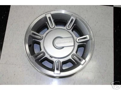

I bought a set of H2 wheels off ebay and am having Champion Wheel do the locks for me. When I get them back I'll post pics. Keep in mind the H2 wheel center hole is smaller than usual and may need to be machined out. http://championwheel.com

Those H2 wheels are sweet but the 80 series uses 6 lugs instead of 8 lugs like the H2 IIRC. I'm sure that John at Stazworks can build Junk any combination of rim diameter, backspace and lug pattern he wants for the cost of another set of the internal inflatable locks.
I still think the internal locks are cool though.

The H1 uses 8 lugs, but I think the H2 might use the Chevy 6 on 5-1/2. which fits Toyota except for the center

Nope, Bothe H1 and H2 are 8 lug, will fit on Chevy 8 lug stuff.. Dana 60's ect..
if your talking about H1 they are stock hummer wheels that are 16.5" with a high offset, like 6 inches or somthing.. some came with Double beadlocks.. these are great to use on full width axles, because they effectivly narrow the overall width..
the H2 wheels are aloy of some sort and are not beadlocks 17" wheels and look cool, Plus they can be picked up cheep on e-bay w/ some BFG AT.. from those big ballers switching to low profiles on 26" Bling

Short of a H2 rim 17" hummer rims are almost unobtanium..
16.5 is the norm..
For the 80 get a set of TR beadlocks and call it good. They are VERY nice.

foxfab, those rims blow. I will dispose of them for you. Hell, I'll even pay shipping.

Because as you get to larger tires the sidewall becomes a problem.
Lots of wheel hop issues were solved when the larger rim sizes started to get popular..
Also, to keep overall width low on big axles you typically have to run a bigger rim to fit over the brakes..

Quote:
Originally Posted by HI^C
Why run a 17" rim?
Because they fit over big breaks and as stated above, some tires only come in 17 inch.
17" rims can be found all over the OEM markets. H2 rims are like an ugly step child, everyone wants to get rid of them. and there are a crap ton of them.
Well if you buy wheels for you rig to be "pretty" then I hope they serve you well in the mall parking lot. Thank God there are a lot of them out there too because they're cheap which lets me spend more money on other things.

37" krawler in a 17, yep. Good to see the highest $$$$ sponser and highest $$$$ in advertising getting some money from other none sponsered rigs.
There are other tires, the whole bandwagon is just not me.
THe weight comment was directed more towards, DBs vs the alloy secondairs, just out of my curiousity. rough guess DB vs a single beadlock is going to be more towards 10 lbs or more each.
Shed say you can ship them!!!!! we really dont post (send) items we ship, lol it was confusing. i guess send would work also.
Mace i assume your commenting towards me,
larger tires sidewall? well depends how you think it is a bad to have.
wheel hop and larger rims really have nothing to do with each other. Other then same size tire on one 15 and one 17, the 15 will be able to have a larger contact patch, then the 17 rim will allow, equal to equal. So effectively the 17 yields less traction which in a way leads to less wheel hop.
the less sidewall of the 17 would give a more rigid feel, but so would using different psi in the tire on the smaller 15.
driving style and the way the rig is setup well thats different.
i was limiting discussion to 17s where 15s would fit, but 17s on 1tons are still limited to 42 iroks or 40 mtrs, which isnt enough selection to play with yet.
LC posted right before i posted
i was limiting to 17s were 15s fit, still stuck with a rim with litte tire choice for the 1 tons.
the hummer comment i made, was saying they are everywhere and they are cheap, because most people do not want them. that was it. beadlocking a set would be entertaining, hmmm no time to play with these.

IIRC there was a thread on the PBB about the contact patch issue and on tires over 35 inch the contact patch didn't change.
Face it 15 inch wheels are old school. You cant even buy an American light truck with 15 inch wheels.
I think if you look companys like Toyo ,Maxxis & Pro Comp are making tires well suited for trail use.
The Krawler is an awesome tire period. If you want the best you have to pay.
Why does a DB have to weigh that much more than a SB??? on a 3K pound rig do you think that the extra 10 lbs per tire would matter??? DB are not mandatory but they are VERY nice.
When you power up a low psi tire you will wrinkle the sidewall a bit. That is lessened on a larger rim. Additionally, you will get less sidewall flex when going around corners.
There is actually a reason that people run larger rims on rockcrawlers and on sports cars.
Contact patch is not all that it is cracked up to be. If it was, why do most of the people out there like the tall skinny's??? more rigid sidewalls allow for less air in the tire and more of a contact patch forward to back than side to side..
15's fit on almost anything.
Pro comp, maxxis, swamper, BF goodrich, Goodyear, etc all make a 17" rim tire. How many choices do you want???
And the beadlock h2 rim actually looks kinda cool.
look up gohumvee.com and see what Tim is doing..
