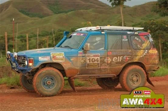

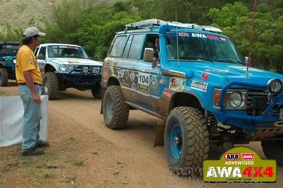

I saw a picture on a random thread of a 62 with the rear axle moved back about 10-12 inches or so. It looked awesome. I'm trying to find the thread now, but I'm having trouble since the picture was posted for no particular reason if I remember correctly. I'll let you know if I find it.

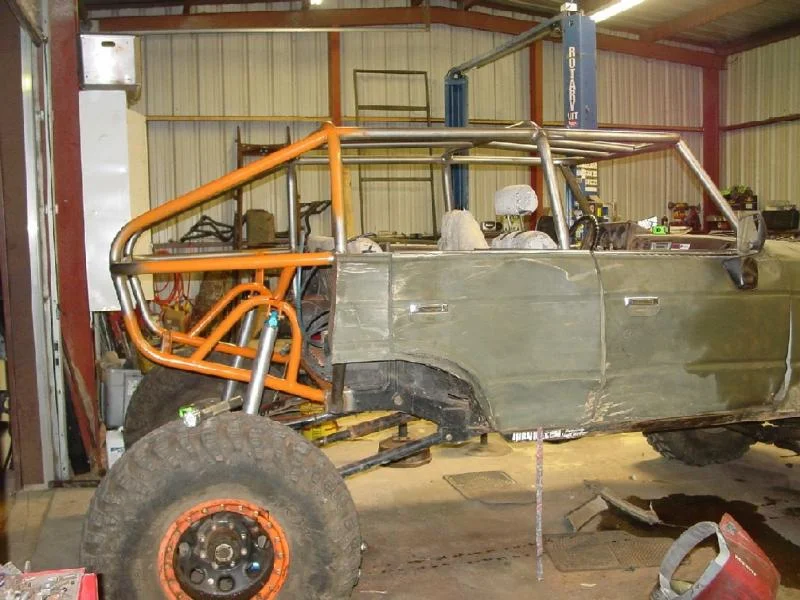

This is the only one I've seen in person. Josh Baker's done at JK Customs:

Do similar to pic above but take out the space behind the rear doors (8-10"). Link the rear unless you want a low hanging frame behind the tires for the leaf connection. You'll need to trim the fenders if you wanna keep it low. Hack the fronts for tube fenders & the rears it depends on if you wanna refab wheelwells or add a body lift for uptravel. Oh yeah, the S-10 gas tank fits perfect for a if you do a body lift.

I like mine stock wheel base stock springs SOA with lots-o-trimin and a bob job
before I chopped the top
I wish I still had my top but the open air fun as long as it not cols

Kling-on - I have looked at yours many times, I dig the orange! are you still using the boat tank? if not what are you doing for a tank?
Tapage - I probably won't go with the rockwells even though it's tempting.
I still have the boat tank 2.5 years and 5 roller overs later it still workin
I have a jeep tank I'm lookin at puting in so I can get my cargo area back ... a nice alum fuel cell would work too .... butI'm to cheap

extending the WB is a very common mod over here, most 60s have some extension.
here´s one on 44"
and one on 38"
the ride gets alot better on uneven surfaces with a longer WB.
it really isn´t that hard to do (most have coil or air suspension though).
EDIT: pic thread Ferðaklúbburinn 4x4 - Myndasafn
