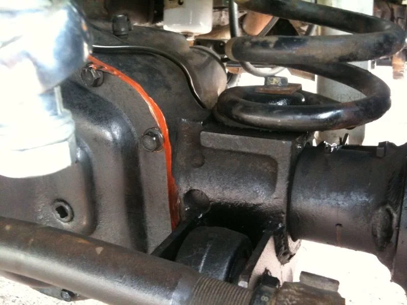

The driver's side perch is actually made into the diff housing. So it would have been a must to outboard the springs. It was also a good excuse to put coils in. I'll try to take a close up pic of the diff housing to give a better idea of what it looks like.

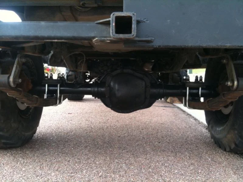

here is the pic of where the spring perch sits. You really can't move it.

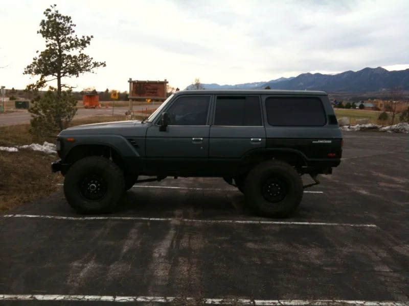

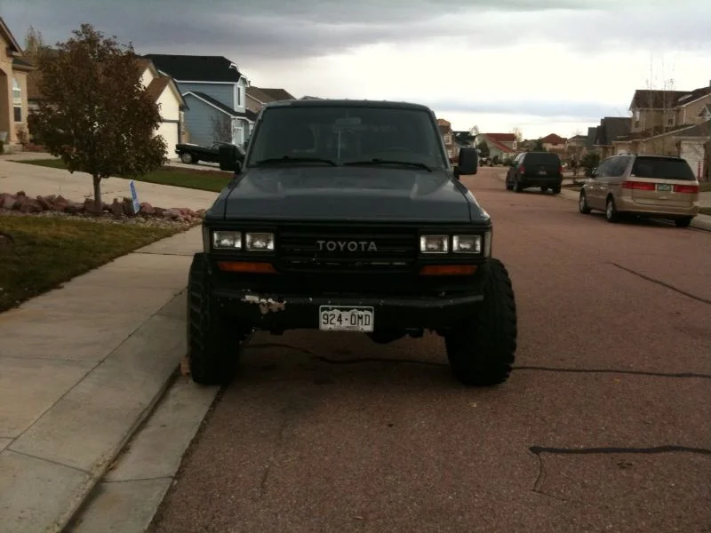

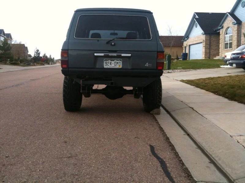

just some more pics of the stance and how it sits
ok thats not what i pictured in my head, it makes alot more sense now.

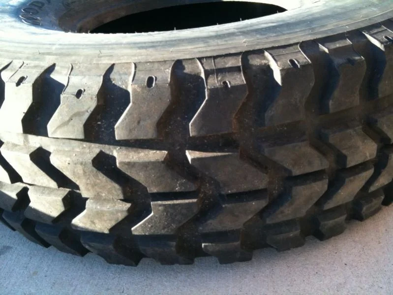

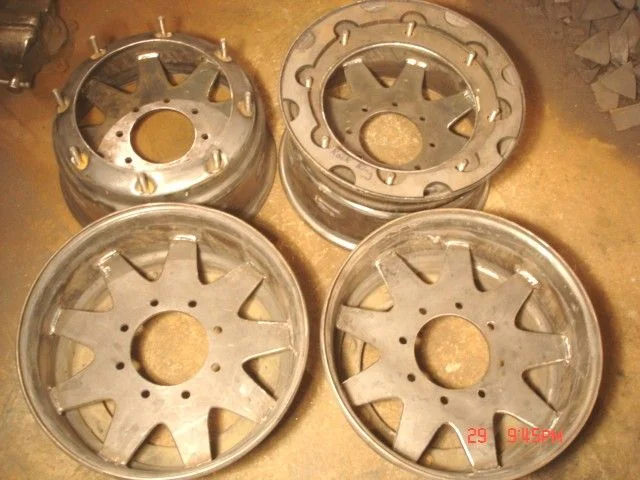

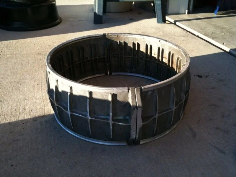

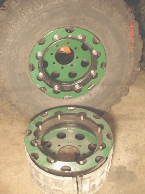

tires
I got my tire. $365 for the set of 5 and they are in great shape!!!
I cut down the run flats then ground off the sharp edges.
I have some wicked death wobble at 35mph. any suggestions?
tie rods are tight and so is the panhard arm. all suspension is tight no play.
I need to check alignment what should be the toe in or out?
I've been reading some about it and steering stabilizers can just mask the real problem. Seems like death wobble is a hard thing to figure out. could be even something as simple as unbalanced tires I guess.
any way here is the pic of one insert and a tire. I'll take more tomorrow in the day.

why the run flats?
and why did ya cut em down? it looks like where they bolt together is taller now than the rest.

why the run flats?
The run flats came with the wheels and that is what makes it the double bead lock. You cut them down because when you go wheeling you don't want the run flats to keep your tire up. You want your tire to be able to flex and wrap around the rocks!

death wobble be gone!!!
found the culprit!!! Ford axles (some apparently not all) have these wedges that hold the calipers in place. mine were worn out which was causing the calipers to slop around. replaced my pads and the wedges, also installed a steering stabilizer and it's all gone. hit 67 on the interstate and it rode smooth!!! even hitting bumps nothing!

I need to put in some bump stops first.
here is a pic with the 37's

Quote:
Originally Posted by CruisinFJ60 View Post
Makes sense, guess i was thinking that they already allowed some flex from em but obviously not enough.
So where did you get the wheels from? and how much did you pay? got any pics of how they go together? Ive never messed with humvee wheels.
99% of one's who buy the H1 double beadlocked wheels recenter them due to the negative offset. I recently recentered a set to 3.5". They are really a no-brainer when you get a set complete w/ the runflats. Make sure you oil the o-rings so they don't get snagged & leak out air. Also, tighten the outer piece of the wheel in a criss-cross pattern. The 1st set is the one's I just did, the 2nd pic is the set I run on the They both show aftermarket rock rings. There are vendors on Pirate that sell them, some I've seen for sale in your area. Check the Pirate classifieds. Sorry for the hijack

Just throwing this out there cuz your ride is looking good.
Here is how I did my H1's, you dont need rock rings but a 1/2" round piece welded on the outer edge. I got some flange bolts for the wheels and tacked all the nuts on the inside of the inner wheel. Now I have no studs hanging out to get bent and a stiffened ring. I got 50 bolts for $48 at mcmaster.
Here is how they came out
