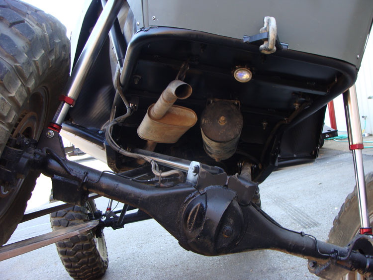

I'll try to set better oil level.

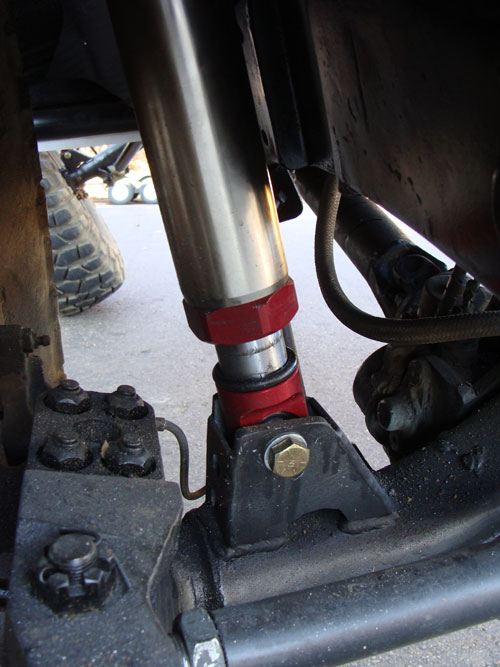

Front shocks have a little angle of 10/12°, I've been told that this is the best way to mount shocks.
Rear ones are almost vertical (just a few degrees of angulation, I guess 3° or 4°), this becouse I wanted to fit them between wheel and frame, without making holes in the cabin.
You say that this kind of mounting causes problem? I had some problems becouse in compression wheel hit the shocks, but I work out making a couple of higher bumpstops; you think that stright vertical they suffer more car's weight?

You might see rear shocks' angle from this pic:

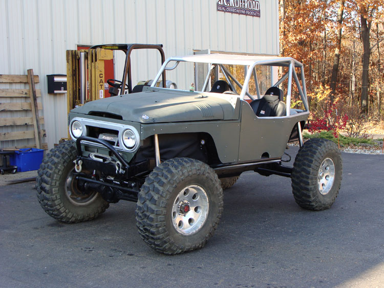

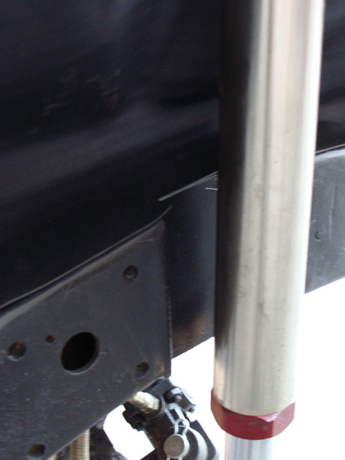

What is the material that you made the inner fenders from? I love the look of trimmed or tube fenders but hate all the dirt and mud that gets in the engine bay.
You might want to wrap some safety wire on the "clips" holding the pins in the ends of the steering ram or replace them with bolts. Circlips might work also. We used similar rams and pins on a grapple for helicopter logging a few years ago and we safetyed the clips with 0.040 safety wire and the were still getting knocked off. I can just imagine a small branch hooking the clip and popping it out.

The inner fenders are made from floor runner mat. I bought it from Lowes.

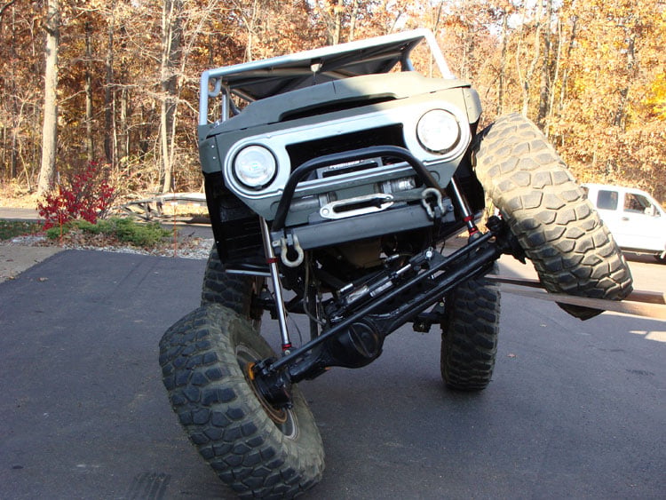

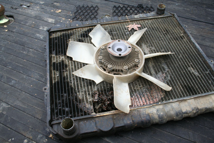

Well, Took it out this weekend. Overall it preformed well, but I did have a few issues. First, the factory fan ended up being took close and when I high centered on my front driveshaft the fan chewed a hole in my radiator. I had to replace the radiator and install an electric fan.
When this broke, we had to spend about 6 hours recoverying my rig out of Windrock and in the process I ended up warping the head and blowing the head gasket. We were having difficulty getting it out of the park and I had to start it and drive it a few times. One time I had to drive a little too long and I believe that is when the Motor problems began.
Basically now, the motor won't run over 210 degrees. So I will be replacing my motor with a fresh rebuild this winter.
The only other thing was that the shocks are a little too stiff. I am going to take some of the oil out and try it again. I might also add a sway bar to the rear. Otherwise, I was very pleased with it's performance.
Now for the pics.
This is where I blew the radiator:

normal on the rad issue .. bud sad to know you toast your head due to rad problem .. there wasn't a way to quick repair the rad just to keep the engine mid cool and get out there ..
thought the new engine will come with more goodys !

We crimped off the cores, but it tore apart at the tank. We put epoxy putty in the tank and left the cap off. It was good enough to get me off that riverbed trail, but blew climbing a hill out. In hindsight, I should have removed the fan...
I doubt the new motor will have too many bells and whistles. With Diesel prices down, I might hurry a new motor together so I can get back out on another trip before the prices come back up!

raw deal about the radiator, but thats the only way to test it out! ive just got one question,
When it transforms into an Autobot, what dose it look like?
