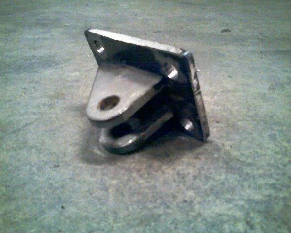

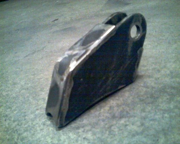

I also wanted the adjustability -- I made a simple bracket then attached it to the rod using heavy u-bolts that cost me $5 from a local spring shop. Cheap, strong & adjustable. I will post a pic when I can get it off of my phone a bit later.

Here are my mounts for the ram. First one is for the rod, second one I welded to the top of the diff.
