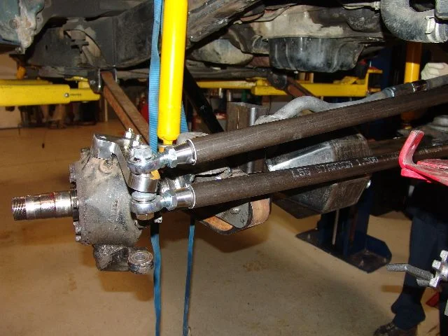

Quote:
Originally Posted by TachedOutOffRoad View Post
Ive seen people do similar to what you are talking about. On FJ80 knuckles/ custom high steer too.
Ill look for pics.
like this?

yep, that's pretty close to what i was thinking about, except you tied them together using the existing tre holes and have heims for steering joints which looks awesome, i wonder if that stud would hit leaf springs though? i think you would have to drill a new hole closer to the knuckle if running leafs...... are those fzj80 knuckles?

Quote:
I think they are. Those pics are from Slee's build-up of the blueberry. I think he was using 80 knuckles on a custom axle. He could tell you the full skinny on it.
Yes they are FZJ80 knuckles.
They dont know for sure if they will work with leafs. Nobody has tried wth their high steer arms yet.

Its got to Help spread the load on both the top and bottom.. I think its a good idea. they needed it with the FJ80 setup, because they only have 2 studs and an ABS sensor hole for mounting on the upper arm..
Off Topic, But why do people always use Misalignment spacers on their Tie Rod? It will always stay Parallel with the plane of the Axle, so why waste the Time and Money?

yup, mis-alignment spacers are'nt really required. judging by the pics, i'd say in this case the spacers also act as sleeves to reduce the ID of the heim so it'll work properly with the smaller bolt going thru them. it's pretty much the only way to run a bigger heim on the smaller bolt.
not all mis-alignment spacers are set up to act as sleeves as well.

They may be using them as a "safety" Depending on the outside diameter of the shim it could keep the joint from coming completely apart like a very used TRE. Just grasping at straws.
