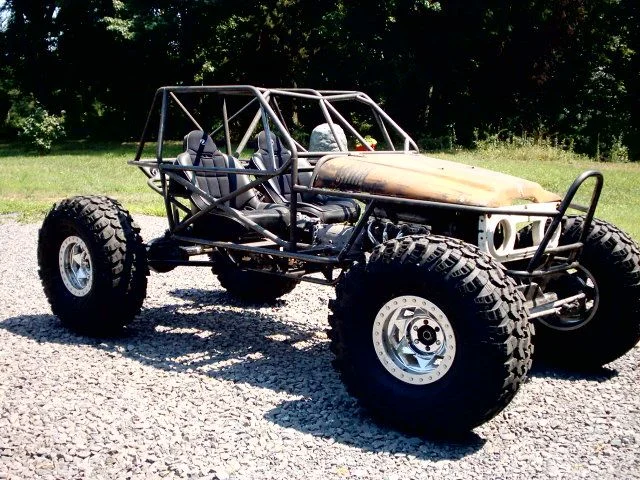

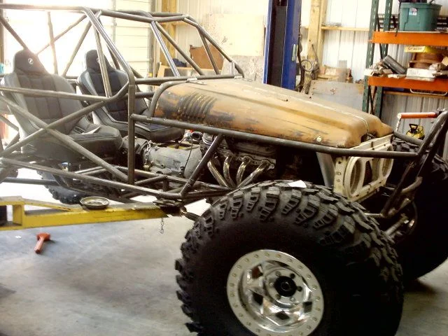

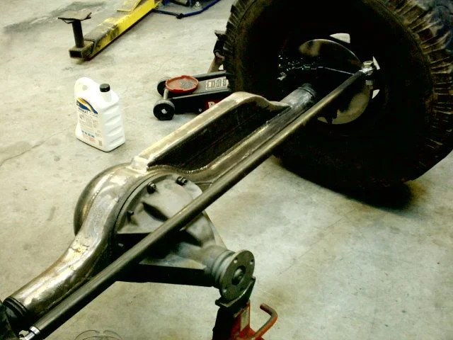

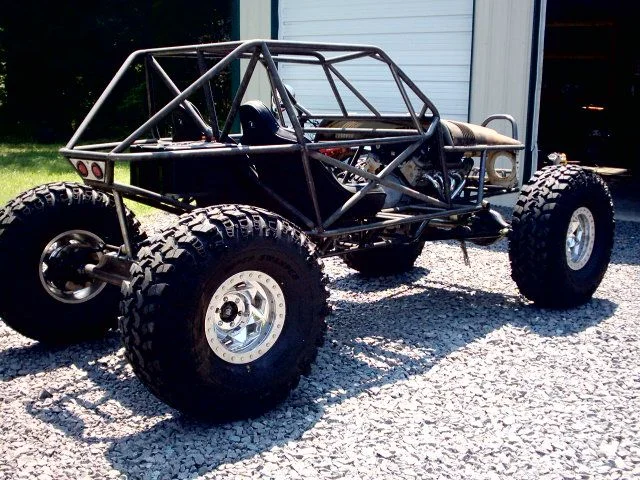

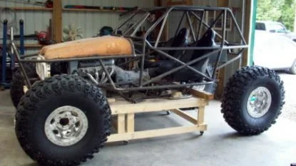

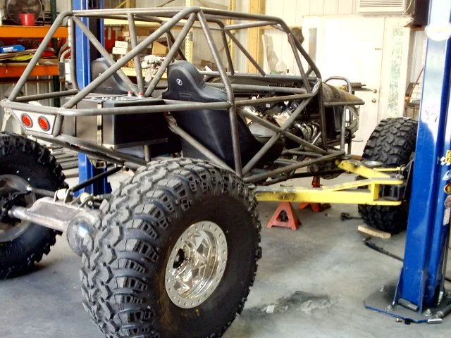

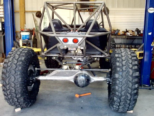

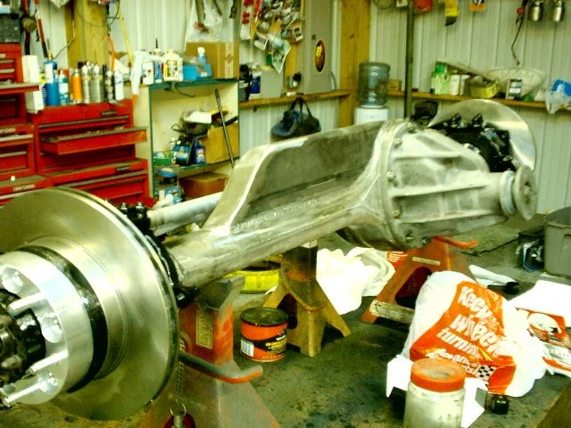

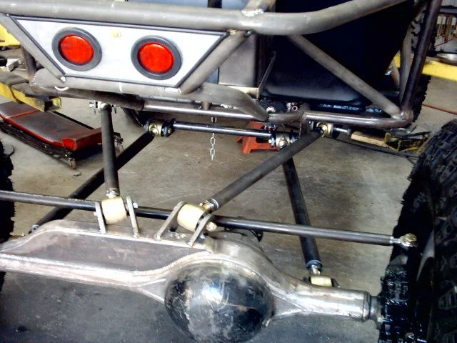

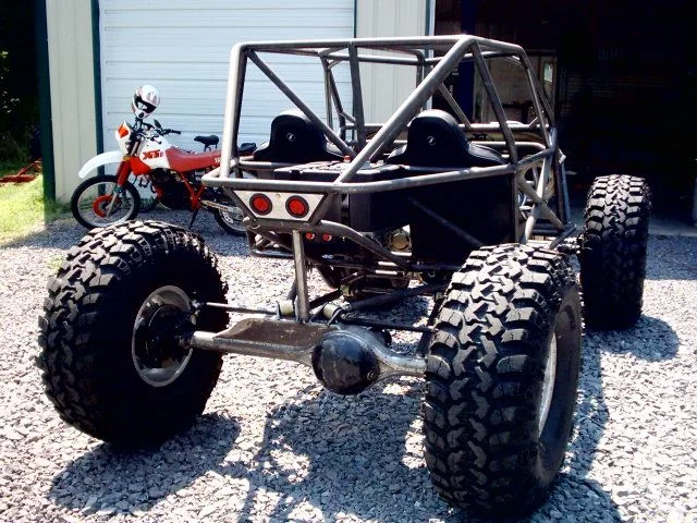

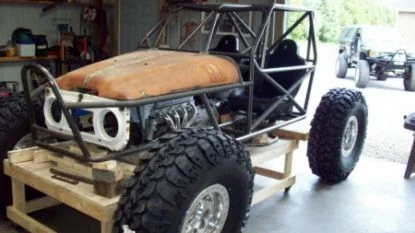

here is my newest rear steer buildup at the shop.. Trying to stay somewhat cruiser....

care to divulge in some more specs?
whats after the trans?

specs
2006 5.3 chevy to a turbo 350 trans to a 203 low range gear box to a fj60 t case... spit to front and rear steering toyota land cruiser axles....If i can get out of rookie territory i have more pics to show....

Looks dam good! Only Question would be why you would use an FJ60 t-case??
from your website it looks like you have done a bunch of the rear steer toy axles, How are they holding up?

i assumed the toy case because he was sticking to cruiser axles?

case
It is very strong and keeps everything to one side... Plus it is relitively lite...

what are you using for your rear steer axle? surely not mini-truck....60 series or 80? and what size tires? looks cool!

fj 60 axles front and rear... with 4.88's and longs all the way around...

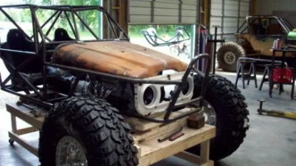

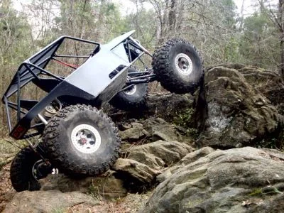

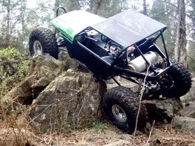

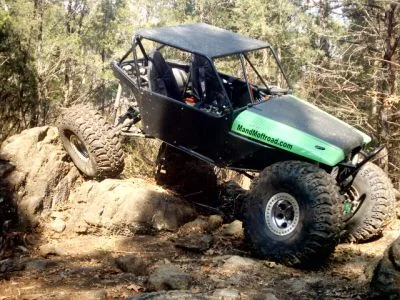

pics of original rear steer buggy..
Here are some pics of the for mentioned buggy... some more on the site...

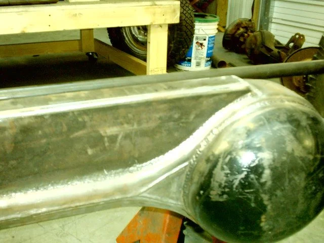

axles done
Finally got them done.... now on to suspension.....
mpistolpj is offline   Reply With Quote
Old 07-15-08, 04:52 PM   #27 (permalink)
Turbo Diesel Lover
Tapage's Avatar
Join Date: Apr 2003
Location: Panamá
Posts: 11,429
wou .. that's a beauty weld !

suspension work
used all currie adjustables.. makes replacement a snap.. High steer and links are tight but fit nicely...

more

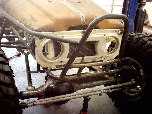

fresh air....
