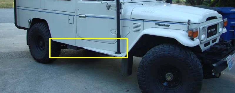

Building a slider for a longer wheelbase are there any pros or cons for certain designs?
Do you go one continious or break it up?
The area in the box is 73" long.

I would do continuous...

I would make it continuous, I think if you brake it up you will get hung up as you slide along. As the first one flexes the second one does not.

Thanks that is what I was guessing..

How about something like this. but longer acouse. it mounts on the rear spring hanger. it makes it stonger to.
hope that helped
