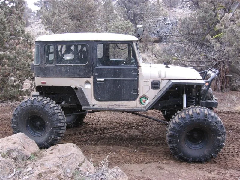

We ran into this guy on a run a year or two ago.
If I remember right he's was running a 455. Portals, 44s, coils, and missing a driveline. That much power is going to eat some shit up. Be prepared to go monster big on everything. Pretty much nothing Toyota ever made is going to handle that kind of HP.

Actually this is Rod Peters 40. It has a corvette 350 in it. But his brother has a FJ-45 pick-up with the 454 in it. Good guy's, and great wheeling buddy's.

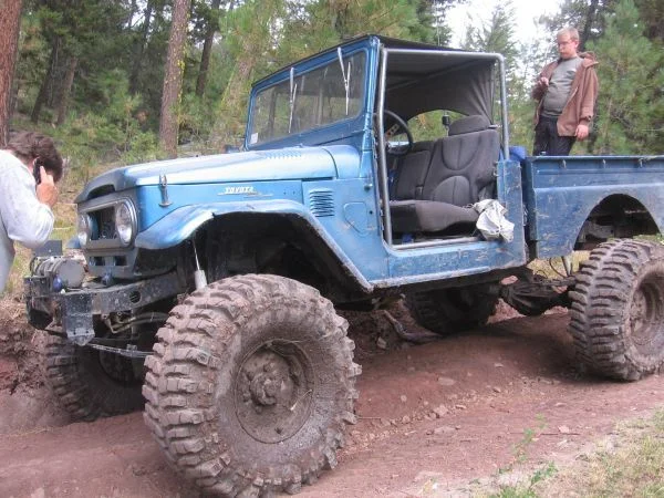

Ah... I knew one of those guys had a big block. I thought it was the 40. Here is the pic of the 45 I have...

yes that's the one! I don't have any new pics of Alvin's rig but here's a new one of Rods.

The 45 has one. Cooling hasn't been a problem- belt-driven, big aluminum radiator with a good shroud.. fenders still have inners. The only weird thing done to get it all to work was to dent up one of the headers to clear the steering rod.
