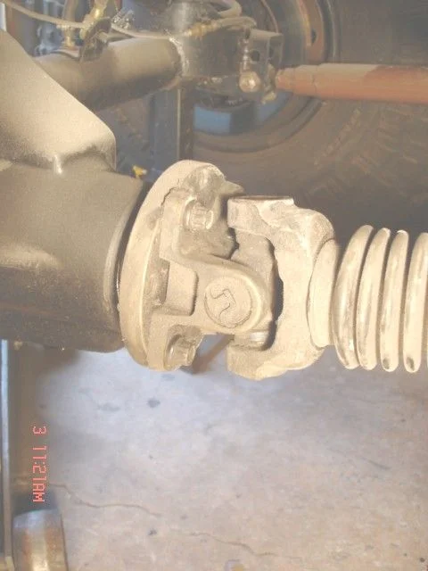

if you are planning to get a detroit anyway the carrier difference makes no difference for you.
Guess I didn't explain it fully
I'd swap out that pinion yoke for a full flanged one so you're not relying on those u-bolt straps as they'll snap easy. I had my aftermarket shaft flanges reamed for cone washers, just like the factory one's. I have a new (installed but never run) low case Detroit for 30 spline if you're interested.....

I'd be interested in the Detroit if I could build it with 4.56 - not sure what low carrier means, but guessing it's the opposite of high pinion? Can't commit to anything until after GSMTR. Not knowing what I might break - won't do me any good to have a half pieced together rear axle and be broke...
Definitely will be going with a flange - will be running my mini-CV shaft for a while - and then since I already have a 1350 CV flange on the Orion - will upgrade later. After so much rear axle breakage - kinda looking forward to maybe having a driveshaft weak link...

Low case = low gear carrier
I'm only using the 30 spliner cuz I don't plan on runnin any larger tire than what I have on it now. If you think 42's are in your future, go for the 35 spline for sure. Then, you'd need to clearance your spindles & get a 35 spline Detroit, which are always in the for sale section on the PBB.
