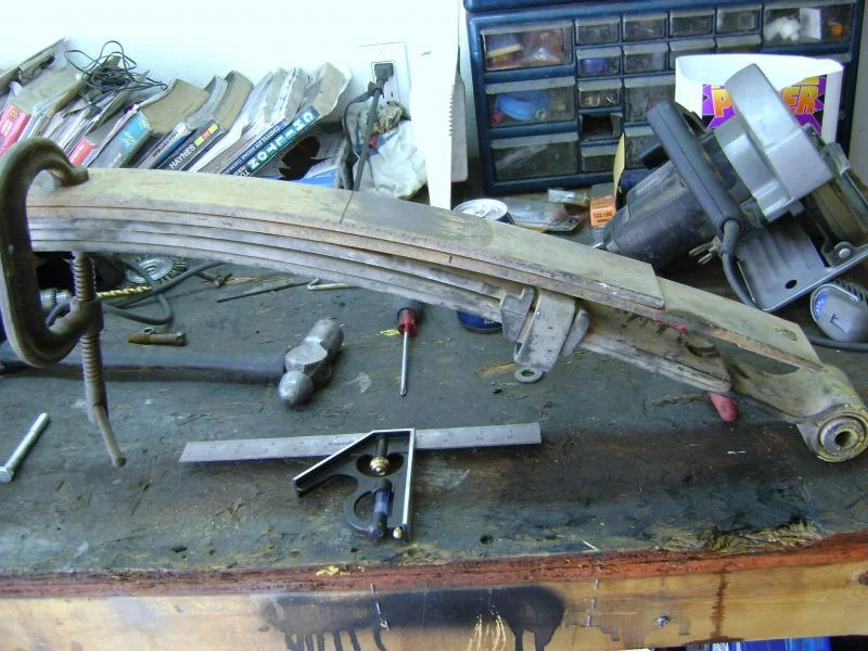

1. Here's the packs mocked up. Starting from the #2 spring, the leaf length will stagger 5" to 4" to 3" shorter each successive leaf. Note the pen marks for each cut, if it helps clarify my plan.

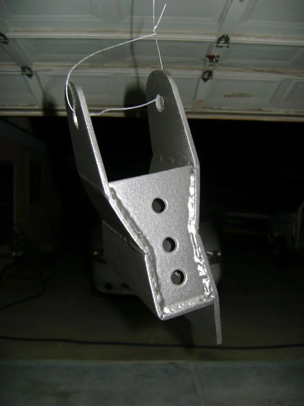

2. Here's the first front shackle hanger. It will sit within 1.5" of the end of the frame, and the spring eye centers at 6" drop. Progress is stupid slow, but it's progress nonetheless.

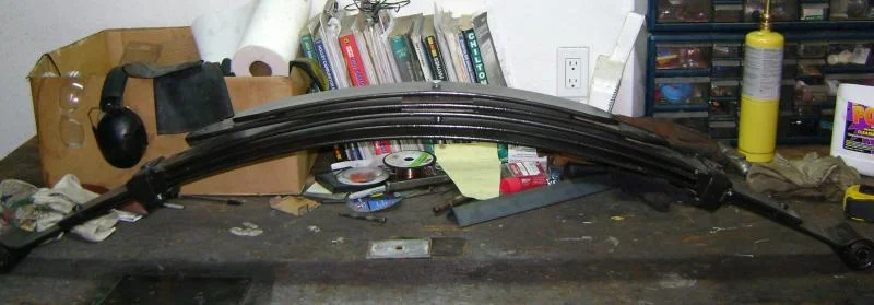

3.Here's one completed pack, save for a properly sized center pin.

So, thats the front SPRING hanger correct? Are you mounting the shackle below the frame in the rear?
I'm gonna give my two cents here. I've been down the road of long shackles and obnoxious hangers that drag on everything. Truth be told, I eventually went back to a six inch long shackle that sat in the frame, not below it and stock height hangers for the reversal on my FJ40. I had 4 inch lift springs on it for maybe two years and then I finally listened to the hardcore guys and sprung it over. I will never go back.
On my 62 I kept it simple. OME medium (Upgrading to heavy for winch) including their shackles and 31's. If I ever want to go bigger (part of me does) I am going to spring that over too and run some 35's with a hybrid flat spring pack (keeping it as low as possible) and sell the OME. I probably won't do a shackle reversal on my 62.
A lot of people take your route for money savings and most of them end up redoing it.

Yep, that will be quite the rock anchor, won't it? It turned out very similar to MAF's 4-plus SR kit, obviously. And yes, the rear hanger will weld under the frame. I'll start testing the resultant caster and spring motion with just the 4" long OEM S10 shackle I pirated along with the springs. Then, I'll build a permanent replacement of appropriate length.
This project is about specific compromises I'm making. I came back to this idea hastily as a response to a recently broken stock spring pack on my DD'd 62. Being needed for daily duty, I feel I can't leave it sit on stands for 2 weeks while I do a proper SOA. By 'proper' I mean frenched and or very short spring hangers, nearly flat springs, etc.
Not going spring over and wanting to use common JY springs leads me to two choices as I see it. Stupid long hangers or welding a zero-rate block ( or two) to the perches. (Well, a third choice could have been to simply replace with used OEM springs, but I decided that was too simple hehe)
For it's intended use (DD, hunting rig, and moderate wheeler) I'm hoping I'll be able to stand the way it turns out. If I get a year or so of acceptable performance outta this current mess, then I'll be satisfied.

Id make that SR spring hanger much much much lower profile....
one of the P.O.'s of my 42 put the maf SR on there and i like how it rides but HATE the fact the front spring hanger sits nearly as low and possibly lower than the stock front shackle.
I will be Redoing it once i have money to spend on new spring hangers and will take those off and run some normal right up against the frame spring hangers and burn them on.
Why don't you just cut the old perches off and weld new ones back on in the correct orientation?

I think the guys are just trying to help me out, so their opinions are welcome.
However, I do agree I'll continue with my plan as I feel it fits my needs and intended use for the time being. The biggest discord is where our opinions are coming from. I did ask this in a hardcore section, so the answers are gonna reflect that. The idea that any fix must be back on the road in less than 2-3 days max is just not a common concern in this crowd (as I see it anyway).
As I noted, this fix is about compromises. If I had planned for such a problem, or if I weren't as stubborn to charge ahead and instead just repair with stockers for the time being this would be simpler. Simple is good, unless you are just stuck to seeing an idea to it's end like I am.
If the only major drawback is the low hanger height, then I can live with that for the time being.
I think this statement may explain my intent to continue as planned, along with the knowledge that an angle grinder and an afternoon can remove all of this project for any future stages.
How'z that all sound?

Larger diameter tires will eliminate your soon to been seen, approach angle delema. Standard shackle configurations ride like crap at anything above 15 miles an hour...
