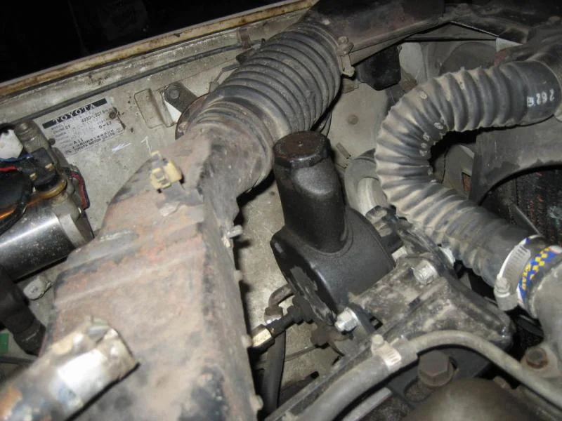

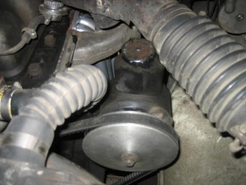

I did my conversion a while back and bought my pump/hoses off the shelf at a yard, no #'s, works perfect! Fast forward. Dont let your friends drive your Cruiser after such mod- you'll be doing theirs soon. So I start collecting parts to do my friends conversion... start looking for the same pump as mine...online, yards, catalogs, under hoods, everywhere? All to no avail. Finally one day the stars are aligned and find one that *will work* but needed hoses/or hose end and bolts. I go to look at their stockpile and one tries to stab me in the eye! pump/hoses/all bolts/stock bracket and all! It looks to be the EXACT same as mine! WOO HOO!
I am sure there are several that would *fit* the bill. What I really liked was the shape of the tank, if you are retaining the stock later air cleaner, and using the said bracket (4+,ect.) it allows for decent clearance and a stockish appearance- see pics
Not sure if different GM pumps had different pressures but... mine is awsome, I have a GM pump with a '84 60 box, 4+ bracket, MAF alum. pully, and custom hoses, no cooler yet.
Anyway, when I bought the second pump fourtunetly it had a tag on it, I finally found out the application if ever needed
It is off of a ...

Just playn Its off of a '69 Nova. Obviously there will be a nut on the front of the pulley as well as a keyway, NOT the allen head! The neck is also rounded, not squared.
