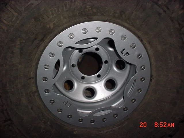

picture of mine (old style)

Those are really sharp looking. Is the hardware stainless? Is the allen keyway large enough to allow for applying sufficient torque to get everything seated right? Curious - as that's a really flush looking setup....
Yeah- they are stainless 3/8" x 1 3/4" flat head cap screws (FHCS) I countersunk each of the bolt holes in the mill before the rims and rings went for powdercoating. They take a 1/4" allen wrench and like Mace said, they don't need to be torqued down really hard, just enough tension to keep from rattling loose.

i like the old design better... (the on in the pic above)
just because it looks cooler

I've got the old ones too, and love them. I like what Luke did with the counter sinking and, when I get new tires I might do this...I'm gonna re-PC them to get rid of the Safety Orange, but sticking them on the press and drilling the countersinks shouldn't be too difficult
IIRC, the torque is ~20-22 pounds..just takes awhile to get them all torqued to spec

Ok...stupid question...why is there a difference between a 16 and a 16.5 as far as beadlocks go?

The profile of a 16.5" rim does not have a raised portion behind the bead of the tire sometimes referred to as a safety bead. The only thing keeping the bead seated on a 16.5 is air pressure.
15s, 16s, and for that matter probably 22s and other crazy sizes have a raised portion that once the bead of the tire is stretched over it- it is pretty difficult to get it back unseated. It can be done by hand, but typically requires a tire changing machine.
So, bottom line, 16.5s are not very conducive to off-roading, ie. if you need beadlocks, you don't want to do it with conventional 16.5s.

Unless they are hummer rims
BTW, there are a couple of 16.5's that did have good safety beads..
Also, IIRC it is more of a .5 desigination.
19.5" rims do not have safety beads either.
