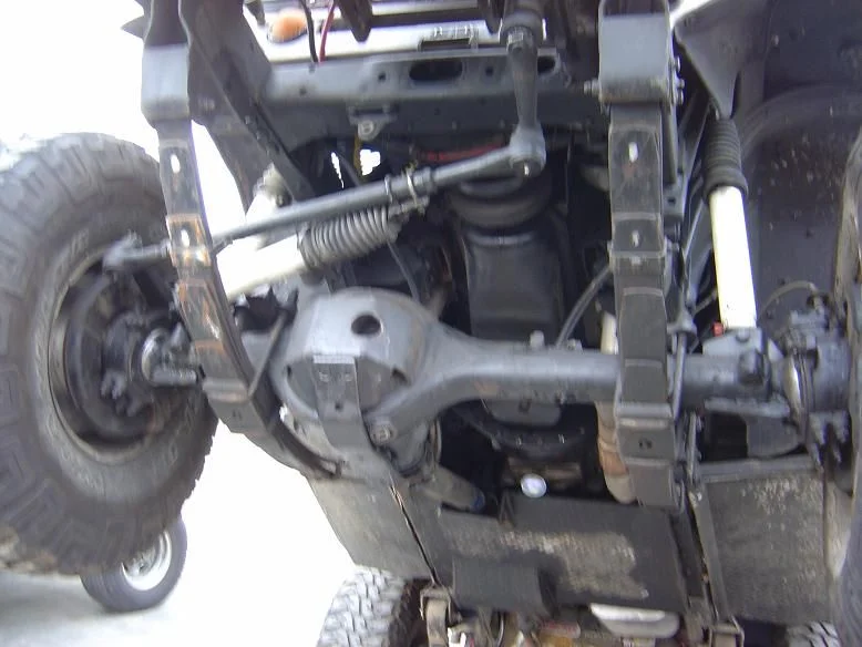

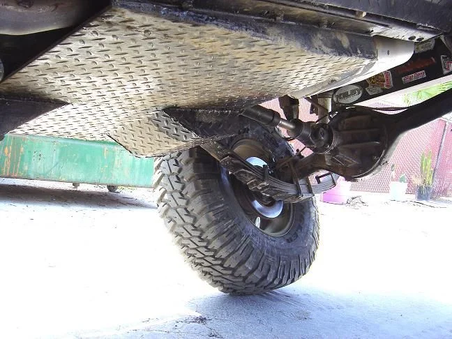

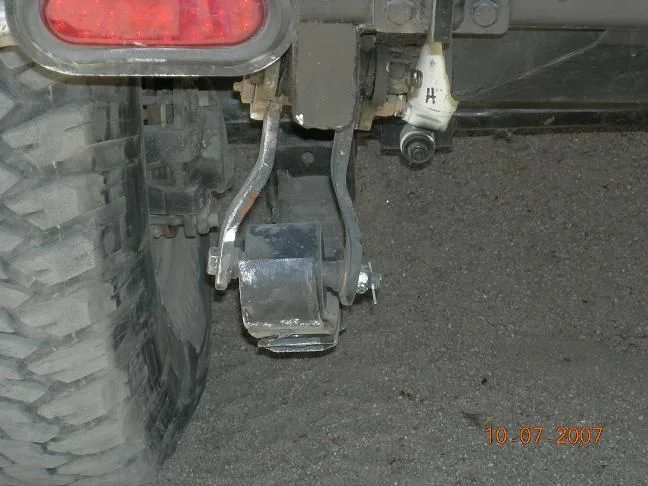

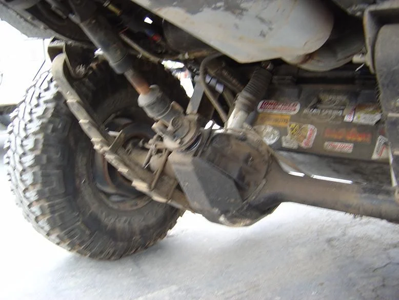

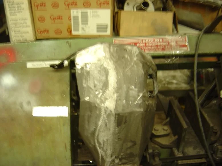

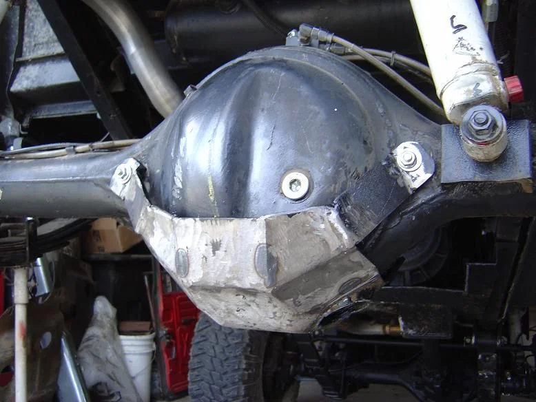

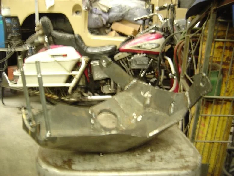

The axles were getting beat up so decided to fabricated some axle protection. Went to the local metal yard and picked through some rim stock. Used a long 3 inch wide piece of plate and started cutting, bending and welding. I welded some quarter twenty bolts to the rear of the axle housing as mounting point. Then used exhaust coupler ubolts as a attachment to the third member.
Let me know what you guys think.

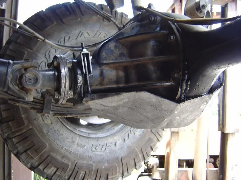

The axle skid plate is removable in seconds. Made an access point to the drain plug. I also drilled a whole in the bottom of the axle skid plate to monitor lubricant leaks..

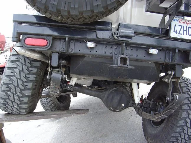

More pics of the undercarriage

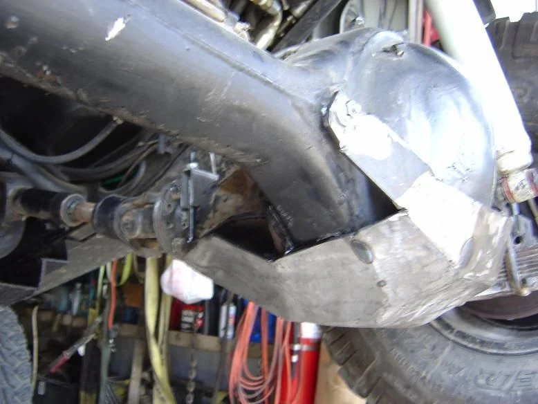

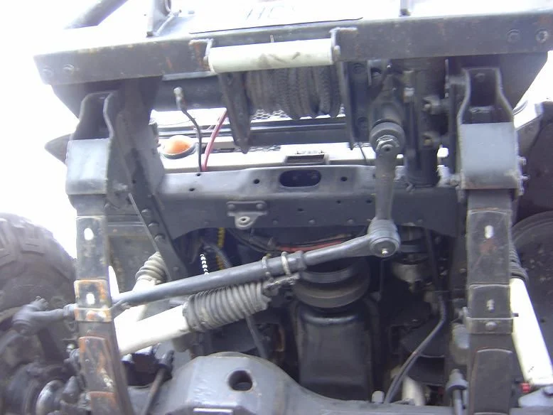

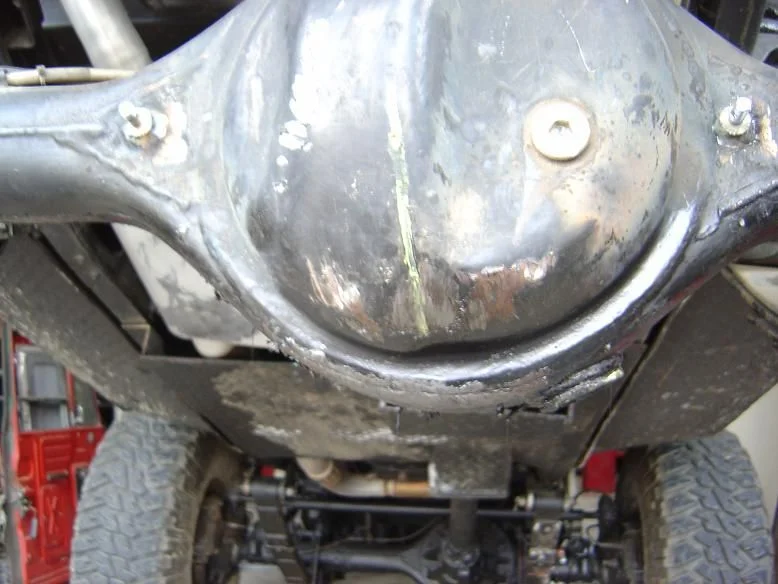

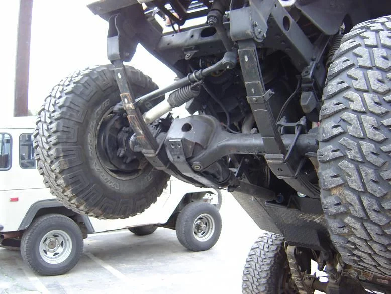

more pics of undercarriage. Fabricated a removable plate on the front 3rd member..

The 3rd member sliders work very well. thanks

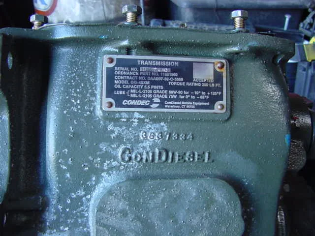

Posts: 102

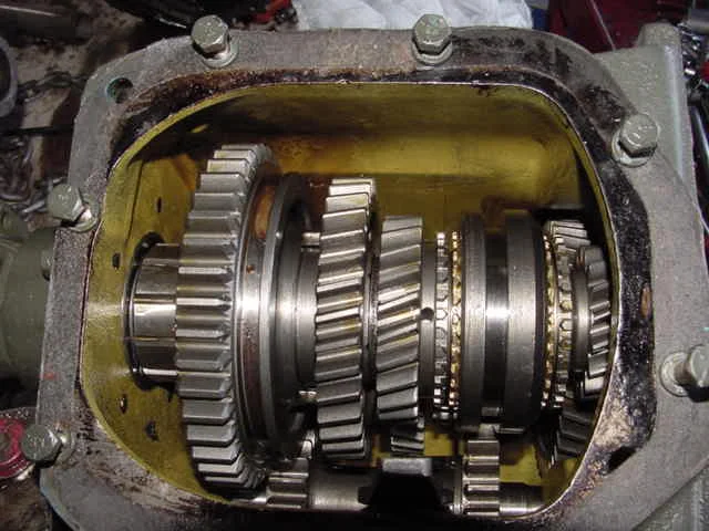

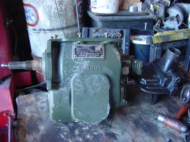

The wierdest thing happened to the SM420. The trannie started making a god awefull grinding sound. Was able to make it back to CA. When I pulled out the trannie I was not able to get the adapter plate allens bolts out. I put some heat to the plate being carefull not to warp the adaptor plate. I still couldnt get the allens bolts out. So I took the BFH to the trannie.

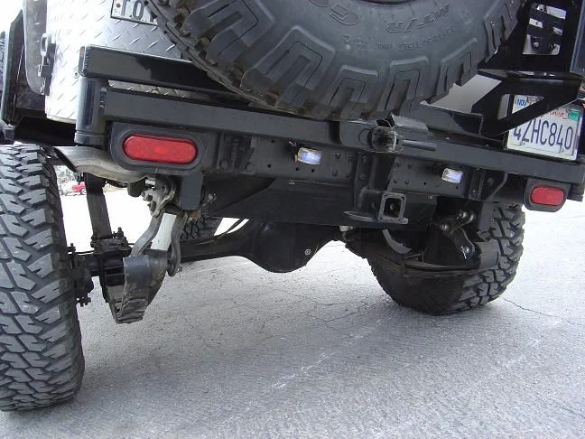

Join Date: May 2007
Posts: 102

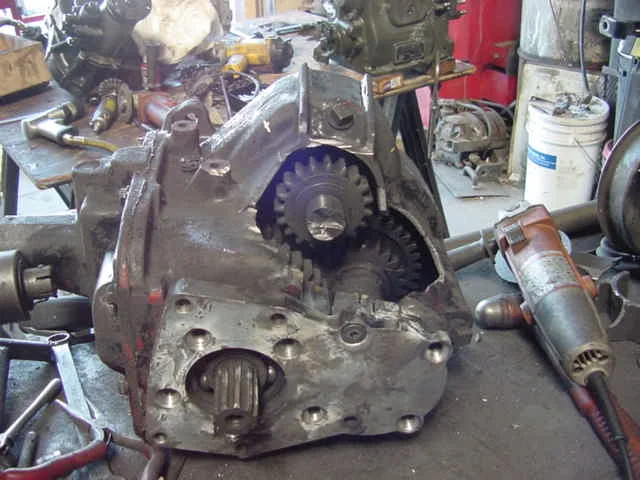

It turns out when I though I got take 3 different sm420s and mate them together utilizing the best parts from each one just doesnt work. The snchros all looked good and the gears looked good but I did not learn that different years have subtle differences. I was able to find a brand new SM 420's that still had the cosmoline all over. The trannie was made for the military gamma goat. Pretty cheap and since the install I havent had a problem. Next build will have a later model trannie (NV4500)
mrqtipp is offline   Reply With Quote

Nice find on that SM420! Sweet!

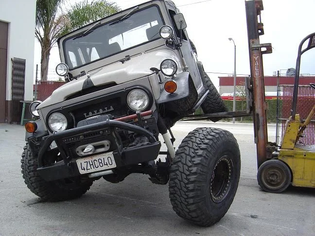

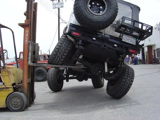

thought I would post some fork lift articulation pic. not bad for leaf springs

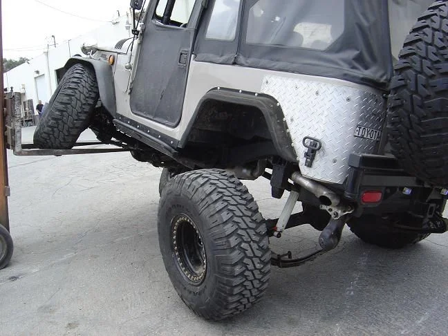

more forklift pics. will upload some off road pics soon

Great flex for spua! I'm getting another set of custom springs made for mine soon, hopefully they can match your travel!!

spua with scissor shackles and cut springs!
be careful those spring packs dont explode

I wanna make my Tencha flex like this !

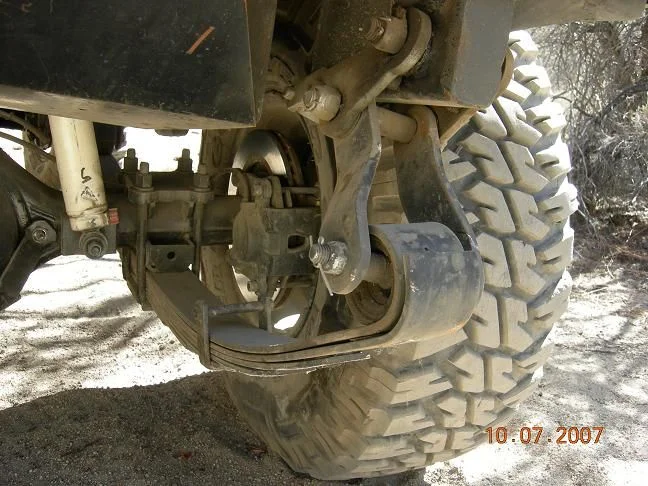

Can you show us a detailed pics of your shackle / spring packs pins . ?

more pics of springs. Will post off road pics later

oooh ok, not bushes

Are those heims in the shackles??
or really old bushings.

They are Alcan springs with Orbit eyes. The Orbit eye has the ability to flex 38 degress in all directions. The springs are great.
Alcan Spring - Manufactures Fine Custom Leaf Springs

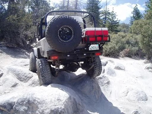

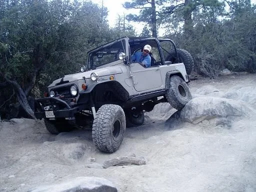

Old 05-03-08, 10:15 PM   #81
IH8MUD Junior
Join Date: May 2007
Posts: 102

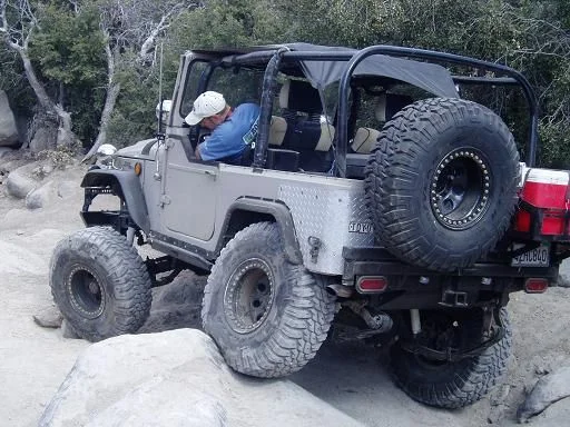

thought i would post some off road pics. they never come out the way you think they are

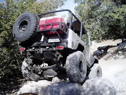

Old 05-03-08, 10:18 PM   #82
IH8MUD Junior
Join Date: May 2007
Posts: 102
more silly pics

is that big bear? looks like it did good. what part of cal are you in
