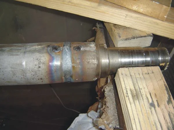

Posts: 1,781
I bought this 14 bolt already cut down w/ the sleeve method used. Uses a Moser pass side short shaft:

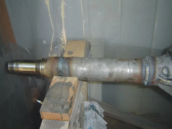

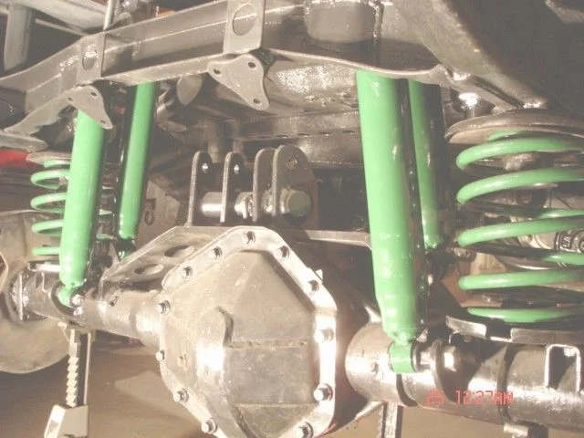

Got this done by one of the better shops in town:
They used the sleeve method on it.
While they were at it they TIG welded the housing to the tube
as the tube can rotate in extreme cases.
Now I just need to get it shaved...
(the bottom of the housing)
George

NICE work!
BTW, Al,
He has a point. Welding the center section to the tubes is important. Unless you tie the upper link mount into the pinion cartrdge (refrence the BTF 14 bolt upper link mount).. Then you are fairly well supported..
