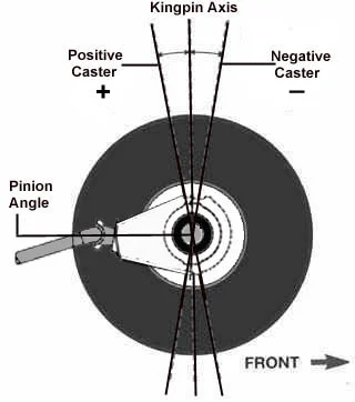

I have never seen an off-road car with purposely-designed negative caster, so when you pass my slow ass, would you be kind enough to stop so I can observe it

shot myself in the foot on that one.
I thought for sure neg caster was leaning back not foward.
so yes i agree with ya.
