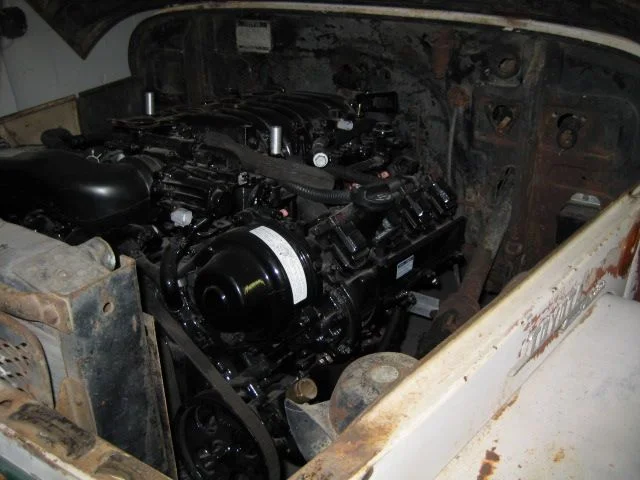

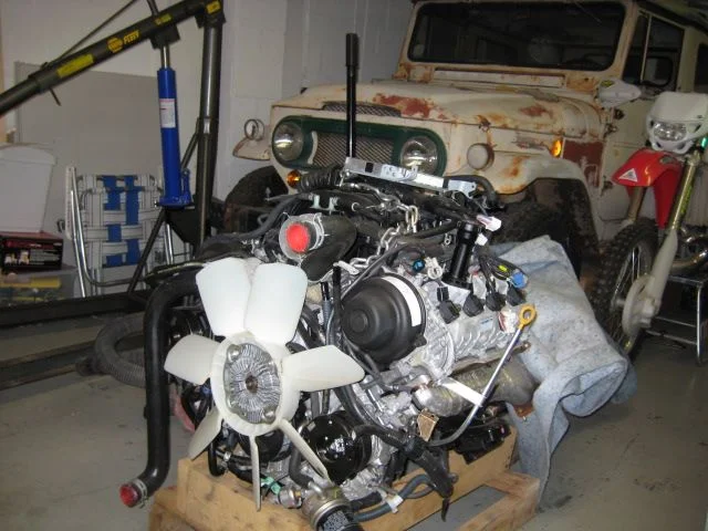

I have been "Slowly" working on my 1962 FJ40 engine swap using a
1UZ or 2UZ....presently I have a 1UZ Toyota marine engine just setting in it doing measurements and was going to use a manual belhousing to use a Toyota manual trans but I have changed my mind...
I picked up a complete 4.7 drivetrain with harness and ECM that I'm
going to use instead.. There are a couple of places that make manual belhousings for the Toyota V8's..
www.dellowauto.com.au
www.rodshop.com.au

this it's a slow built .. so be patiend with the upgrades ..
Today I got the gas pedal, with the under dash harness, starter cilinder and key, along with the ECU meanwhile here is some new stuff .. 2UZ mathed to H150 tranny .. HF1A t-case ..
almost in ..
