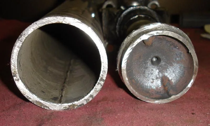

Just curious, do you really want a drive shaft that is strong enough to shear a pinion or bust a transfer case, if you fell hard on it?

Quote:
Yes
