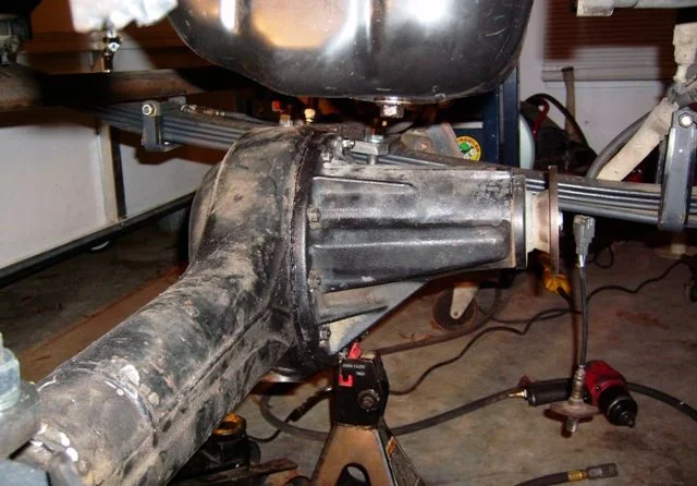

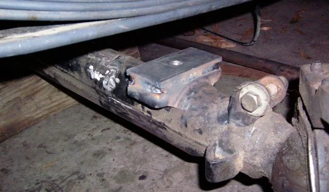

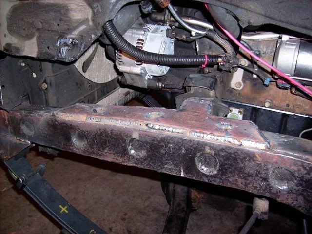

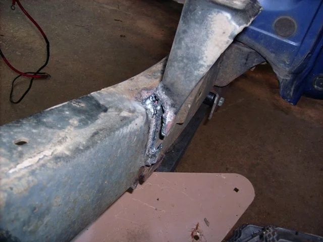

Worked on it a bunch but you cant really tell by looking at it The little stuff is a killer!!

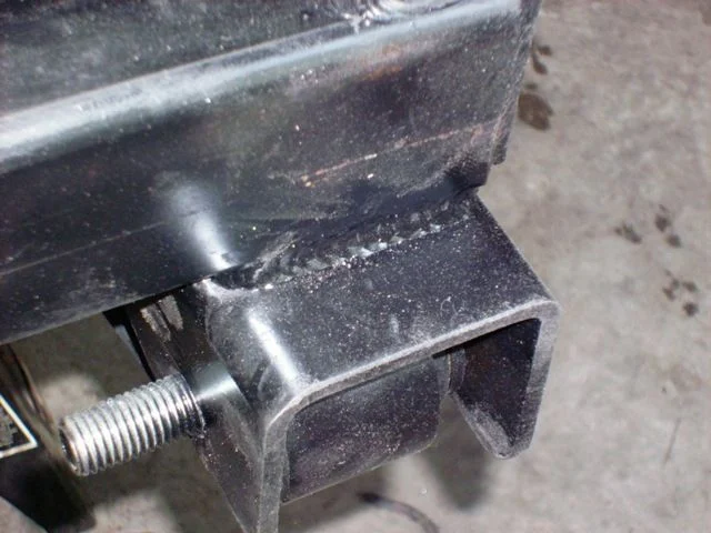

Plated the frame where the motor mount connects. I need to beef it up too.
Burned in the front suspension. When I build the front bumper Im going to box these in.
Almost forgot about this guy. It shouldnt come off

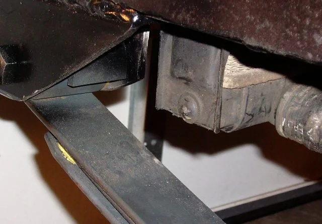

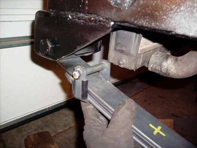

The body flexed back about 2" when I cut off the body mounts and beat the fenders. It was a red cunt hair from touching the radiator.
Had to slide this clamp down. The spring may still hit without it I have room to move the rad up 1" before it hits the hood. I might do it just so it wont hang down quite as far.

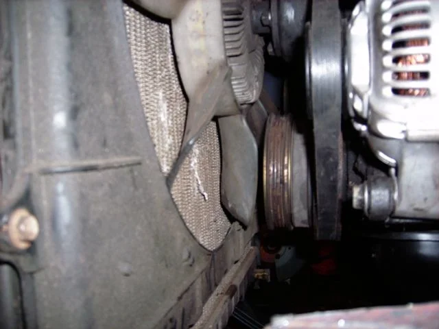

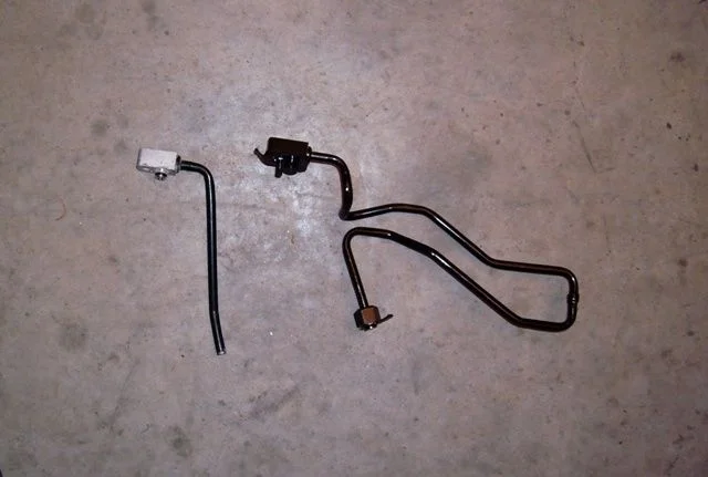

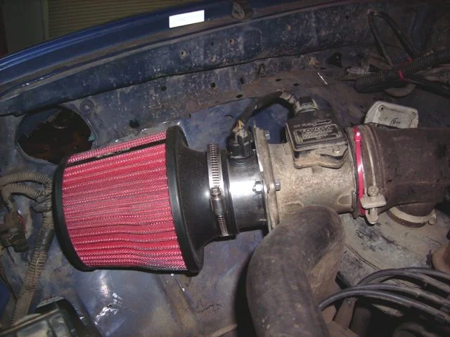

The giant factory airbox wont fix anymore so I got a new filter and MAF adapter.
My A/C line was broken and the little guy on the left only cost $69 form the Stealership worth evey penny though. Ive got $130 in fixing the A/C and it will be worth ten times that this August

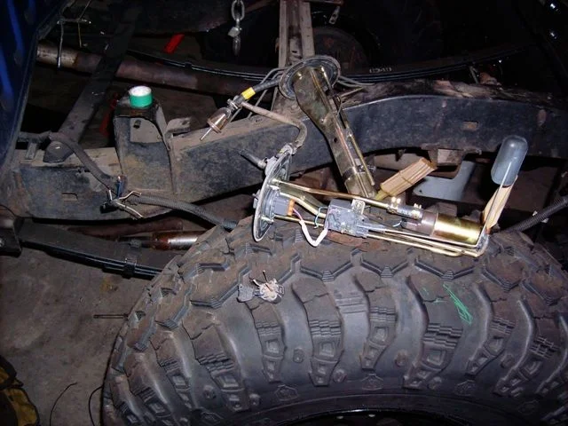

Playing with fuel pumps. I was worried about swapping these, then I realized Im a dumbass and I only need two wires to make it run like everything else I just always seem to let the magic smoke out of wires when I play with them.

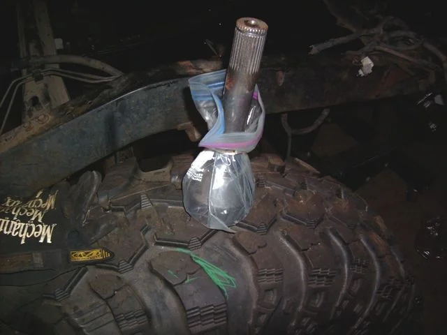

The sack that gives you sack.
Somebody put my 3rd member in upside down too

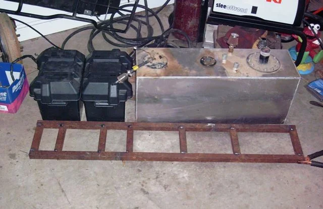

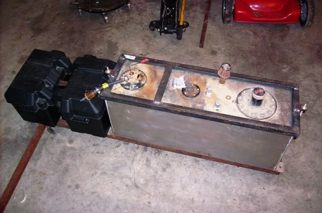

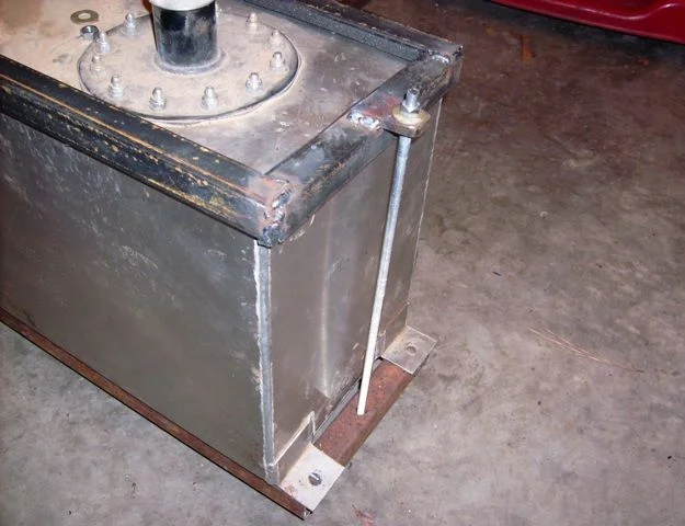

Started working on the rear fuel cell and battery mounts and I made it this far before the second happened.
These should fit just right between the bedskins.

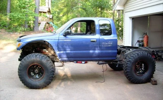

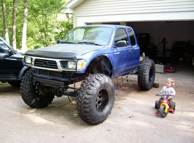

Thats about it I guess. The little stuff is kickin my ass. The new battery cable was a foot short, so I had to find another length, cut of off, go to Lowes, get a 4 gauge connector, find my shrinkrap, tie it up and hook it up. What should have taken 10min took 1.5 hours But is running and blowing cold air so thats a great motovator.
We are leaving on the 22nd to KY so Ive got 20 days to: mount the batterys and fuel cell, new spark plugs, weld in exhaust, weld in rear suspension, put in driveshafts, mount shocks, get it steering and stopping, put my cage in, and have a least a halk-assed test run at a minium. I hope to have the bumper, winch, sliders, bobed skins and paint done, but we shall see . . .
as it sits today . . .
::edit:: damn it looks tall! Its really only 2.5" of lift! I guess its that damn fender trimming job
14" under the front diff too.

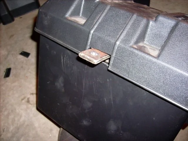

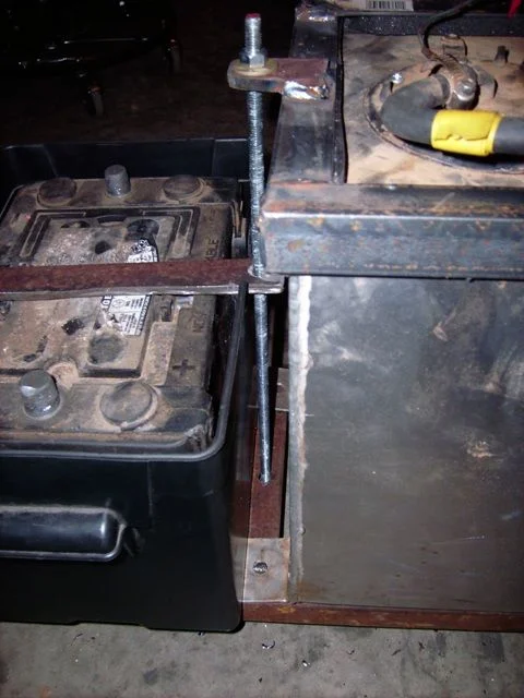

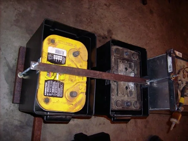

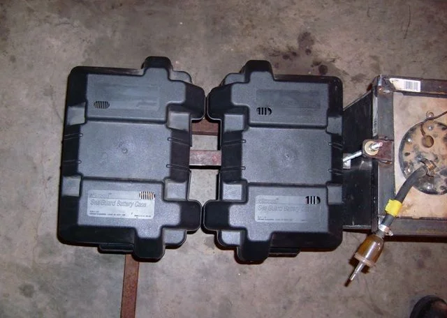

Battery box work
The boxes are for putting a portable battery in your boat and the battery would bounce around in this truck, so I super-fabbed a hold down and trimmed the box. Its so muddy around here and I want to be able to keep the clean/ accessible

Got some 1x1 angle and made a cell hold down. It has weather stripping on the inside to give a little give for the frame flexing.
Its not finished, but Im likeing the way its coming out.

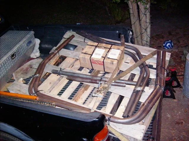

Off Road Solutions Tacoma In Cab Cage, in pieces
TachedOutOffRoad is offline   Reply With Quote
