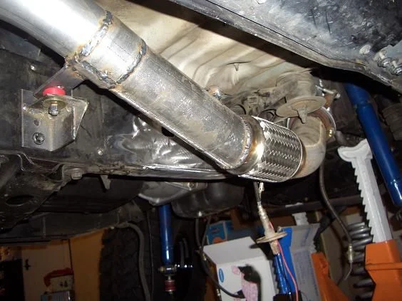

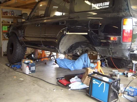

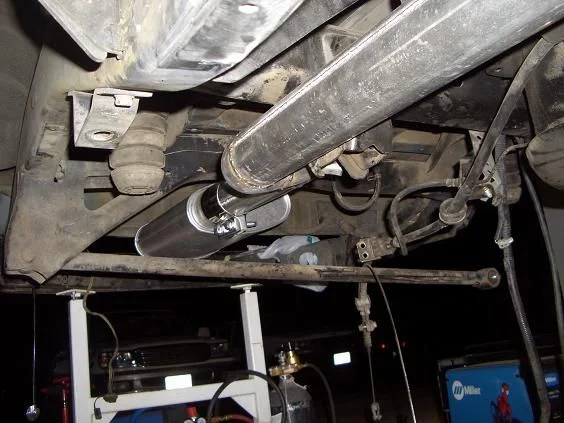

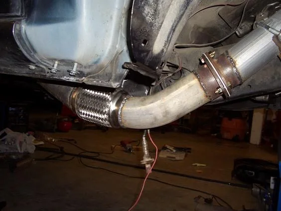

getting closer. axles being built by a local shop. They are also working on the truss for me.
built a 3" exhaust this past week. went over the frame intead of under. 3" fits rather easily for those considering this on their 80

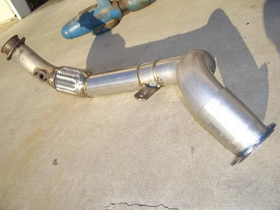

more

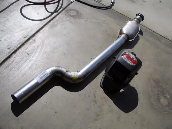

mores

i didn't go over the rear crossmember like the oe does. The 3" barely fits here. instead I went just lateral to the pass side rear upper suspension arm hanger. but I wont be using it so I wraped aroung it heading back into the middle of the truck to avoid the rear shock.
I was able to stuff a piece of 26g 12"x 24" aluminum sheet abobe the 3" exhaust that goes over the frame. I bolted this in place with bolts already under the body

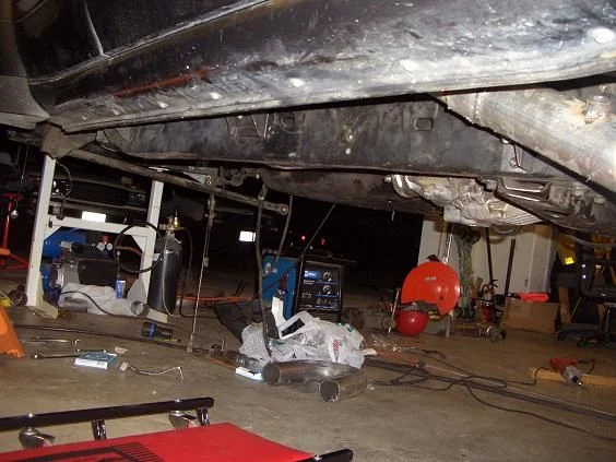

was a bit of work but worth it. Hopefully the turbo will give me a little more power with the bigger tube and run a little cooler. I welded the lm1 port for the wideband If I ever get around to dynoing her.

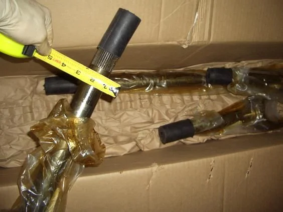

the 4340 35 spline yukon shafts got to my door the day after I placed the order. I have been waiting 2 months on superior or alloy shafts which are both still backordered at least a month. The yukons were not my first choice but randys ring and pinion sure offered a great service on this deal at a great price.
Note to all-NEVER BUY PARTS FROM 4 WHEEL PARTS. WHAT A JOKE. they sent me 3 wrong arbs. I had to finally tell them myself the correct part numbers.

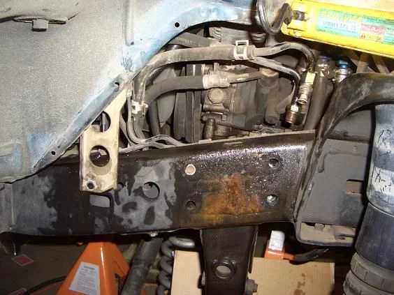

I removed the steering box today and will attempt to port it myself tom. If I run into problems I will ship it to pse and have them do it
Hydraulic Assist Tech
I think I will use the 1.5x8" trailgear job as I can go to their warehouse in person to take stuff back.
Trail-Gear Inc > Ram Steering Kit
also considering this
Rock Logic 4x4 - Serving Your Real World 4x4 Needs - Rock crawling, custom fabrication, suspensions, axles, hydrolic assisst, custom roll cages and more
any other suggestions?

nice work on that exhaust! I love those pre-made mandrel bends as well.Nice looking 80 too.
