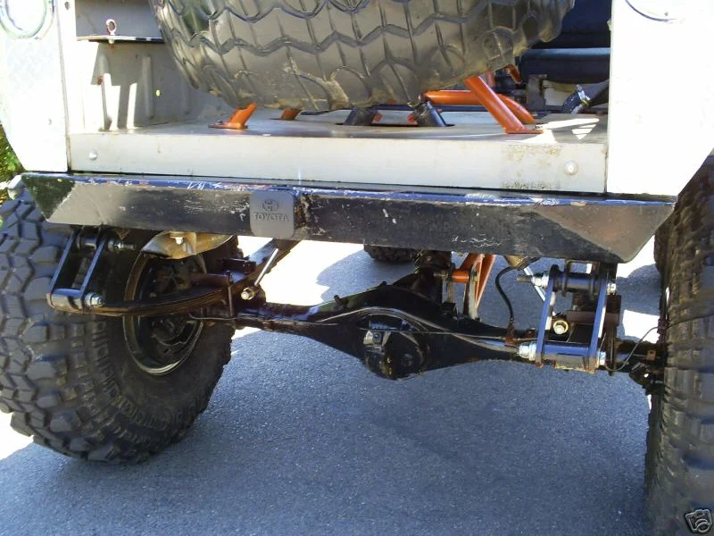

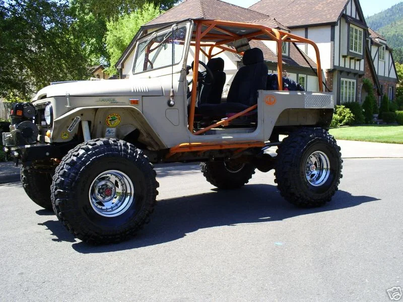

I have Woodies old 39.5's on my rig.
This was a couple weeks ago, I rubbed on my bib here,
Here's from the back, no rubbing there,
Side shot when I first got them,

stock 40 axles?

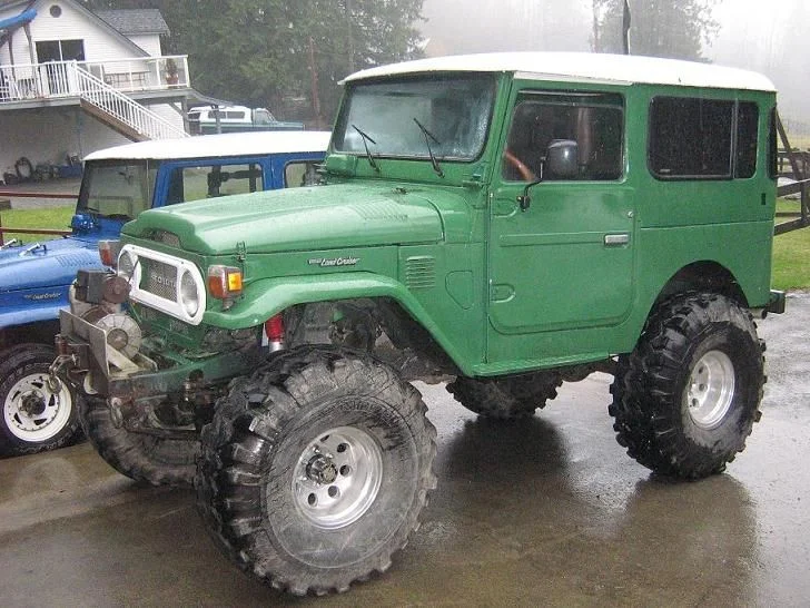

This is mine on 39.5 Iroks. still got the stock 40 axles. Upgrading to 60's soon..

Yep, 27 spline longs with chrome moly inners. Stock axle shafts in the back.

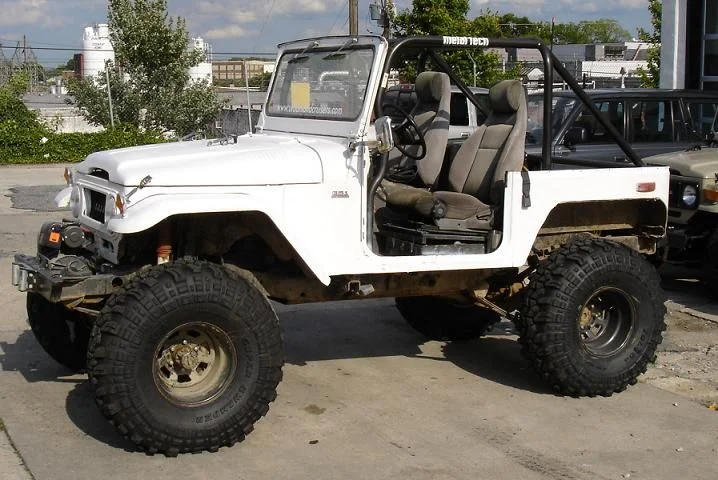

Here's mine on 38.5's. Stock axles plus longfields. SUA. Hood up as usual. I run 37" Irocks now.

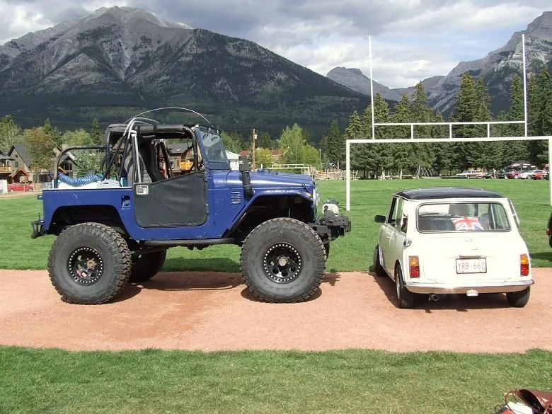

40's
here's mine on 40" MTR's

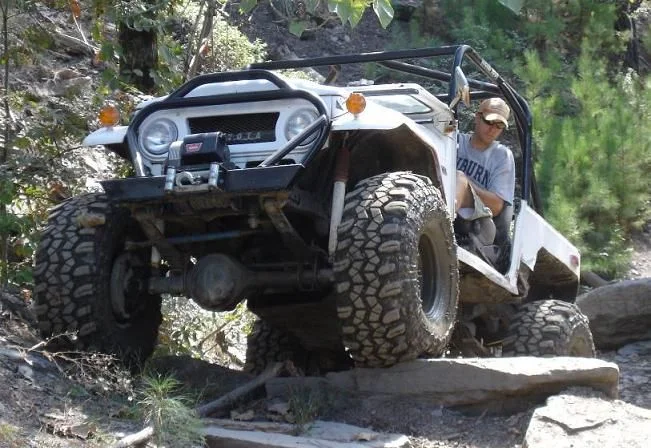

38.5 SXs on 15x10 x 2"BS
SOA ft w/ flipped 40 springs
SOA rear w/ flipped fj60 rear springs minus 2 leafs

I am running a toyo pickup transfer case. The t-case has Marlin 4.7's in it. The rear has a welded 4.10 gear. This rig is new to me in the last few months, so I have not done much with it yet. By the looks of it though, it has been through some tough stuff.

BJ42 on 40's front and rear lock rights 5.29 gears, 27 spline longs
