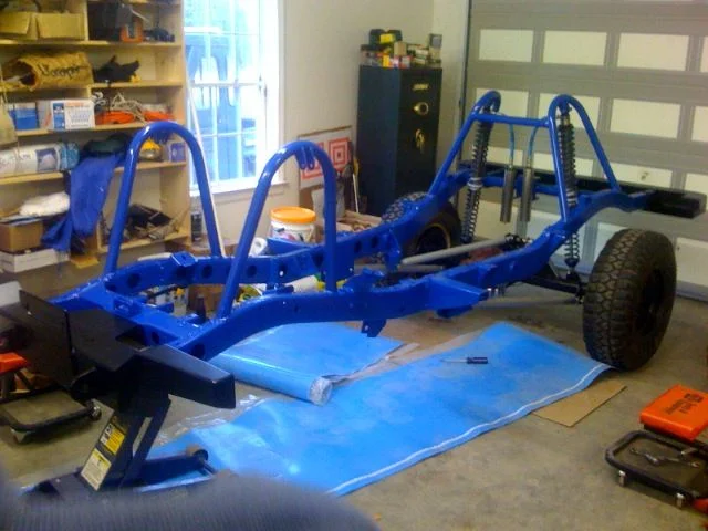

this is were im at so far. i am testing the frame to make sure i didn't forget anything then it goes off to get galvanized. the body isn't the one im using. i will be getting a new 3/4 tub because this one the p/o tried to fix it by putting bondo over the hole thing and fiberglass.

the pic

I am a bit concerned with your suspension set-up. I think you should have invested in some 60 series axles with Longs (at the very least) & relocate your coilovers. Forget 46's it will never happen with your set-up & wheelbase (especially if you consider it to be a rock crawler, I think 40's are going to be pushing it. If you are stuck with the 40 axles I would look at notching the frame maybe.
What wheelbase have you got & have you even considered this ?

I have added onto the frame and if I remeber right the wheel base is 97" I probly will change the axle at some point but rite now I have to spend my money on getting a new tub

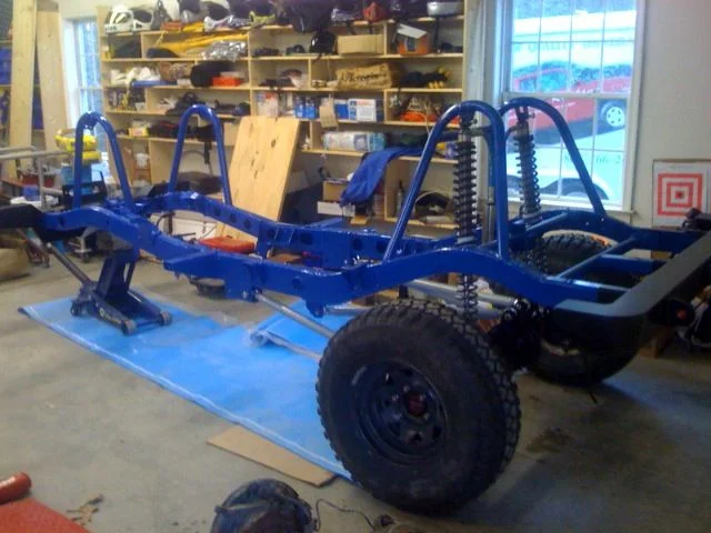

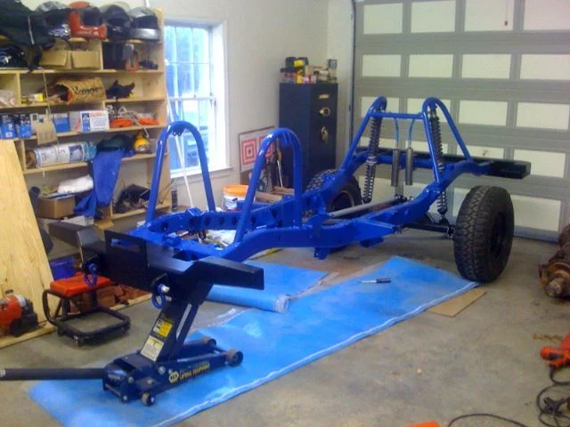

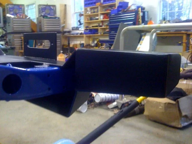

ok well here is the update so far. i have finished all the welding on the rear axle and am waiting on the longfields to come in. i have also finished the front bumper, rear bumper and the frame which is now in the posses of getting galvanized. i have my rear 1/2 tub and have chopped the rear bed of the original body. i would like to know how people clean up there tubs? i am thinking of taking everything off of it and getting it sandblasted what to you think?

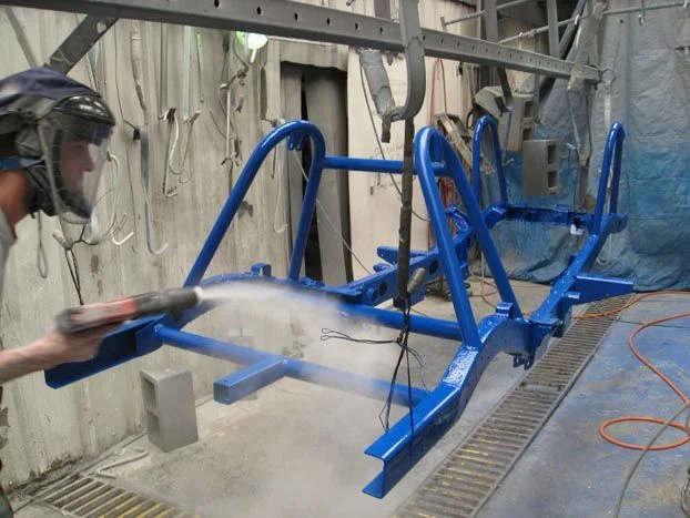

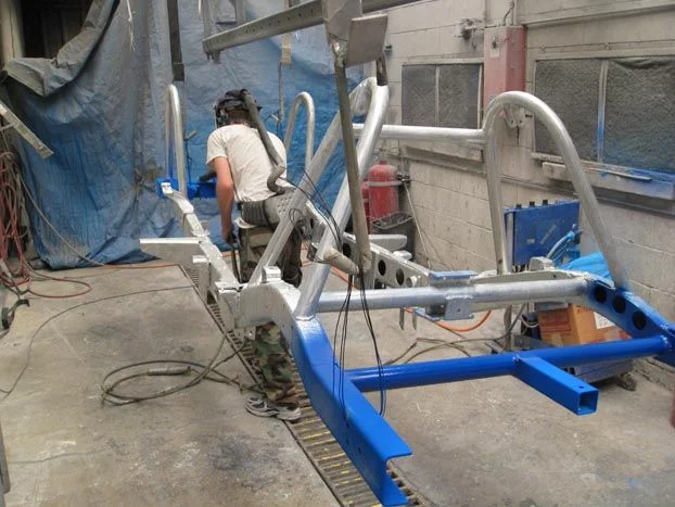

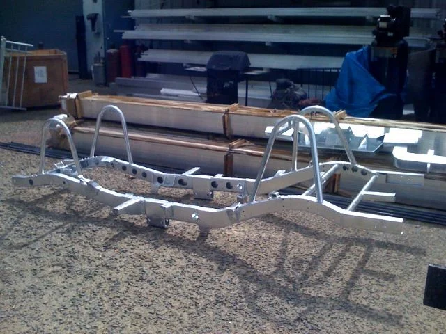

well i got the frame back from the galvanizers yesterday i sanded some spots were there was lumps of the galvinize then i prepped it for powder and got it powder coated unfortunately i had to leave before i could see it after it came out of the oven but here are some pics of it so far

frame is going to stand out alot lol.

well i worked most of the day today. i put my axle back together with longfields in them and then started bolting them to the car. put on the rear shocks and front and back bumper. i really like how it all turned out!!!

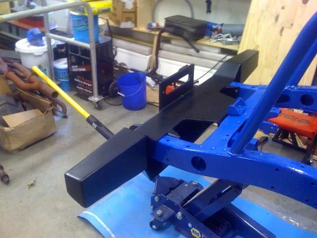

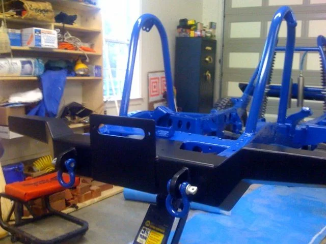

a few more

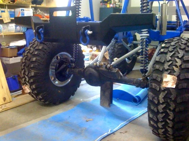

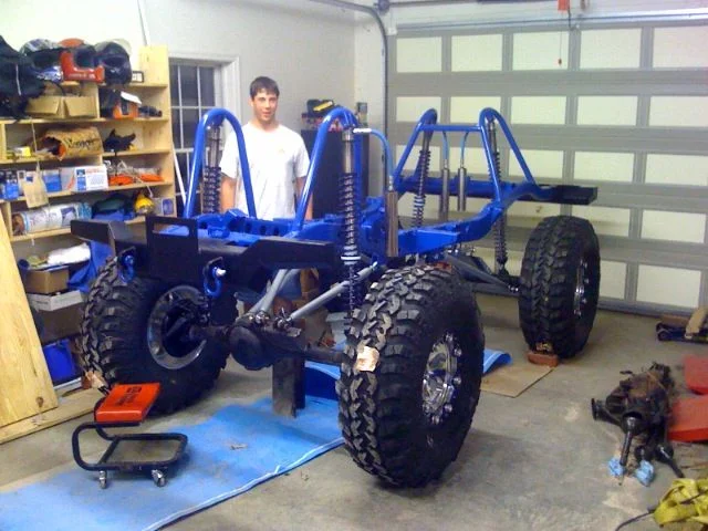

well it been a little bit i was having trouble with the front axle but i got it all ready with new longfield axle shafts and disk brake conversion all done and its sitting under the land cruiser. i also got rims and tires i went with 39.5in iroc tires and 17in champion beedlock rims.

I see future axle breakage. those spacers will put tons of added stress on the knuckles and rear shafts.
Other then that all looks really good.
