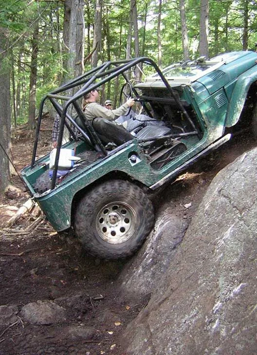

This isn't where I broke but same day it gets wheeled and I like to hammer on it. So you think that an arb would be my best bet for a cruiser axle. Thanks

Mark was trying to get up on a ledge when he had all four tires smoking with that stupid tractor motor when he grabbed second the rear just kinda clunked and then stopped turning, very unimpressive. When we pulled it apart it seemed that the center pin had sheared taking out the carrier. Would it have really mattered if the side gears & Drivers were or weren't shimmed properly? I never liked the idea of mixing a lock wrong with a single center pin and 37s.
Don't waist any time, effort, money on the offset rear when you still have a turd cruiser transfer case and you know you want to do front burns.
Would a trussed mini rear with a v6 carrier hold up? (Keep in mind that Mark's cruiser is not obese like many are)
