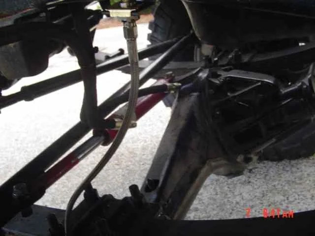

Lots of options, I run a TJ box that I ported, and a box out of an AMC eagle. I bought the ram, hoses, tabs and fittings from PSC. I run a 1.75" ram. Works very well, it is a little slow but a higher volume pump would remedy that. It is one of the best upgrades around for a rock crawler, eliminates possiblity of bump steer, all that said I wish I would have just done full hydro but that is a different can of worms.
Here is the best pic I can find of my setup at the moment.

Yes it's safe on the road. You can see in bustanutley's pic that the hydraulic ram is attached to the tie rod. None of the original steering components are removed. You just add the ram to the system to "assist" your steering. There are several people on here that you'll find through searching that have and really like this set-up.

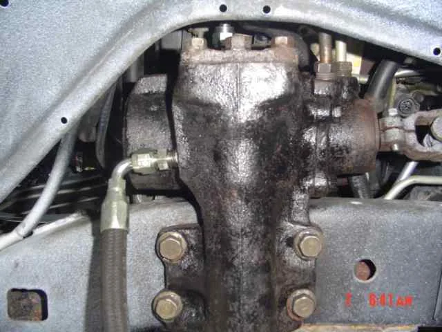

Here you can see my set up on my 60. The thing is the steering seems to be a little sluggish at low (rpm) speeds.... Do you think that my pump is not up to the task?
Thanks.

Posts: 10,873
Quote:
Thanks.
Tom
With a 1.5" ram, yes..
A better pump will work wonders..
