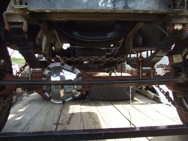

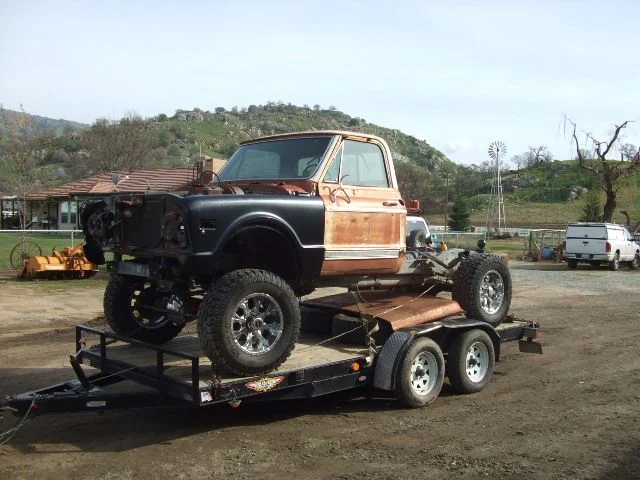

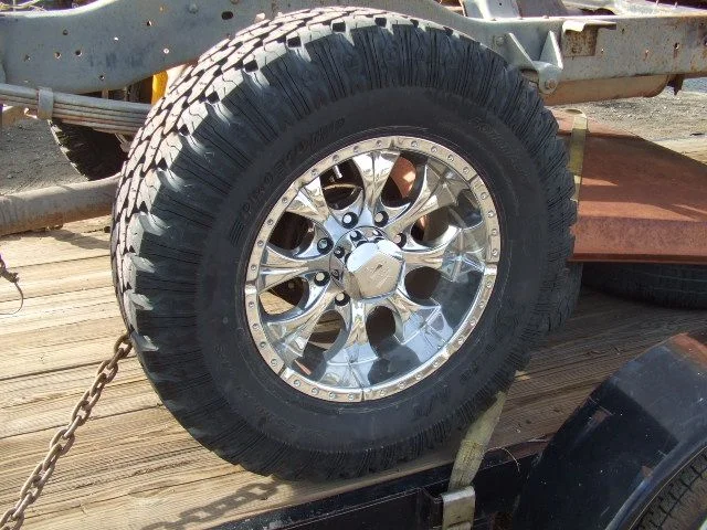

Load Range "E" Rated Procomp Tires and some fancy smanshy 17" wheels.
Not my first choice but they were take-off's from another guys rig and the price was really good. Quite a bit less than black wagon spoke steel wheels and 35" BFG's in a load range "E".

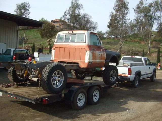

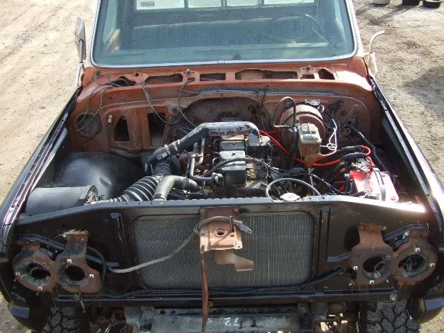

A few more pics.

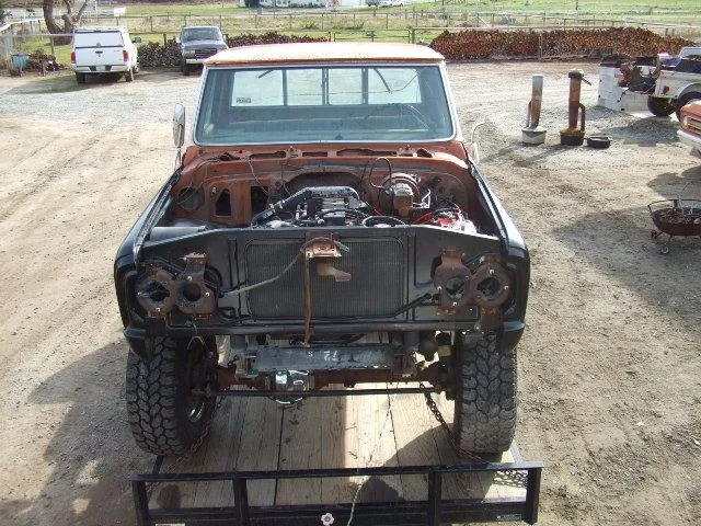

Front View.
