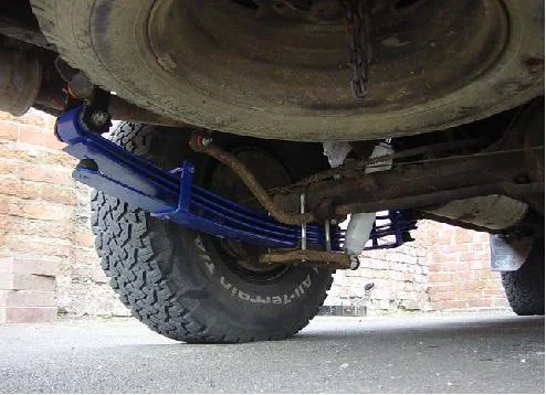

I did fit Parabolics to my 60 and bought from this company. If you go to the 60s section and look at the FAQ thread at the top, my thread on parabolics is in there.
The springs fit, the company was very helpful and the ride / lift is nice.
