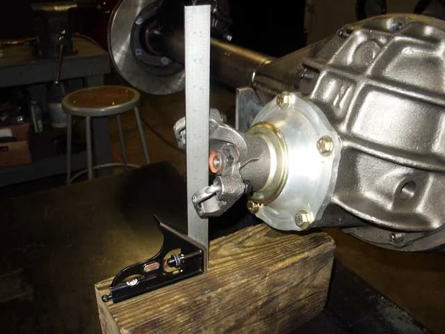

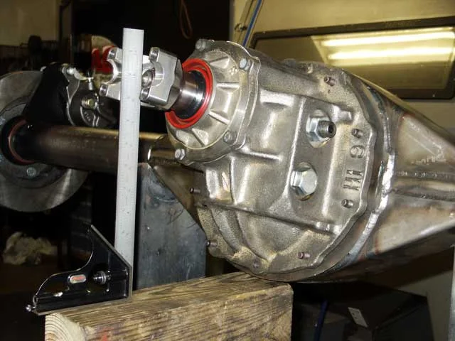

Here are a few pics. I agree with Grogan, If you can get away with (or do not need a HP) a low pinion 9" in the rear, that is what you need to run.

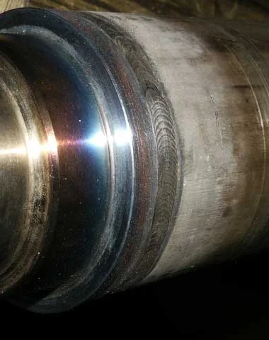

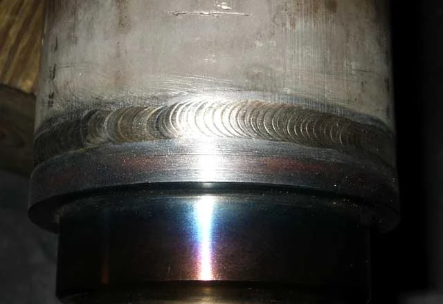

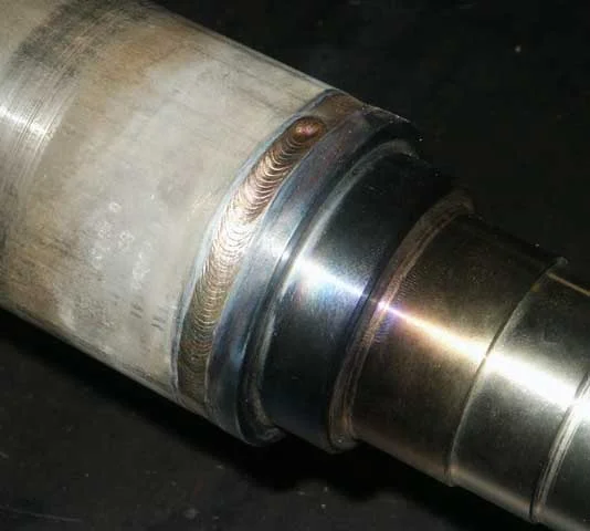

Quote:
Originally Posted by Super 70 View Post
Mad Axle Housing (offset pinion for LC Tcase)
Full Floater
64" axle width
Cheers!
Rob
I couldnt resist

Those welds look like Crap
Overkill for sure! im sure a properly Setup CV Drive shaft would be vibration free, but if you got the cash, go for the Bling!
