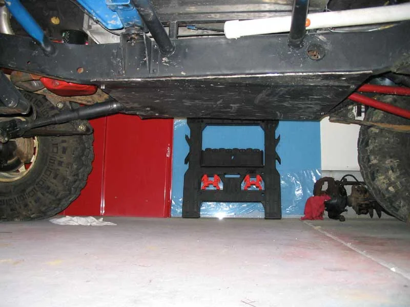

My skid is 3/16.. it's supported by 2 crossmembers, and the frame rails. it bent badly when I had it unsupported (initially had it hanging down at the back 1.5".
Once I tucked it up tight to th frame rails, it's holding up well, and it's something like 30x36"..
