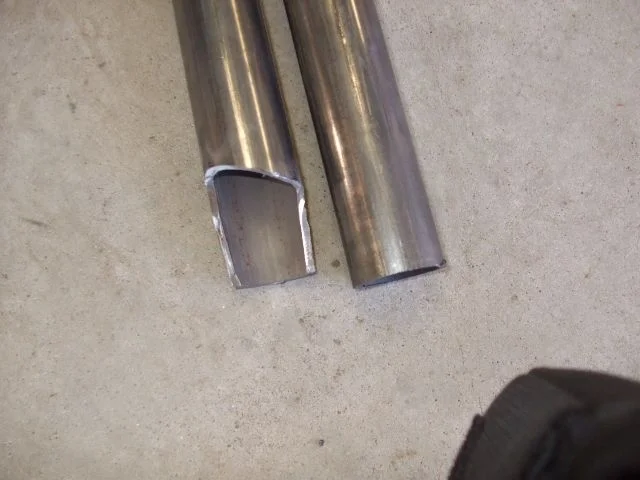

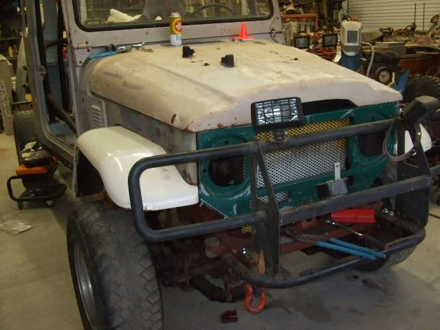

I quit thinking about mounting the fender and just started doing it.
Don at FC Fabrication helped out with some ideas and some hoops.
I did the custom cut and grind to match the contour of the frame.

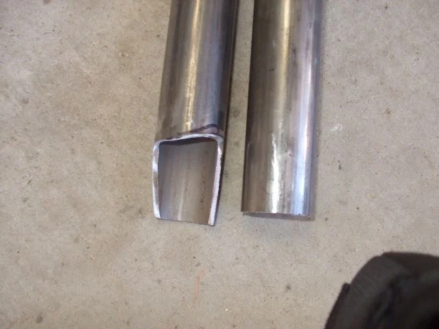

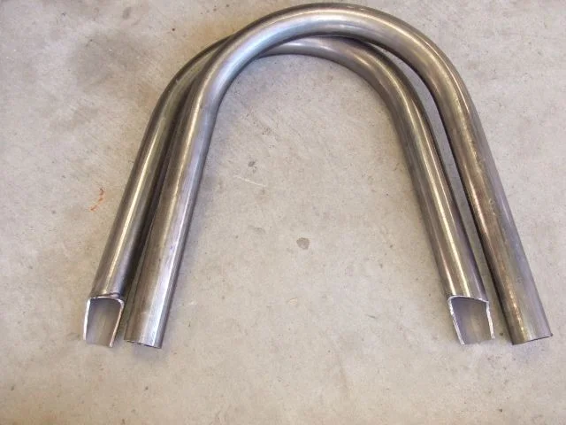

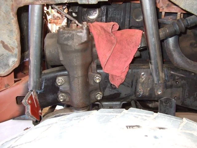

Here is how they mate to the frame.
Don't laugh but I could not find my C Clamps that I use for welding.
The top inner edge of the fender will attach to the hoop.

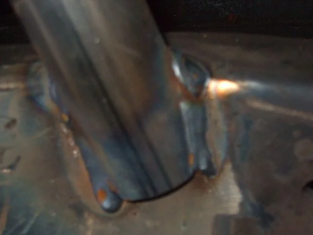

Can anybody else tell the difference between my welds and Don at FC Fabrications?
It really sucks when you wife tells you that you suck at welding.
(I never had this problem until she saw Don's welds on the cage. She said mine don't look like creamy butter.)
WTFDSK
LOL!

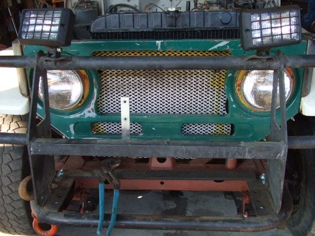

Sneak Peek at the fender that MeGolfer donated to the build.
It is almost 100% installed.
Landcrusher909 threw in the turn signals for the build as well.

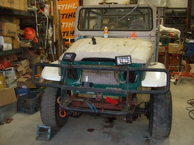

I got most of the passenger side done tonight.
Here is the way it sits now.

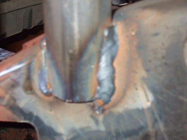

Quote:
Please cut those off and plate the frame in those locations. The load will rip them square through the frame rail like this:

WOW
I guess I will. Thanks for sharing that info and pics!
Quote:
Cruiser frames are a bit more robust than that..

notching the tube to saddle down the side of the frame spreads the load and distibutes it across two planes. I have done litterally dozens and dozens of tube towers this way without incedent.
.... now welded on a single plane? specially on the top with less than 4 inches of weld? definate can opener!
bottom line, more suface area the better! more planes to a joint, the better!

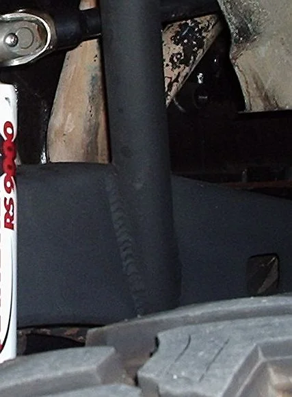

kinda like this one I did on a 55 about 4 years ago. 6,000 lbs of pig that has a bad habit of trying to fly (pismo)
the axle mount folded over before the tower failed. ......
sweet! besides welding the hoop to two planes like FC mentioned, i bet bumpstops might help a little as well if the shocks were bottoming out.

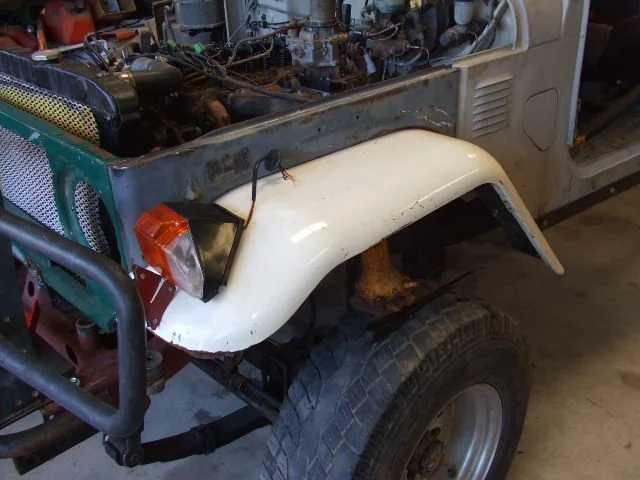

My 40 took way too much time yesterday
I was able to get this done.

Damn that is coming out great! I was dreaming about just such a project

I rn out of Oxygen on the gas Ax so the front bumper is still on there.
Grrrrrrrrr
