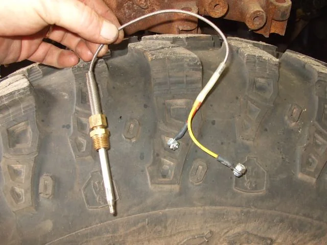

I have the EGT probe in the back exhuast downpipe
um . . . no comment

Originally Posted by D'Animal
I have the EGT probe in the back exhuast downpipe since it is the hottest part of the exhaust.
means post turbo .. ?
Diferent engine .. but I cruiser my 1HD-T around 700 - 800ºF pre turbo pushing 9 - 10 PSI @ 2000 - 2200 rpm

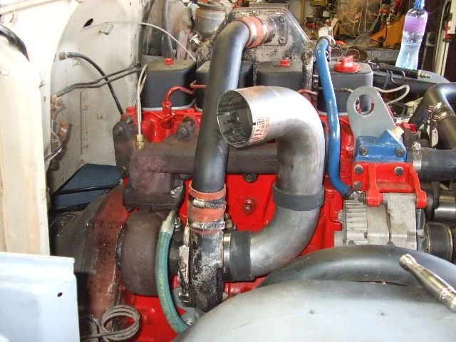

4 will let the engine breath real easy, and at ebay prices not break the bank. New the cores are $212US each. 4 will be good for up to 600hp
Intake temps will then look like this. Blue pre turbo and green post intercooler.
Colder intake temps mean you can add more fuel safely and sustain lower EGT's for longer. Adding more fuel means more power.

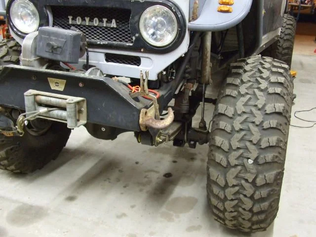

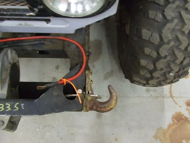

Before I go to the trouble of mounting them, what do you think?

Looks good Dan!

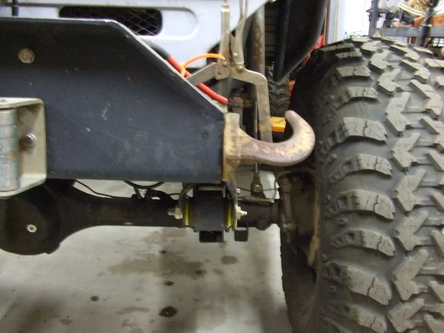

They're out of the way as far as approach angle, and would mount direct to the frame. Seems like a good choice to me.

dont weld them, just my 2 cents though.

They would be bolted on using 7/16 Grade 8 bolts.

bolts , i like bolts. big plus is if you decide later ur not happy its just a few minutes work, not a hour of grinding and totching.

I love the tow hooks bud! At least they look cool mounted like that, I think they'd work great. Not sure if they would fit on my rig for various reasons, but I might steal your idea.
Super cool rig, I am jealous for sure!

The tow hooks came off the front of my 1942 Chevy M6 bomb Service truck. I sold it but kept the hooks and the blackout light. The Blackout light will be mounted so it will light up the bed/cargo area.

I was thinking they might have come off of a train

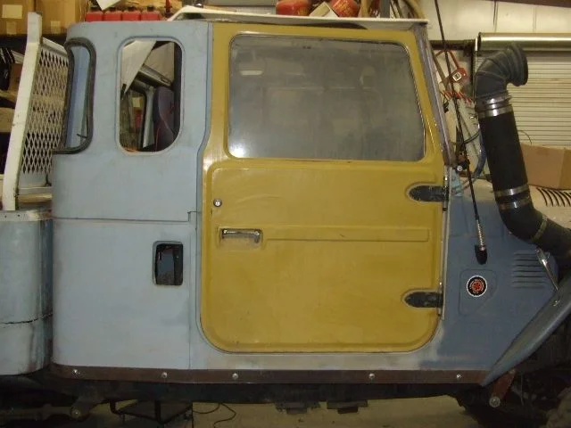

I really need something off of an FJ 55 to complete the entire collection on one rig. LOL

I have a piece of dash trim you can have

I think it would be cool to stuff an FJ55 grill and headlights between the fenders and hood of an FJ40.
Can somebody out there photoshop this idea?

not a bad place for the hooks i reacon. dunno how much of a problem they may or may not be coming up to a rock, prolly not much of one in relation to the tires position tho.

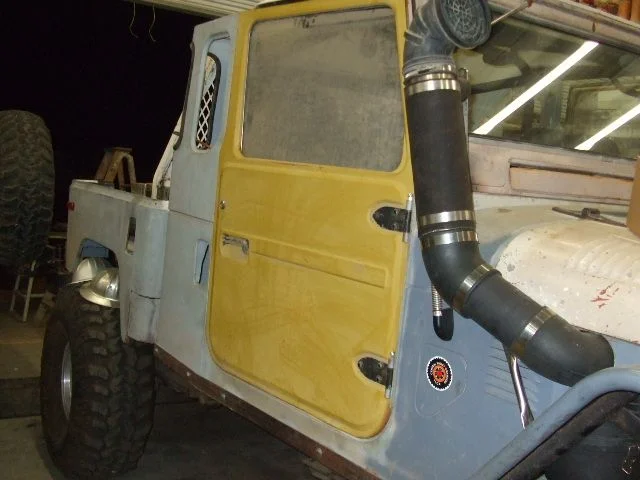

Proper doors are installed.
