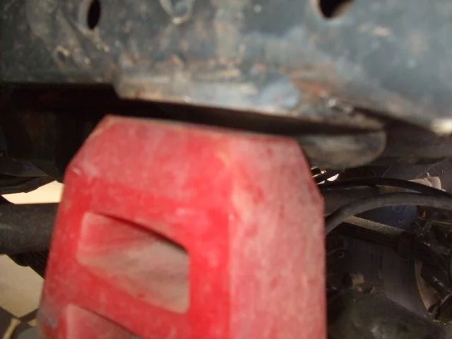

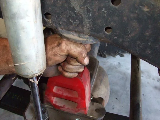

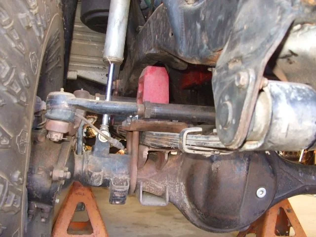

I got a few things done this afternoon.
This is how the bump stop sits after 2 wheeling trips at my rock park.
The TOP of the front winch mount bumper/crossmember is 31 1/4" from the ground.

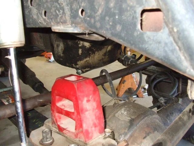

This is how the bump stop sat after 2 wheeling trips at my rock park with new stock FJ 60 springs.
The TOP of the front winch mount bumper/crossmember is 33 1/2" from the ground.

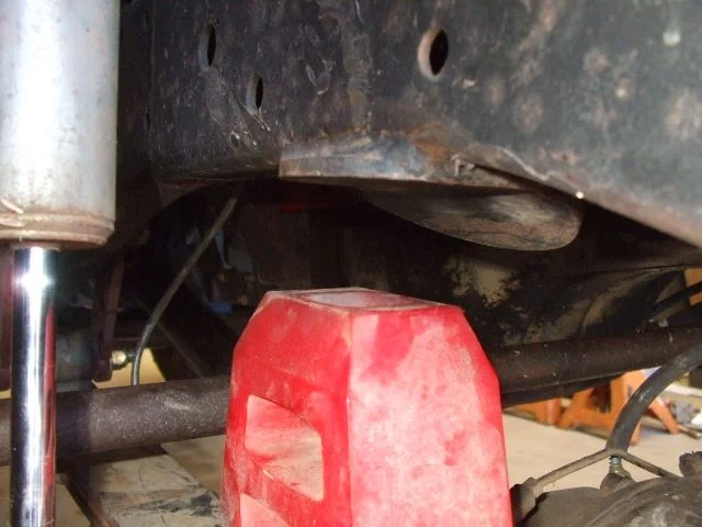

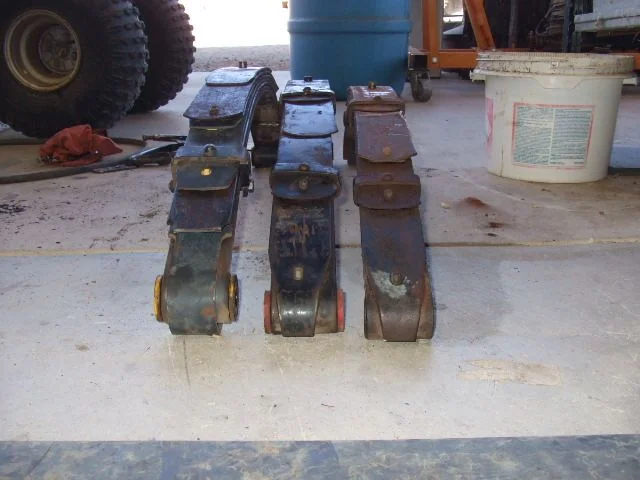

I called Kurt at Cruiser Outfitters and talked Spring rates.
I took the CS 003 spring off the Beagle Chariot..........
Quote:
Originally Posted by Mace View Post
Go add a leaf to your spring pack
..............and cut apart the flattened out springs. I cut the second from the main down and added it it as a 3rd from the top spring. I also slid in an extra 3rd from the bottom spring.
Bump stop looks real good.

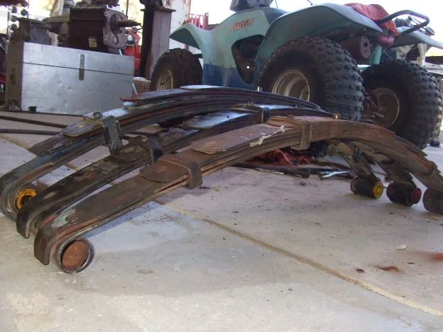

Before with the new FJ 60 springs and after with the OME CS003 and two extra springs.
In the bottom pic you can see the springs I added.

Here are the springs next to each other.

So you are running OME lift springs now? Your lift looks about right as does the travel to the stop. Any pics of the truck as it sits from the side?
I'm curious as the build progresses on my FJ60.
Good thread.

Steering rods still have enough clearance, even when turned?

ToyotaDon
That rust colored piece of metal you are seeing under my steering arm is actually the spring plate.
The space between the top of the spring pack and the steering arm is 3/8" less than it was before adding the two leafs.
I will let you know if it rubs next sunday night.

I don't know what you are building but unless you are going to add an additional 600lbs to the front of your rig, you probably do not need the lift or the additional leafs.
I am getting axle wrap going down steep grades. The axle wrap is collapsing the springs.
Quote:
Good thread.
OME
CS 003 is a lifted spring
CS 004 is a lifted spring and it is designed for 200lb extra load. (Bumper)
CS 005 is a lifted spring and it is designed for 400lb extra load. (Winch and Bumper)
I basically made a CS 006 and used them.
I will order a set of CS 004 and U bolts from Kurt this morning so I can put the Beagle Chariot back together.

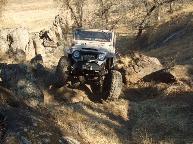

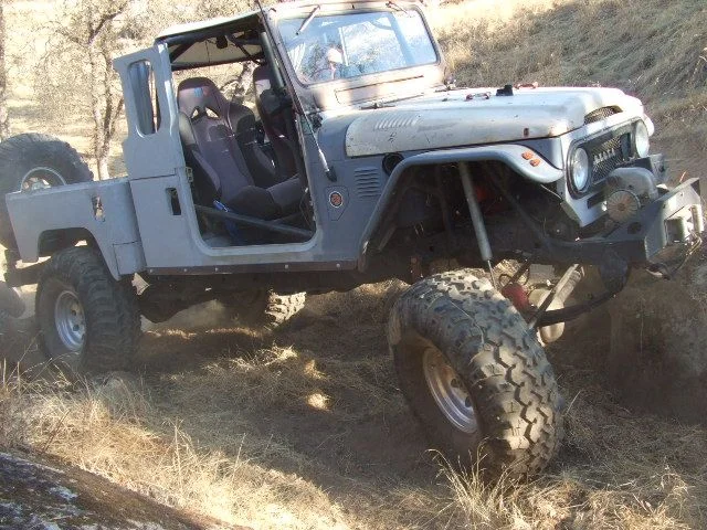

Had a few good friends come out with thier Built rigs and we made some new hard(er)core routes. Wheeling in the dark last night and right after breakfast this morning.
I lost 1/2" of height on the front bumper after wheeling and saw some steering rubbage. Time for a Cut N Turn.

Are the exposed tires going to cause you any grief with the LEOs driving it up to AK?

I dont know.
Istill have to remove the wheel spacers and install fender flairs and mudflaps for California.
I figure if it passes California DMV inspection, it should pass anywhere in the world.

Coming up the canyon.

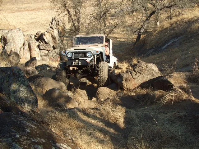

Not to the top just yet
