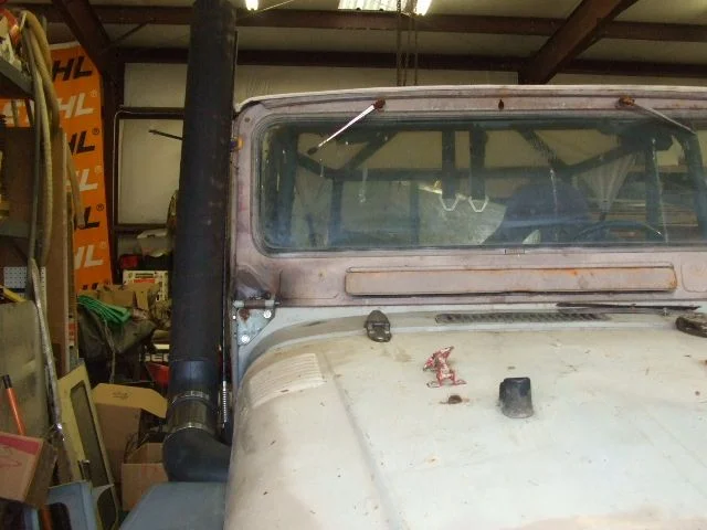

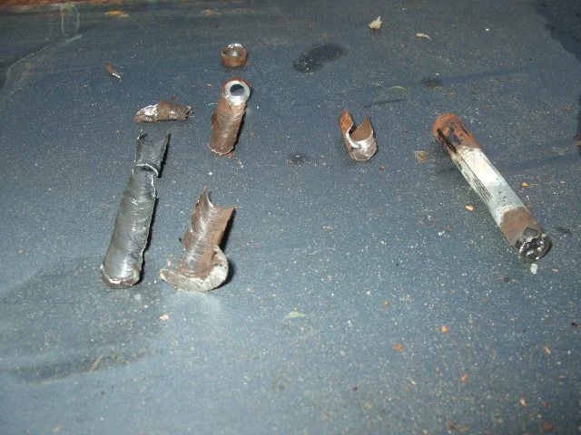

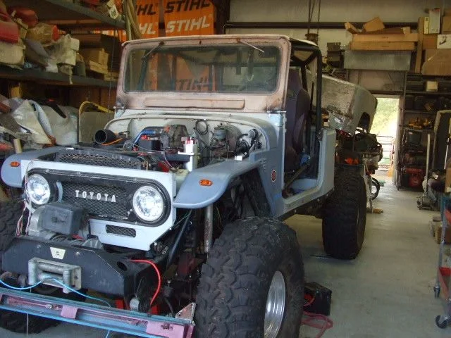

Removed the Windshield frame from my 1964 FJ 40 Carcass.
Drilled out the hinge pins after I broke 3 tips on the impact driver trying to get the screws out.
Mounted the windshield frame on the rig.
I still have to get new pins.

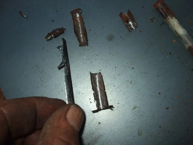

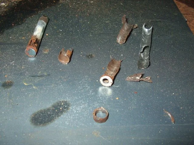

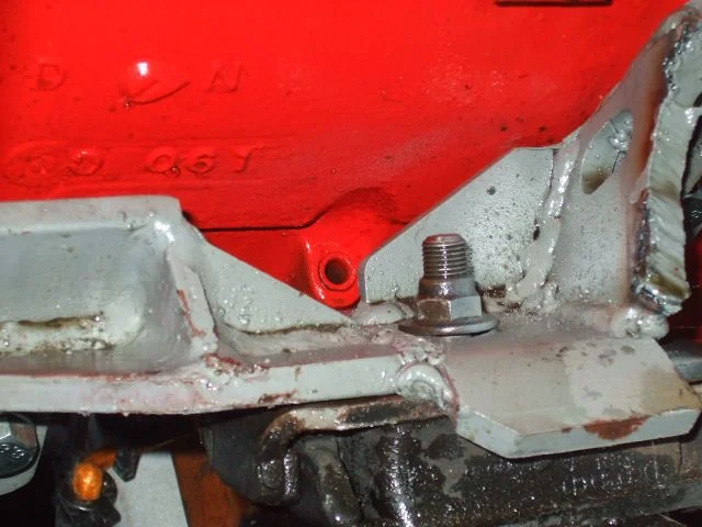

Pretty happy with my drilling out the pins.
I only went through a couple of drill bits.

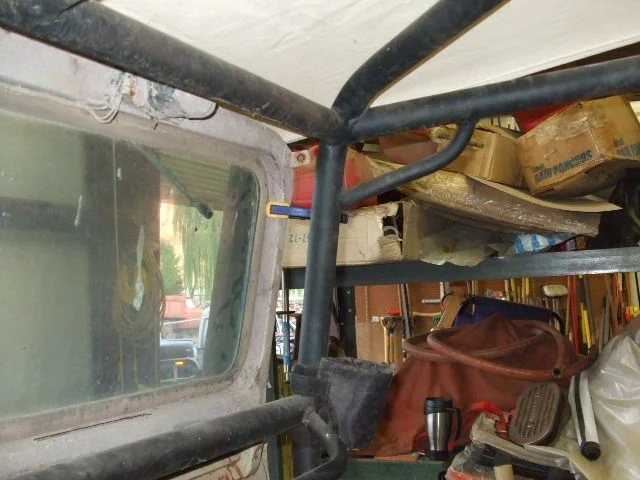

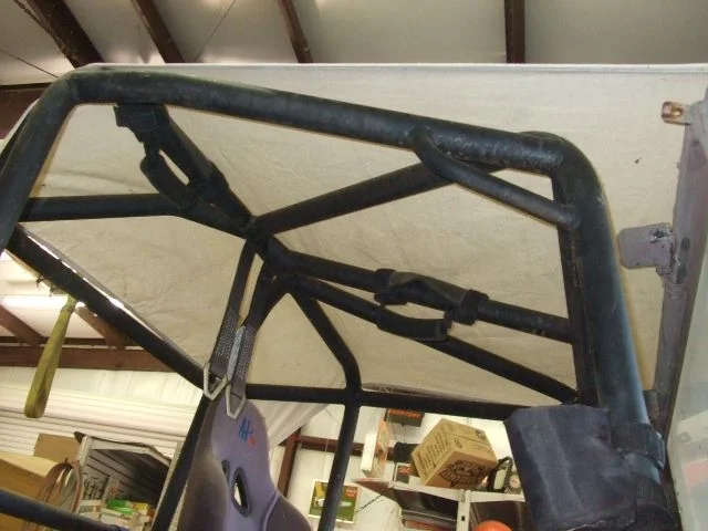

Threw to Canvas top on to make sure it was going to fit.

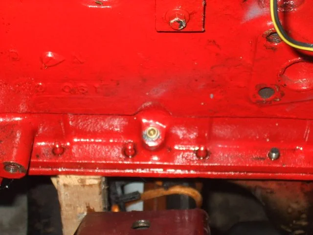

I have almsot every fitting I need.
Except the one on the pressure side of the box.
It is where the white cap is. It is a different thread than the others.
Watch for caviatation on the feed line to the pump. Those right angles make it hard for the fluid to move as fast as you may need.

BTW, smokin job drilling out the hinge pins.. I have NEVER been able to drill that straight!
That's some good aim right there!

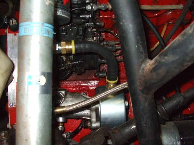

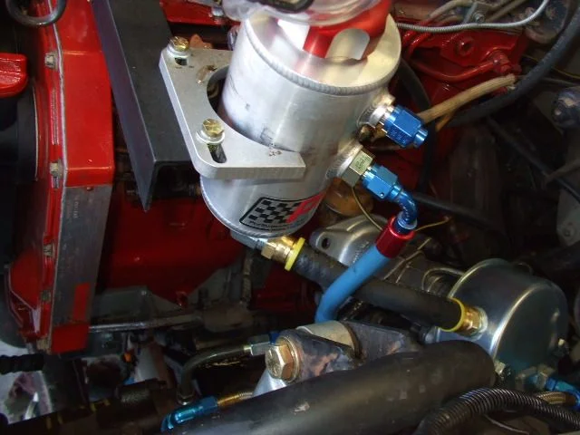

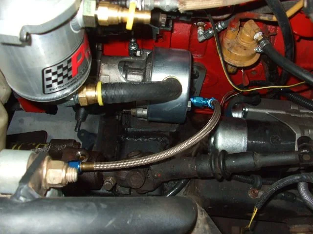

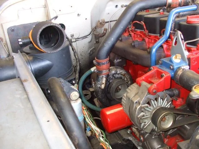

Installed the pressure hose from the pump to the steering box.
Quote:
Originally Posted by Mace View Post
That #6 hose pressure is not big enough for the steering box and the hydro. You need to step up to a #8 hose.
Or at least I would.

Here is how the return line looks.
I pressed a spring inside the hose the full length (nipple to nipple). The hose is similar to 5/8" heater hose size and the spring is snug in the sidewalls.

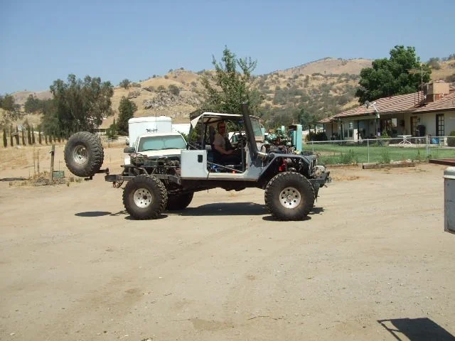

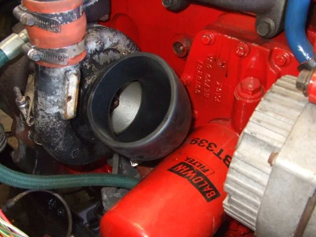

Worked on the air intake.
Before
During and after.

Mocked up the Snorkle as well.
The bottom picture is from the drivers seat. Does not block the view.

It is a real functioning snorkle/cold air intake.
Quote:
Originally Posted by mrqtipp View Post
Snorkle... are you going deep sea wheelin
ACT 2010 is the reason but dusty trails in this area is the secondary reason. Hopefully I will get this on the trails this year.

Garage

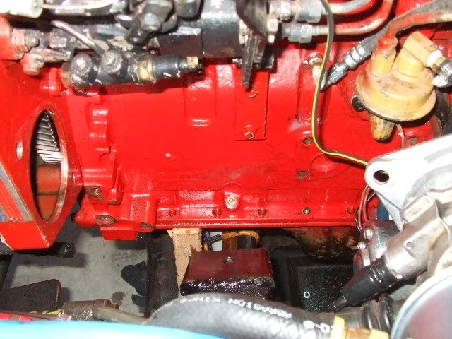

After going to 2 Auto Zones and 4 Napa Stores and Oil distributor and even Walmart, I found nobody carriers Synthetic Power Steering Fluid. I had to use conventional Power Steering fluid.
After 2 trip to the hose and fitting store i got the power steering hoses I needed. I put everything together and added oil to the power steering pump.
I started the engine and found I still had a major oil leak in the area behind the Wabco.
It seems the PO added a gop of sylicon to an oil drain hole. You know, the one behind the engine mount bracket and below the injector pump.
I guess the new vacuum pump or maybe just running was enough to blow it out.
Off with the power steering pump, Wabco Pump, resivour. Jack the engine up and take the actual engine mount off.
Remove the broken off piece of pipe, tap and install a pipe plug.
I hope your Sat went better.

That drain plug looks like it was a PITA to get at, but at least it's fixed for good.

Quote:
It was.
The engine mount and bracket had to come off and out. I just finished doing the repair and it is all buttoned up.
I really hate that its maden voyage will be done at night so I cannot video it.
(can someone PM the shift pattern of an NV4500)

Wahoo!
Not completely done but almost ready for a shake down wheeling run.
I forgot to connect the brake booster to the vacuum pump and a few other little things.
