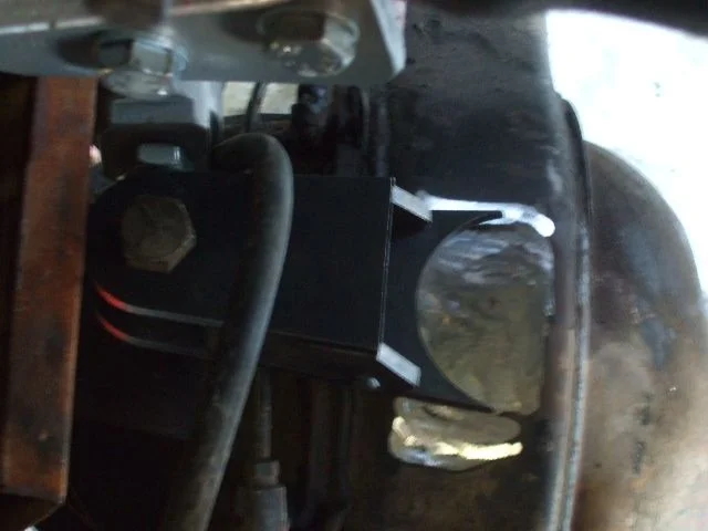

Dan,
sent you a text message . . . your front U-bolts, from the pics, it looks like you just made new spring perches and used conventional U-bolts (U shaped) to hold the axle to the springs. Can you post a few more picks of this?
Also, what was your pinion angle and did you use Marlin's Hi-steer arms? Since we have the same front end, I need to get some arms for my rig.

Check out post #495 on page 17.
RuffStuff SOA kit
4x4 Labs Steering Arms
My pinion angle will be different than what you need since I am running a shackle reversal and my front springs are moved.
Quote:
Originally Posted by slickrock View Post
Dan,

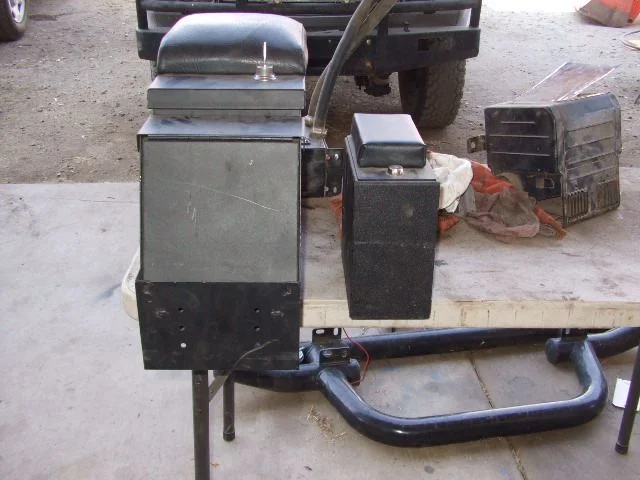

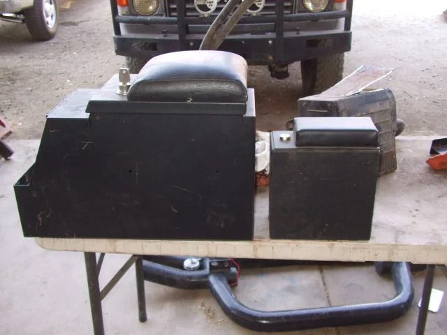

Arm rest got upgraded this week.
Little one is going away to a new home.

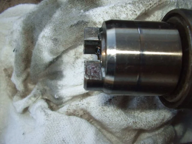

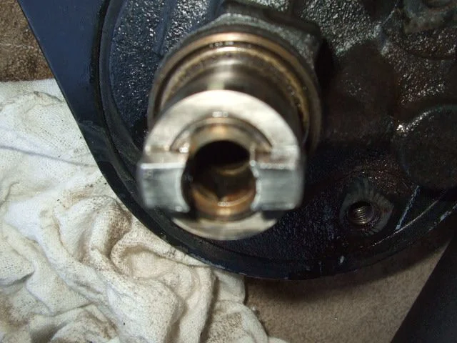

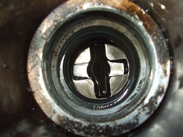

Started on the steering and had a bit of a set back.
I had a slight oil leak from the pump area. I thought I did not tightten the oil feed line to Wabco or something. Nope!
I pulled the assy and found the seal was cocked in the housing causing the oil leak.
I also noticed the drive gears were really worn.

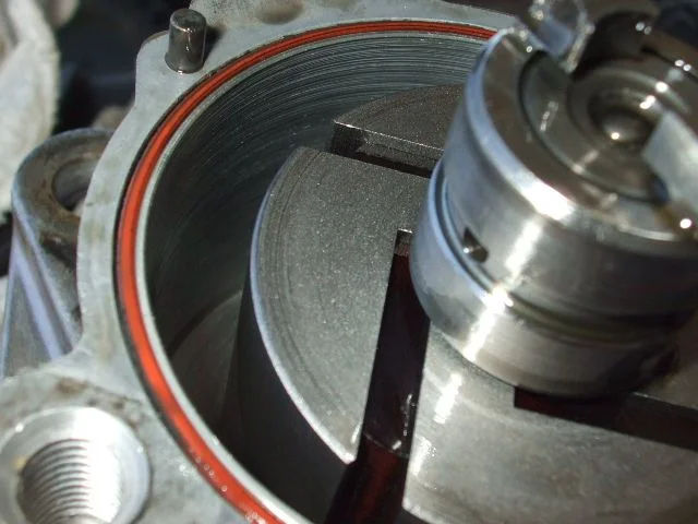

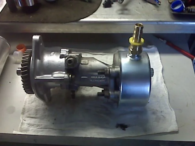

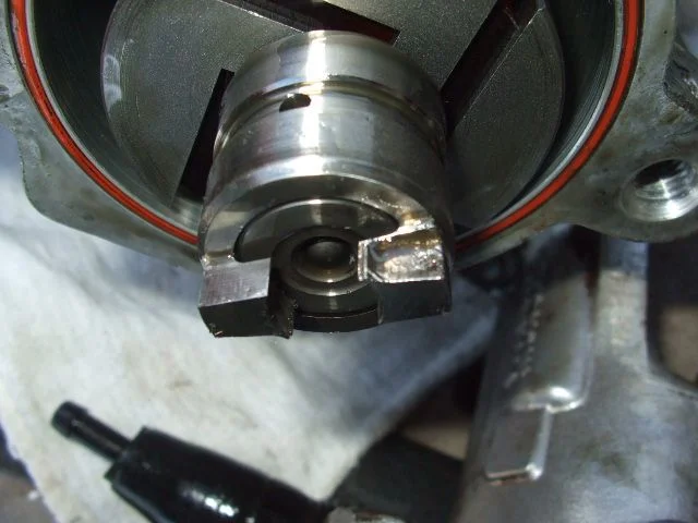

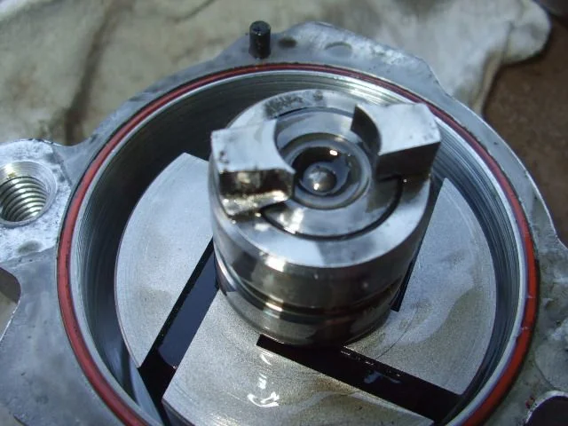

The vacuum pump is worn out as well.

Lots of life left there! Its only 1/3 worn through

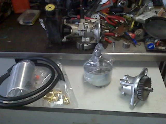

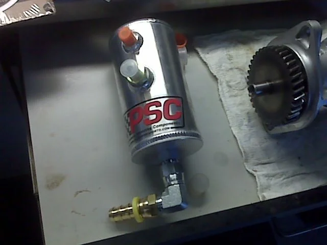

Got my parts.
In between dog duties and mucking horse stalls, I got it all rebuild and ready to install.

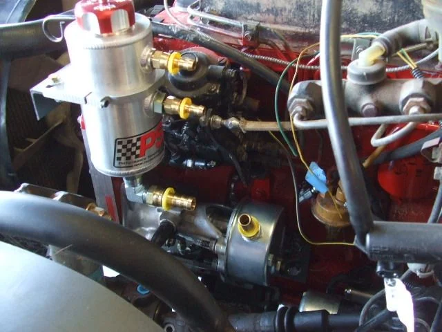

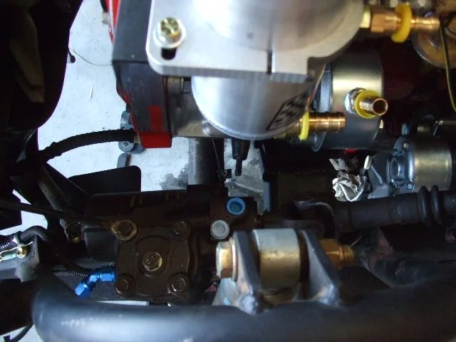

The pump and res part of the system is mounted.

I have almsot every fitting I need.
Except the one on the pressure side of the box.
It is where the white cap is. It is a different thread than the others.

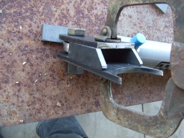

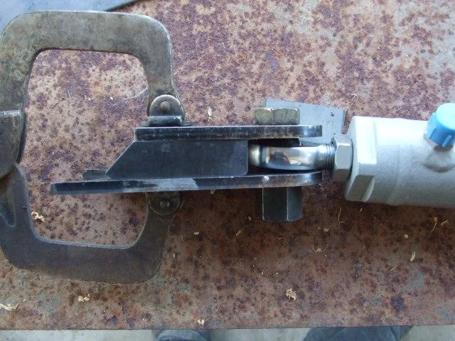

Diff mount of the hydro ram.
It is not done, I have to make the bottom tab piece that actually goes on the 3rd member.
Yes, I am copying Woody's proven design.
http://forum.ih8mud.com/hardcore-cor...ro-assist.html

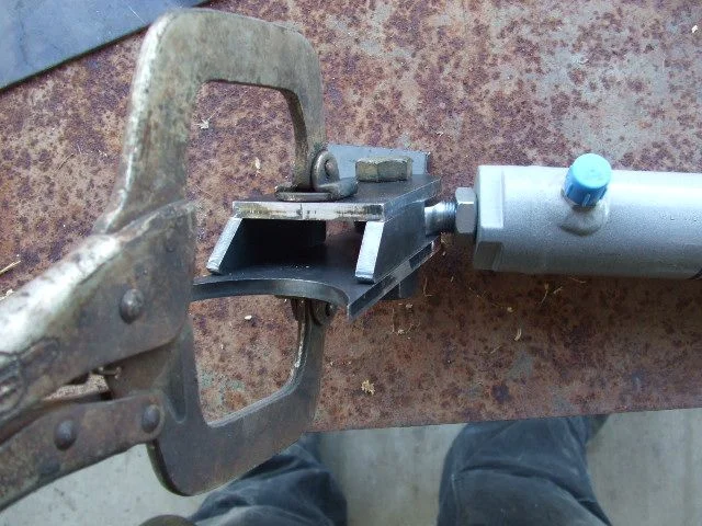

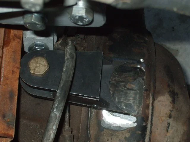

Mock up to make sure it is going to fit.
This is looking straight down on the diff.

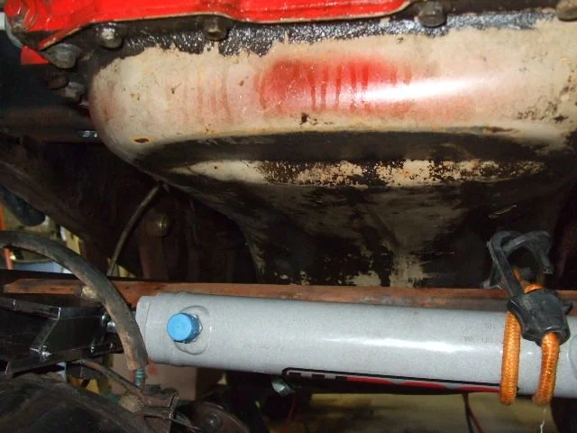

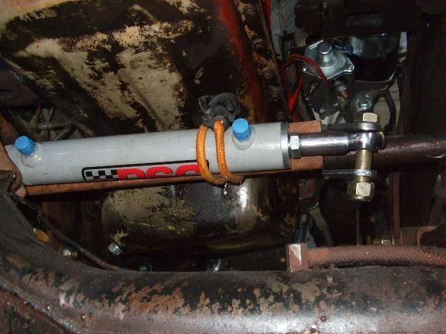

How the ram is going to sit.
Disregard the 1x2" that I'm using as a spacer and the bungie strap.

Just curious - how did you cut the arc in that piece? Hole saw, plasma and sanding drum or have you got a laser?
Spare part of another kit or just a piece you had lying around? Looks laser cut to me.

Spare part off of another kit for something else.
I wish I could Plasma cut like that.

just out of curiousity, is the 1" spacer going to be enough to keep the cylinder/mount away from the tie rod as the tie rod sweeps forward when turning to either side?

Very good question.
Quote:
I'm waiting till I get the power steering hose I need made so I can see how everything is going to move before I weld anything in place.

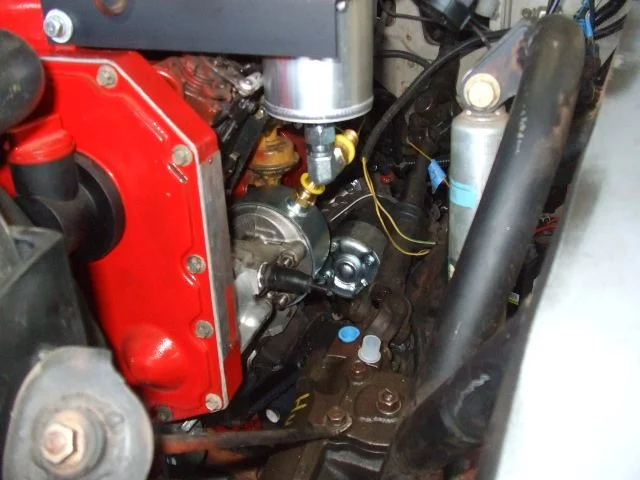

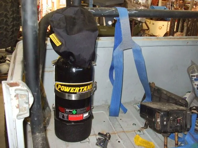

Got a few things done and erased off the board.
Remounted the Air Tank and the Viar 480C Air Compressor. I still have to wire it in.
Mounted the Power Tank.
