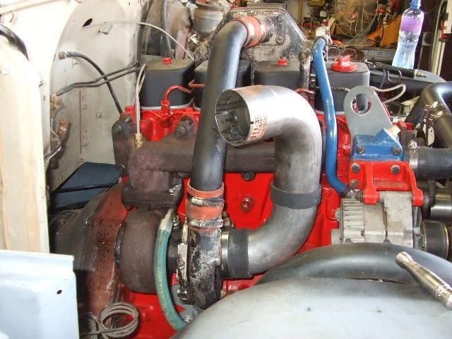

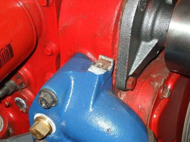

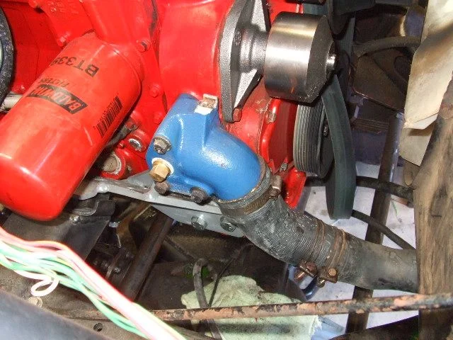

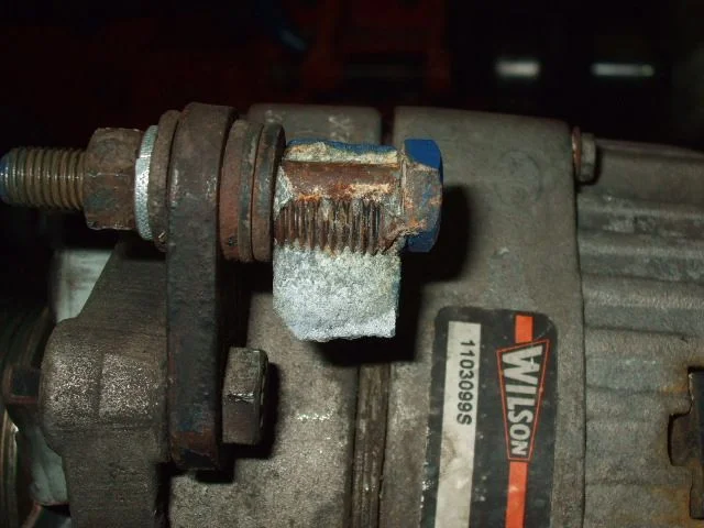

I ran to the parts store this morning and got a water pump. I removed the alternator and the old water pump, cleaned the surface and reinstalled the new water pump.
Took remove the alternator I just removed the top bolt and loosened the bottom bolt and pivoted it down. Upon reassembly, the alternator came off in my hand.
The PO must have drilled out the broken bolt (missed 1/2 the bolt) and then assembled. Half of the ear was cracked, you can see how deep the blue paint seeped into the crack in the picture of the Alternator.
I called Cummins West and then sent them pictures of what I needed. They are drop shipping a new water neck it to me and I should have it by 11:00am tomorrow. I was amazed how cheap it was. Around $52 to my door.

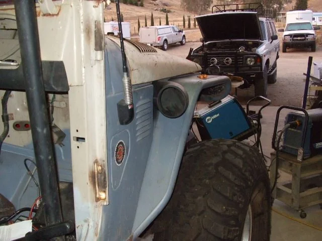

I'm about 2 days behind where I wanted to be. I wanted the exhaust on and the steering done by sunday. Might still happen but I am prepaired if it does not happen

Oh wow. At least you caught that crack before it became a bigger issue!

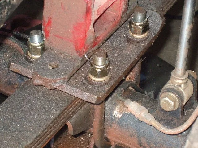

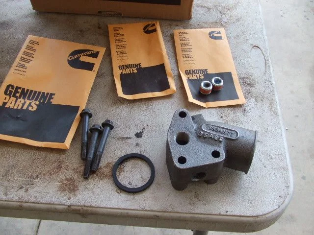

New one is cast iron, not aluminum.
Sweet!

I'm still blown away with thier service. I have bought a lot of little parts from Cummins West so they kinda know me. I called them with my engine numbers and they could not find that part on the IPL. They e-mailed me the breakdown. I took pics of the part and picked the part I though it was from the IPL and sent it back. They sent me a price and I ordered it.
It was shipped from Cummins Inc in Mephis TN and I had it 20 hours later. All this for $52.

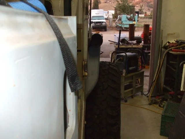

Back to the a lot of work but very little notice.
More wiring.

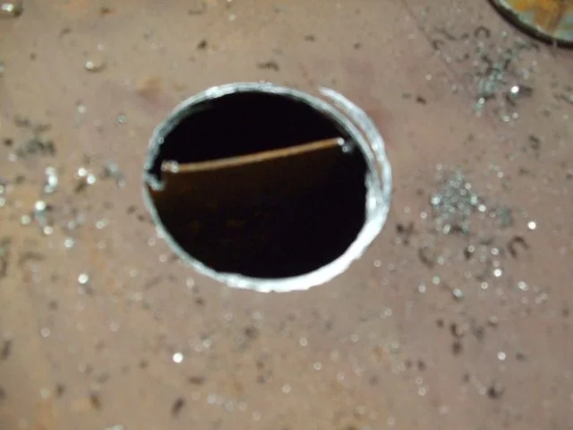

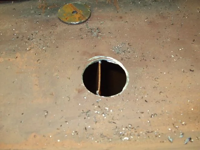

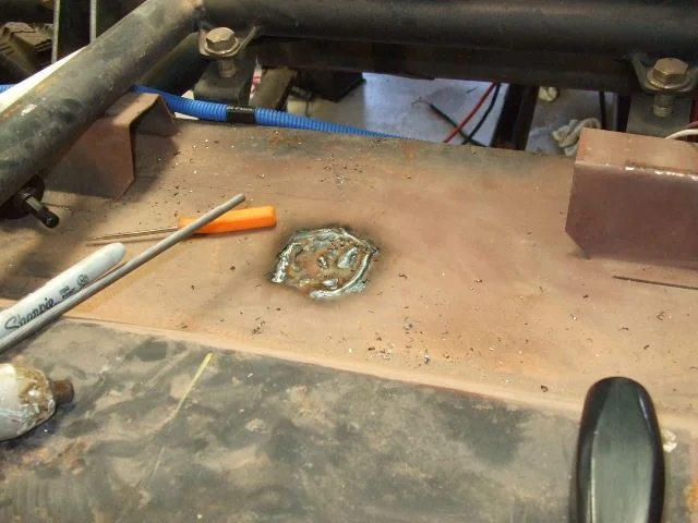

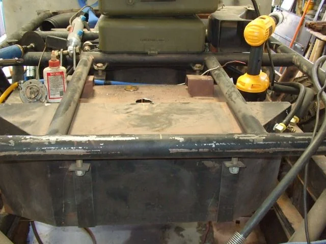

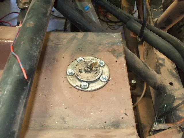

In case you ever wondered,
Yes Con Fer did put a Baffle in thier 22 gallon fuel tank.
When you put a hole in it for your sending unit, avoid the middle of the tank.

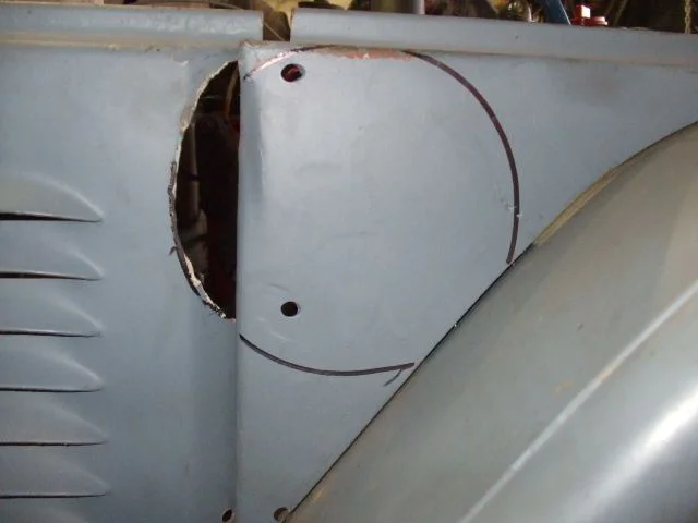

Im no magician so I cannot move a hole.
Weld it back shut, pressure test the tank to 12PSI (diesel) and then drill a new hole and install sending unit.

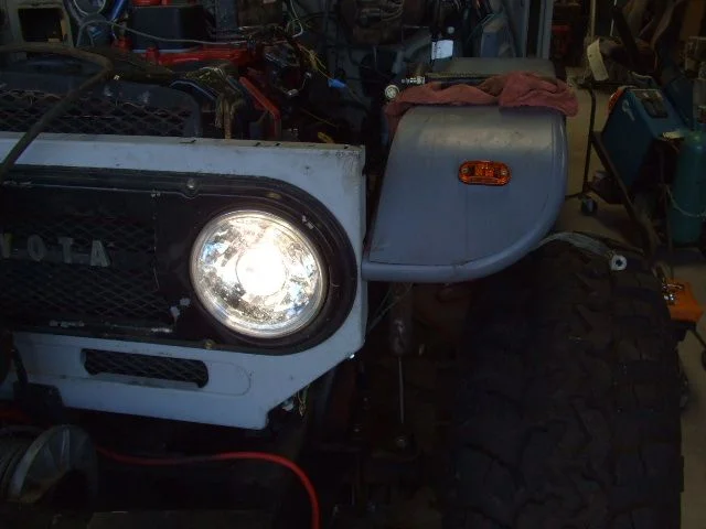

After enough poking from Mudders, I changed the nuts on my U-Bolts to self locks and cut them off.

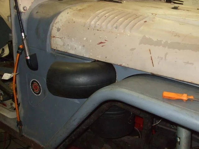

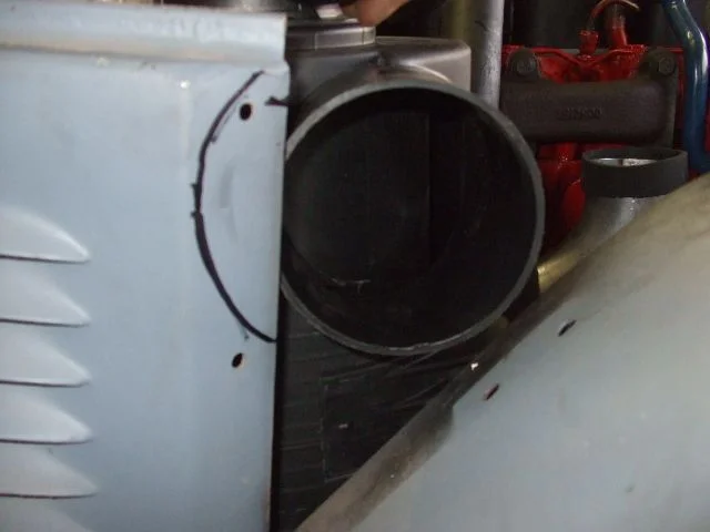

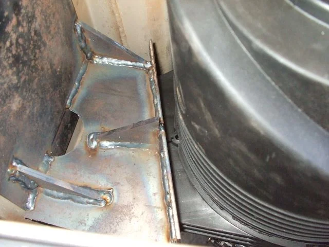

Air Filter
Made a Mock Up of the air filter assy mount.
Looks real close.

So Close to fitting.

Just a suggestion but you should get your gas tank lined
coming along nicely
great work
Quote:

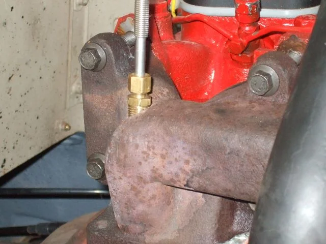

I installed the Pyrometer sensor.

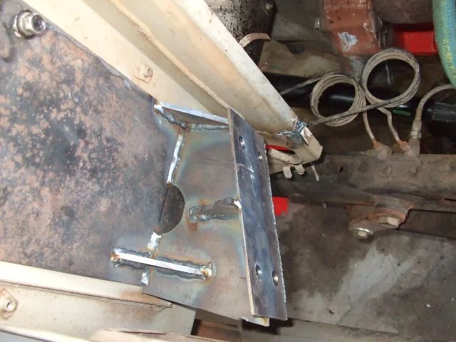

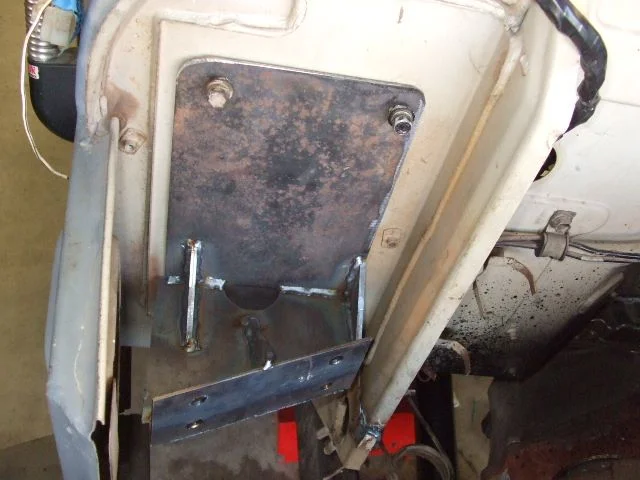

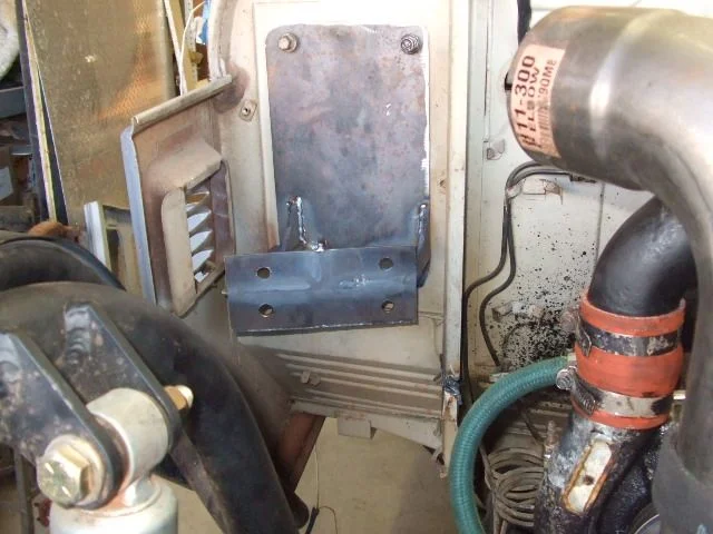

I finished up the Air Filter mount. I'm waiting on the rest of the tubing to finish it up.

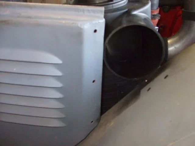

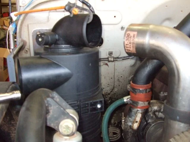

Cold Air intake/Snorkle base is pretty tight to the body.
The bottom picture is take standing almost behind the cab body looking forward.

That's slick man.

I want to live in your garage! lol
