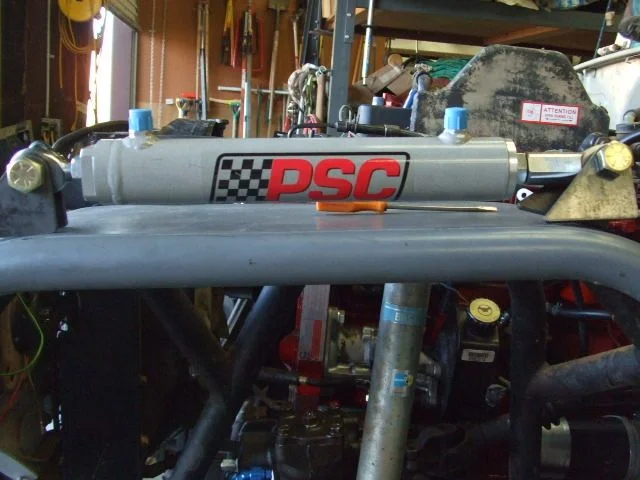

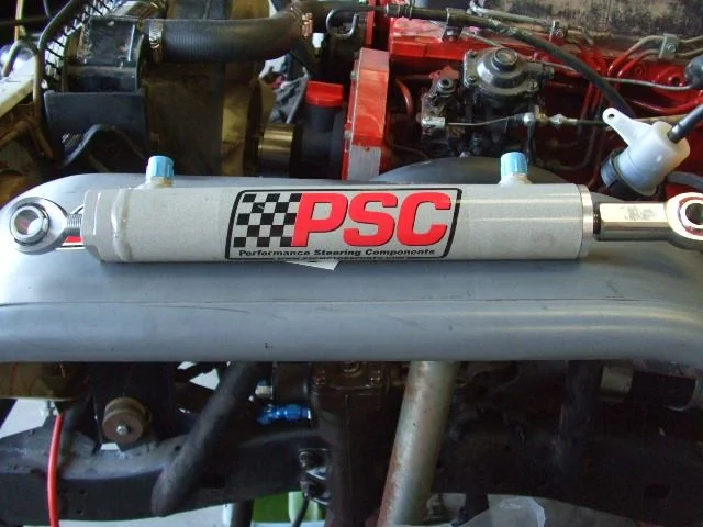

Parts are coming together.
Big Brown Buggy just dropped this off.

The ram I need for this rig is 7 1/8" stroke. PSC installed the 7/8" spacer block in an 8" ram ram. No Charge.
Quote:
Originally Posted by fj40forlife View Post
I need one of does. What size ram is that?
Quote:
Originally Posted by freds40 View Post
What size bore, 1.75?
Yep, 1.75"

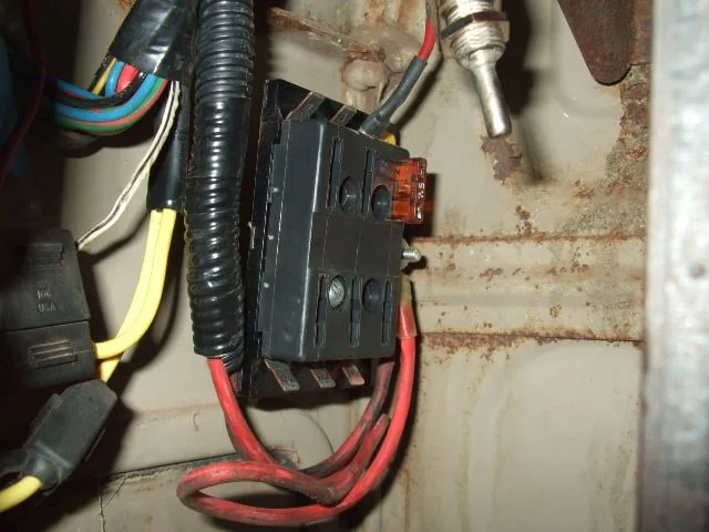

I ran into electrical problems last night. Since I was tired I decided to call it a night.
This morning I am seeing things a little more clearly and I found a few problems.
First Problem Solved
When you install a new fuse block. Don't forget to install the fuses! LOL!

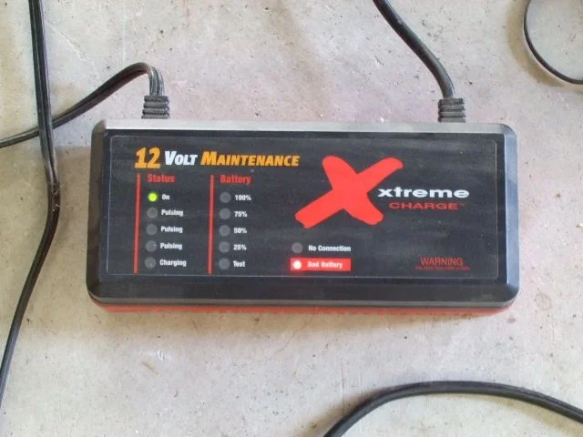

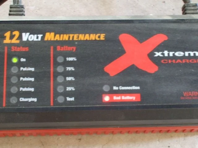

Second Problem Found
Brand New Optima Yellow Top putting out 6.6 volts. Connect the Pulse Charger and found the battery is bad.

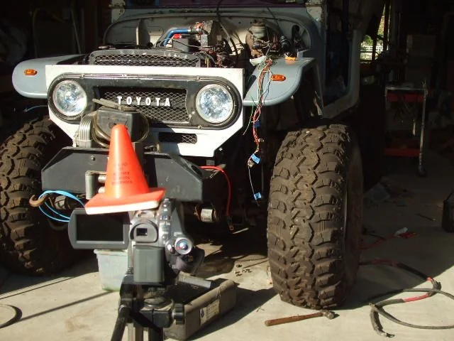

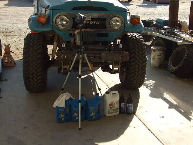

Fluids filled and camera ready for the start up.
I also have a fire extinguisher and a big pair of cable cutters ready.

I thought I need to move on a 8" ram next time .. ( next life )
Are you plan to move it with the stock PS pump ?
Stock as in a Cummins mounting style one hi flow output one designed for a 30' cargo van? Yes.
I checked with the guys at PSC and they said to try it first and if I need it rebiuld to send it to them and they wil modify it and rebuild it.
They did recommend going with one of thier rebuilt/modified ones if I was going full Hydro.
The new 2F pump I used on the previous 2F had no problems.
Hijack .. before buy the " wrangler " pump that I got .. I got the Cummins recomendation .. the only issue with it was the 260 buck that it cost and need to make a pulley .. for my setup ..
Now I'm not sure what's happend in my case .. so not sure If I need to buy a new pump or what ..
I mail back to Kelvin at PSC with no more answer ..
hijack end ..
