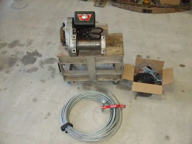

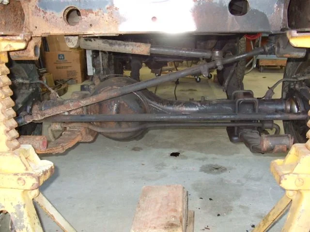

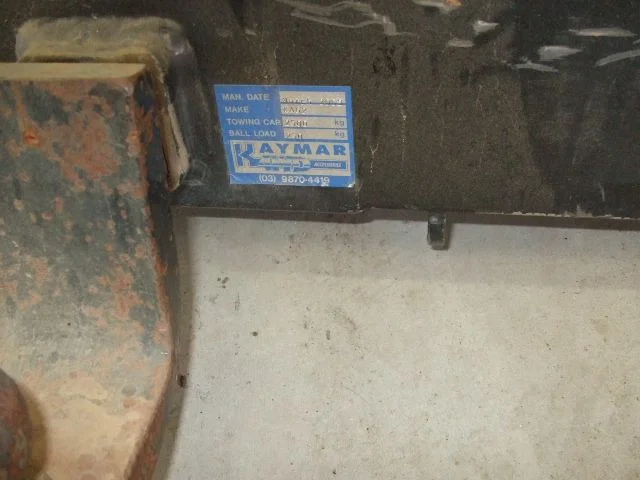

Goodies from Mud Ship!
Big thanks to Fast Eddy for hauling the 8274-50 up to Stockton for me.
I was really happy to see that you did not bolt it to the front of your FJ-40 in order to ship it.
I'm glad that Euclid reconsidered the shipment of the Kaymar Bumper. I'm am now going to bolt it to the back of this rig.

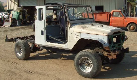

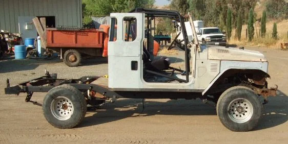

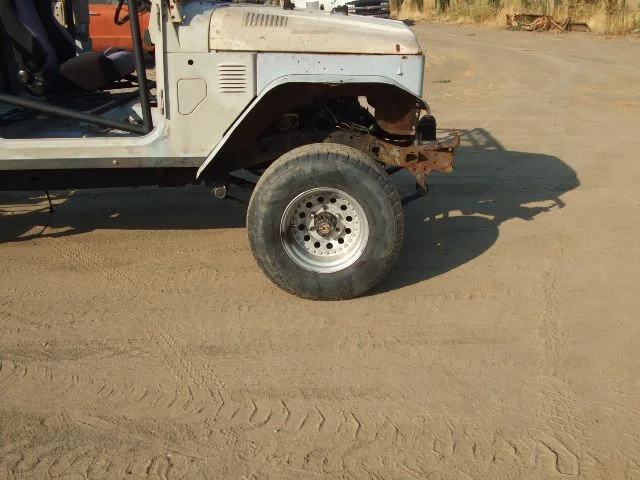

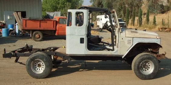

Her is how it looks back at my shop.

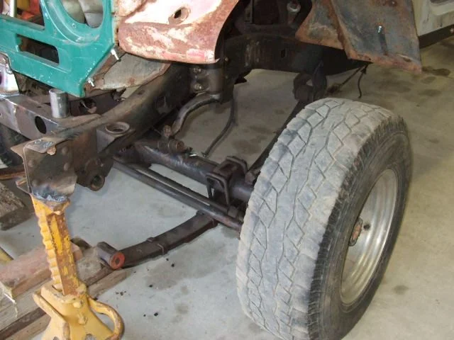

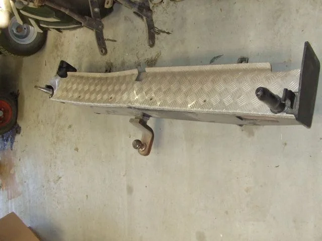

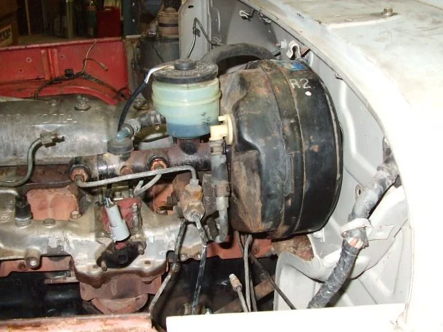

The front end coming apart.

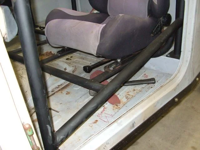

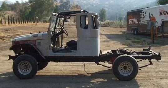

The wife noticed that the seat was hard mounted and she could not reach the pedals.
I mounted the seat and seat adjuster.

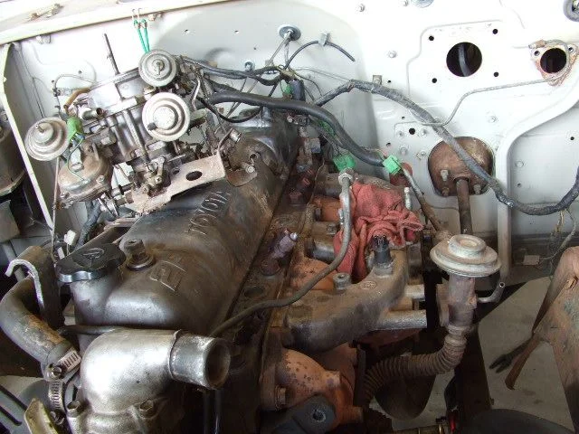

I have began the Desmog!

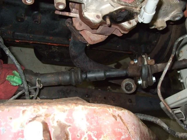

I fabricated and installed the steering shaft.

The FJ 60 Brake booster is installed and hooked up. It was almost a direct bolt on. You have to elongate the top of the main center hole.
I ran the lines and connected them.

Kaymar is installed in the rear.
You can also see the mock up for the 20gallon fuel tank. It is right behind the cab between the frame rails.

This is the way it stands with the front springs installed with new bushings etc.
The windshield is just sitting on there with only the knob screws holding it up.
I will try to get some "driveway" shots today. It was kinda hard moving around before with no steering and no brakes.

A few driveway "poser" shots.

A few more.

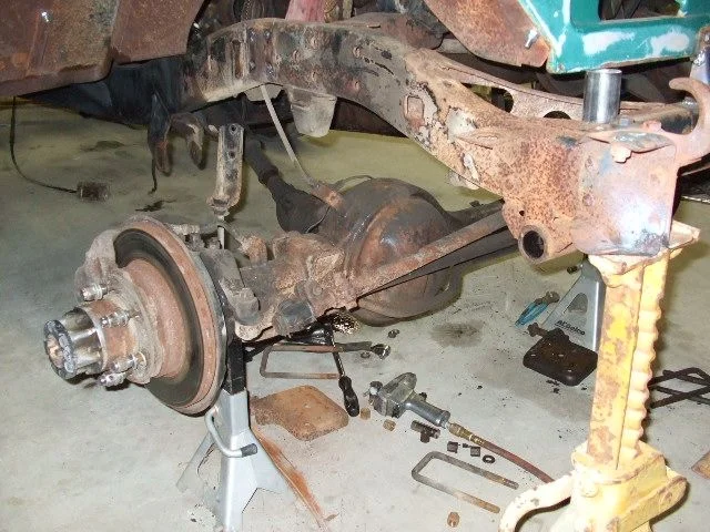

Front Axle orientation after moving it forward 3".
