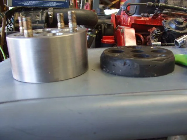

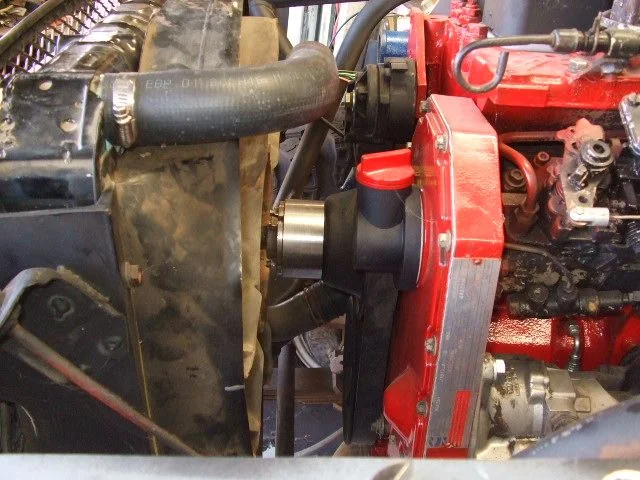

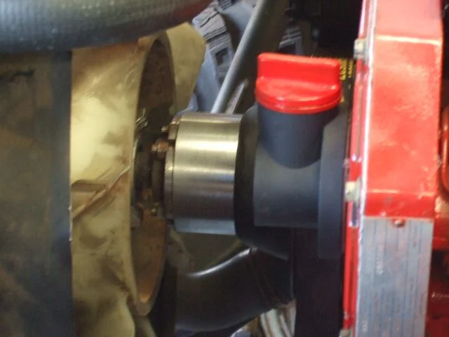

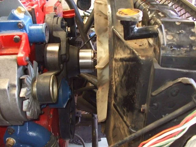

I got the fan clutch hub from the machine shop.
The black one is the old one.

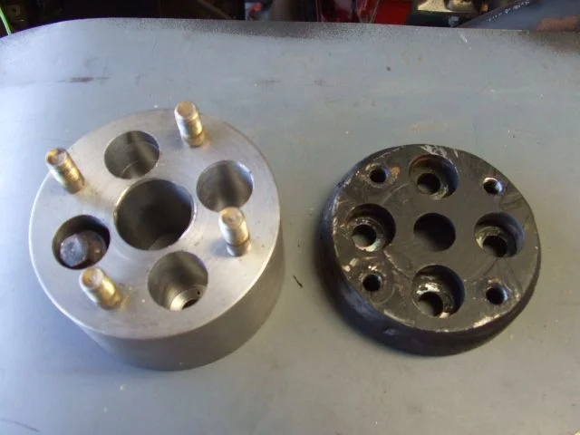

Those of you who have been around FJ60's know the schroud is amgeld or a differnt thickness from the left side to the right side. It is about 1" difference.

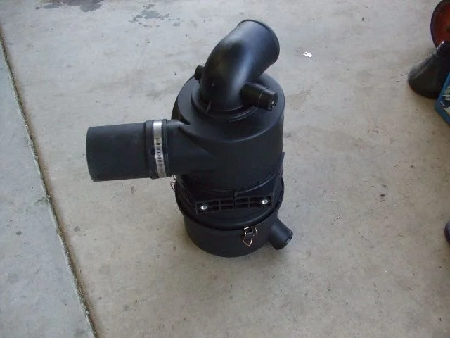

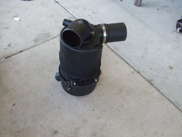

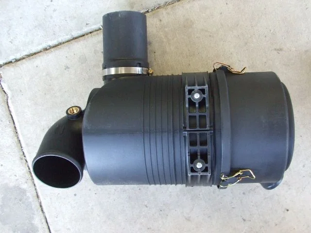

Just a few teaser shots of the beginings of my air filtrations sytem that will include a cold air intake / functional snorkle.

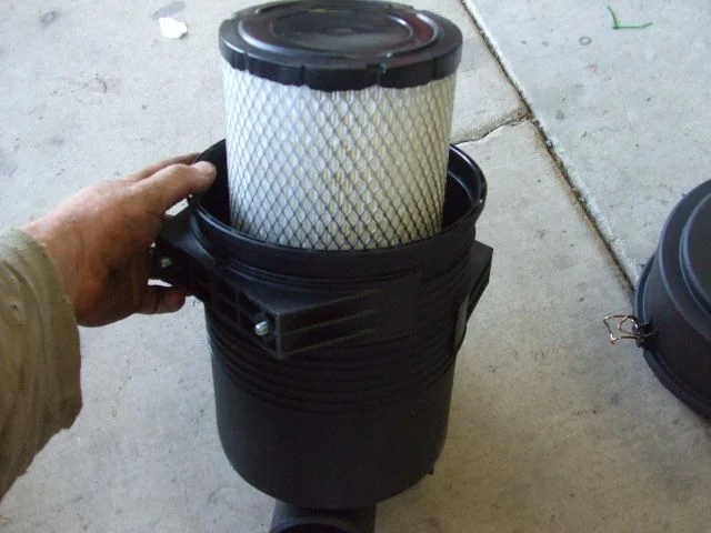

The filter is a large one.

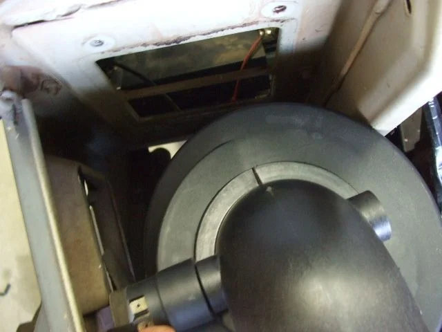

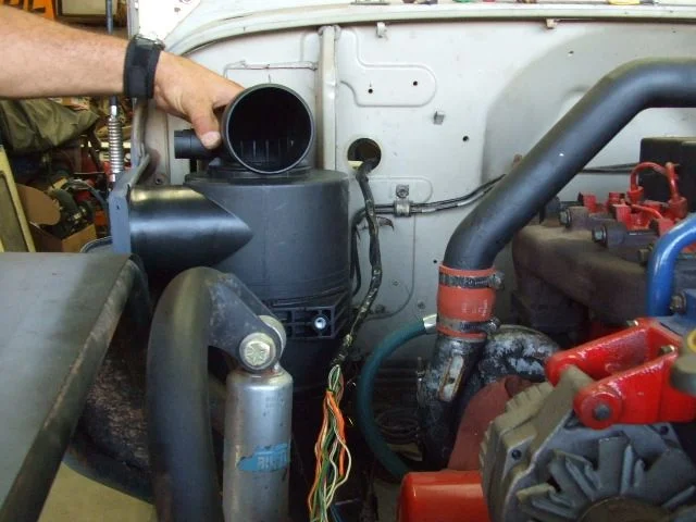

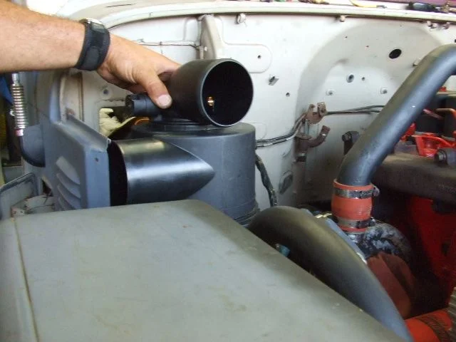

Here is the general area it is fitting into.
A 4" id snorkle tube will follow the windshield A pillar.

Is the other fitting on it as well?

Nope, just the one fitting?
I will go look in the box.

What is that airbox? I don't think I've seen it before.

Donaldson Air Filtration System for a 225hp Skid Steer Loader.
Quote:

Quote:
Had it lying around?

I took my "Possibly would Fit" measurements and stopped by a few tractor salvage yards over the last few months. I ended up at a New Holland Dealership with a tape measure.
Brand new the assy was $130.
It has 4" intake and 4" discharge.
__________________
